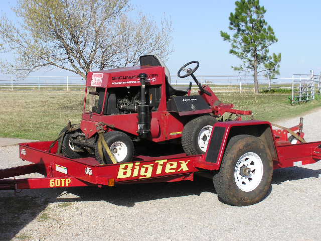

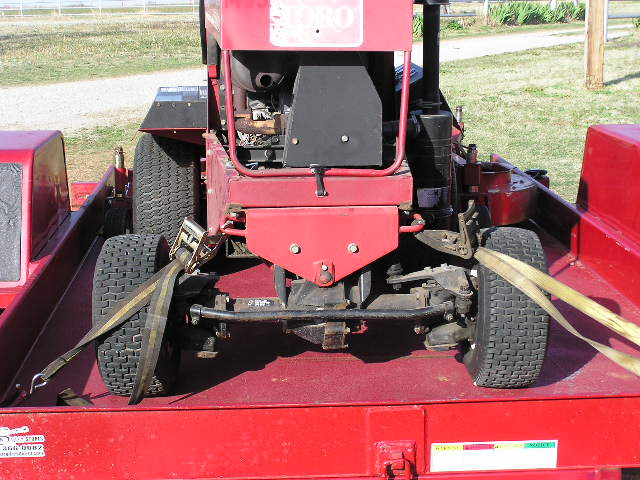

You definitely need 4WD. I mowed a darn dam with this one, no problem. Same darn dam that I rolled a Wheel Horse rider on.
TORO 72" 4WD

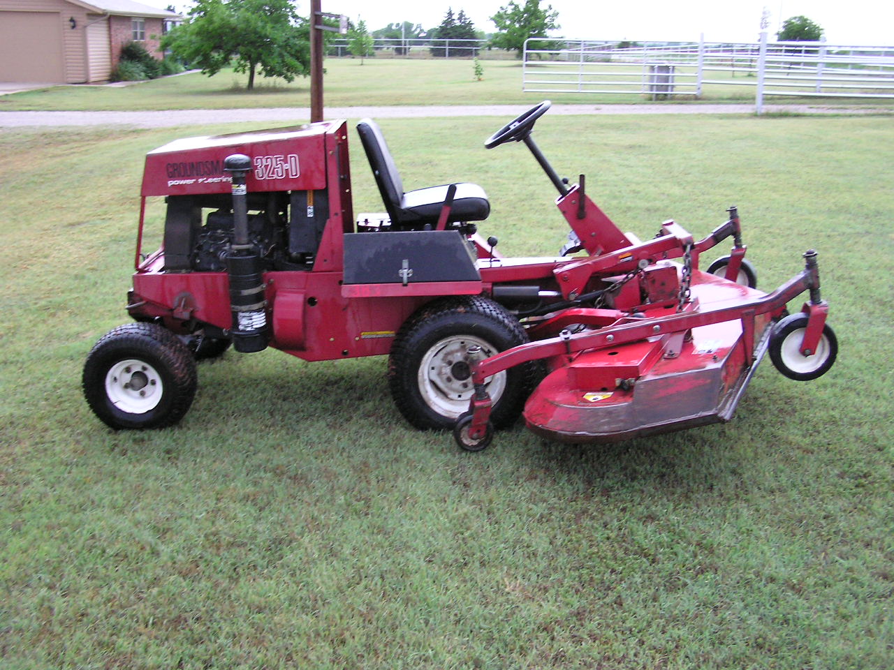

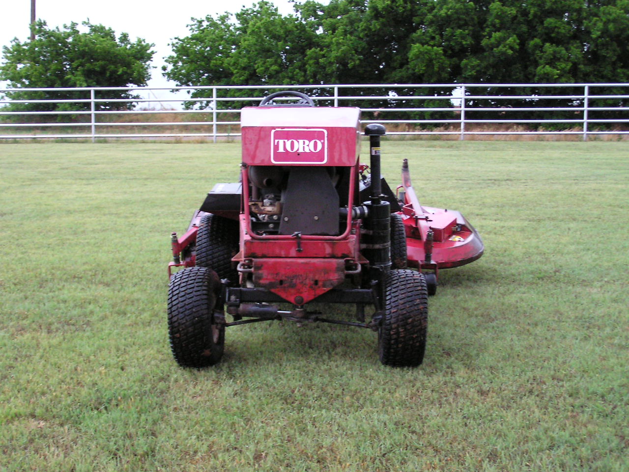

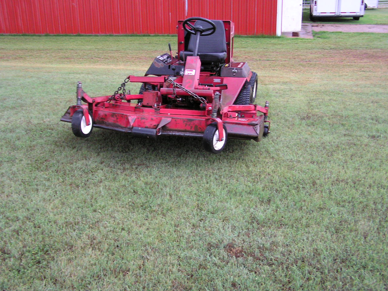

No. The deck is light compared to the diesel motor in the rear. The TORO Groundsmaster is the same basic design as the Kubota F series. TORO has been making this design for about 43 years, so it is a good machine.
If you are mowing across the hillside with a 2WD, the rear will tend to slide downhill and the uphill wheel will lose traction.
At least that is what this 2WD did.
With the 4WD, it just went along the dam, never spinning a wheel.

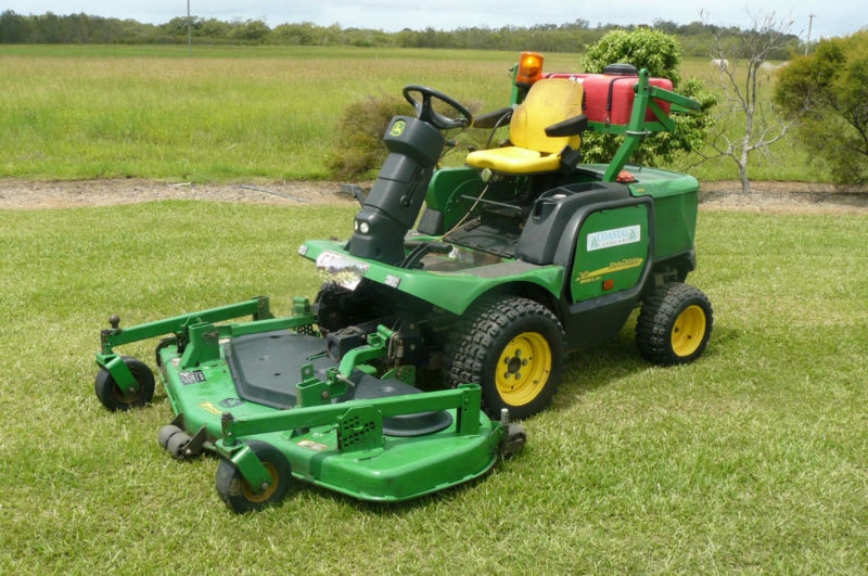

looked for something better but could not find it in that size, however since then I have come across this pic (not mine)
of a John Deere set up for hillside mowing with what look like HDAP tires, don't know if you can get them for a Kubota F.
JDoutfront.jpg I have seen Kubotas with bar treads on the front though.
