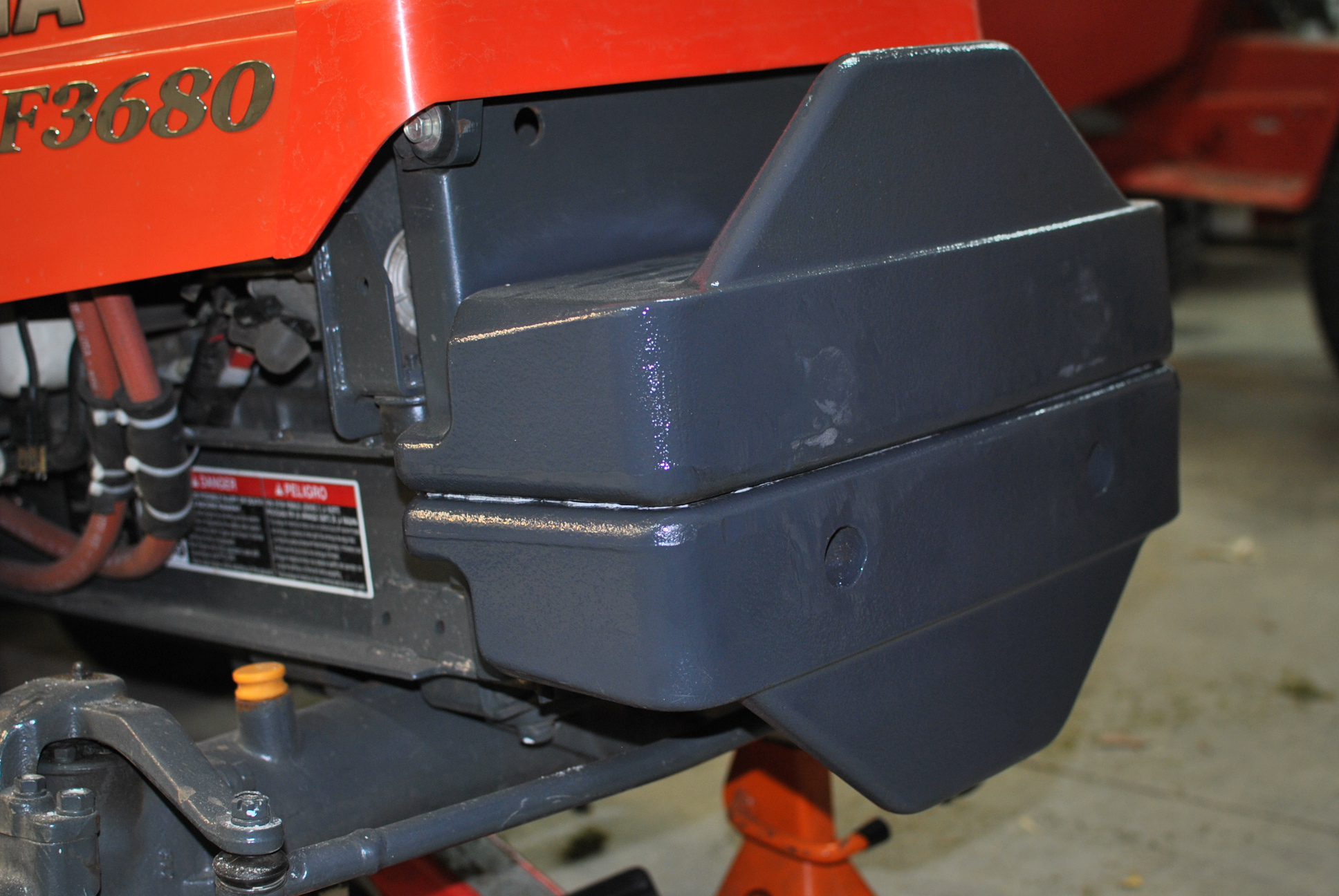

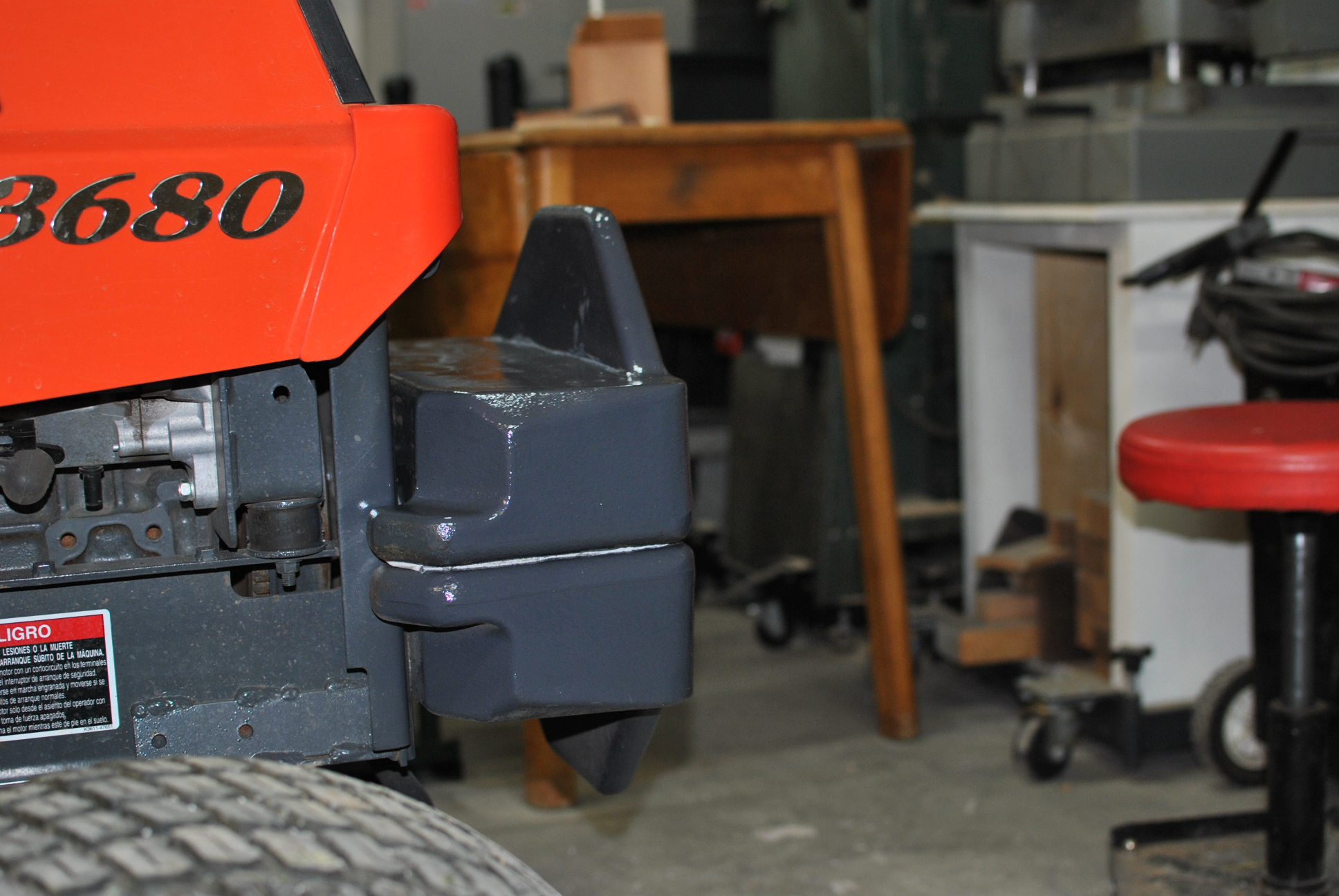

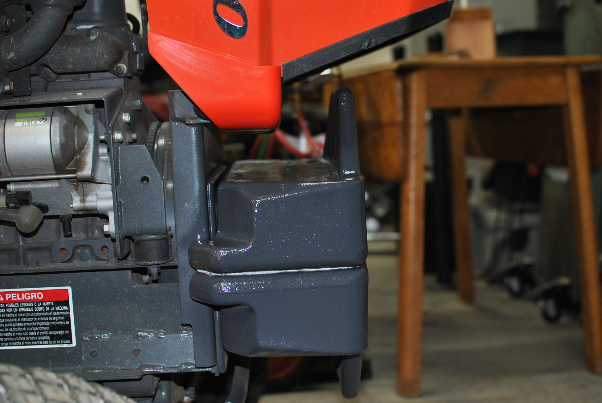

John,
You know, I noticed the same thing when I checked out the Kubota website. I was looking at the new F3990. There were a few interesting driver console additions and a bit more on the exhaust after-treatment but like you John, I also noticed the new (standard (?) suite-case weight assembly sticking way out the back end. That's exactly how mine was equipped when I got the F3680 from my dealer and I never liked it. My dealer delivered mine with a new 57” snow blower on the front end so I thought that they would have installed more weight at the rear to offset the added weight of the blower.
Each (4) weight weighs 55 Lb plus the weight of the mounting bracket and bolts for a total of about 230 Lbs. When you deduct the existing cast-iron weight, which weighs 106 Lbs according to Kubota, the net difference is only 124Lbs. Some folks might not mind the added 12” of steel hanging 12” off of the end of the frame, but I didn’t like this installation at all, just does not look right. And, I kept hitting trees (next may have been the corner of the house or shed).
So for mowing season, I took off the suite-case weights and reinstalled the Kubota standard one-piece counterweight, which I think looks better anyway. It is contoured to the tractor and only sticks out 8”.
I was thinking that I would have to re-install the suite-case for winter, especially now that I have a cab and the majority of its weight looks to be over-slung forward of the front axle, but I still did not like the idea of a big chunk of steel hanging way back there to hit things (I supposed I should learn to driveJ … but was constantly thinking about that chunk last winter and it bothered me).
So anyway I’ll show you what I did, and you’ll recognize the fix right away. I made-up a stronger mounting bracket out of 1//4” plate and welded a heavy lip at the bottom like the standard one only much stronger. I bought a Kubota standard counterweight inverted it and installed upside-down over the existing counterweight. It fits nicely and does not interfere with the hood opening (about 3” clearance). So when blowing snow this winter, I should experience the same swing-out on turns as I have become used to when mowing grass.
