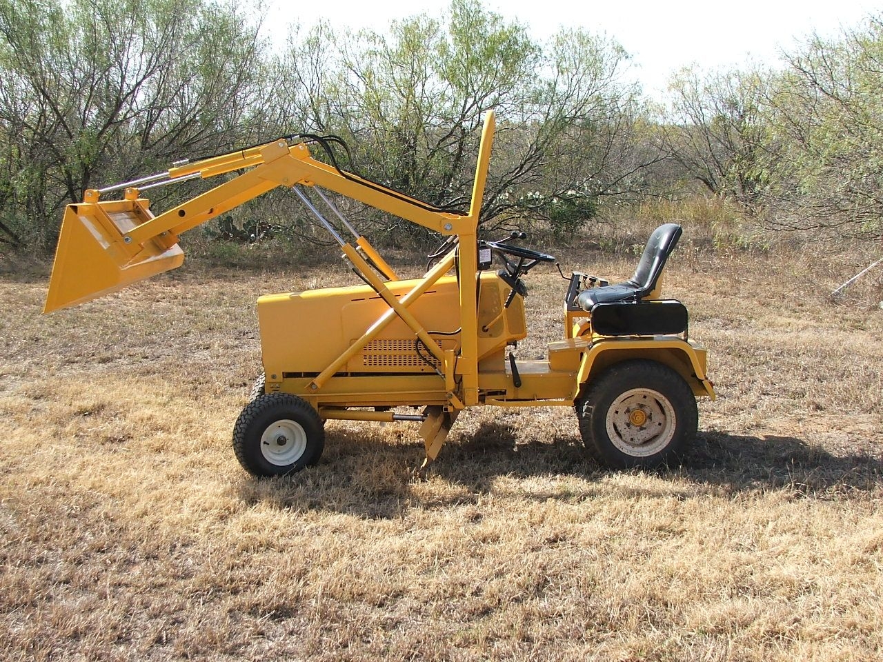

Yep, they don't stop on their own.
I have the same engine in my Kenbota. It started life as a G3200 lawnmower with 1300+ hours. It's still running strong. The only thing I did was clean it, paint it and changed to a "real" alternator. It's no longer a lawnmower. ;)
