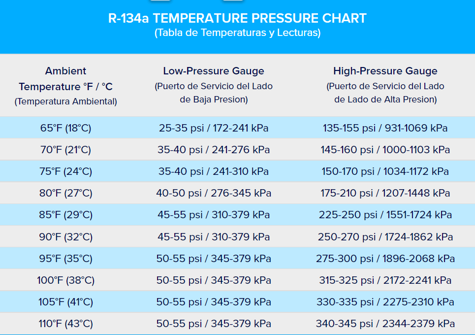

Dad has Kubota with cab. A/C runs for a while then stops working. Anyone know the pressure gauges should read when connected? Thanks

I guessed your tractor AC uses 134A refrigerant. As you can determine from chart below ambient temperature affects correct charge pressures. Be sure radiator, condenser & cab filter are free of foreign material that will block good air flow. I also recommend installing manual heater hose coolant cut-off valve if one isn't already installed.

Over filling AC system with 134A is more detrimental(lowers cold air output) more than on older type systems using R12
   / Kubota Cab 3430 / A/C /pressures for A/C #6
You can also ruin a compressor.
   / Kubota Cab 3430 / A/C /pressures for A/C #7
As well as destroy the system from over pressure. The pertinent shop manual will state the correct charge applicable to the system and... your local dealer will know, try asking them.
Winging it can and will destroy the system.

I've also heard a bad metering device will cause poor cooling.
   / Kubota Cab 3430 / A/C /pressures for A/C #9
Monitoring operating pressures should determine if expansion valve is faulty
   / Kubota Cab 3430 / A/C /pressures for A/C #10
Monitoring operating pressures should determine if expansion valve is faulty.
