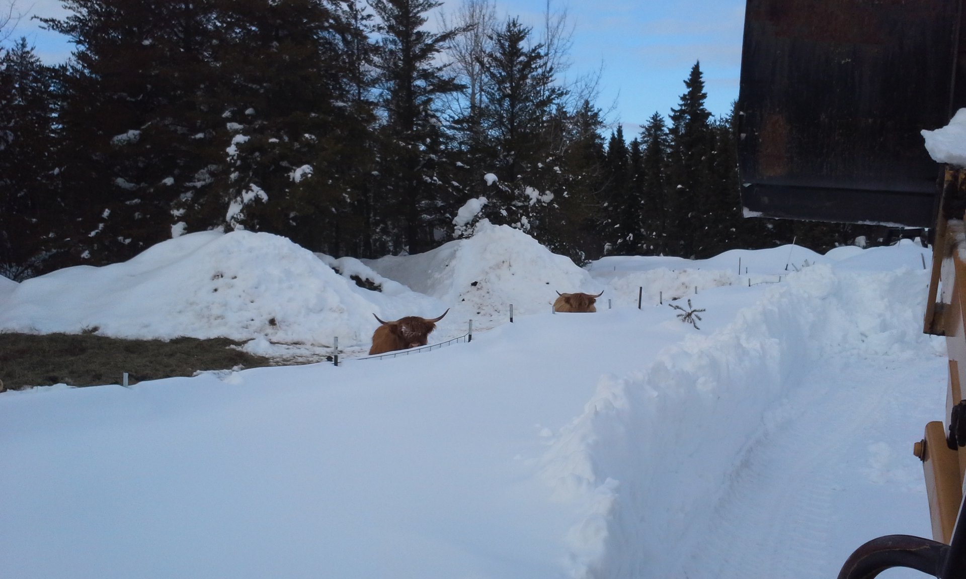

Where I live, in the UP of Michigan, our winters are brutal. We get lots of snow and sometimes extended periods of cold. It's not unheard of for us to have 30+ days continuously below 0 deg F temps. This year, I need this little Kubota to be reliable as I have a a few critters here who are dependent on me for their life. I have to plow a 1/4 mile two track road, keep the cattle area clear, and blow snow to a small pond where I can auger a hole through ice and pump 300 gal of water to their trough. I have other heavy equipment, but this little Kubota comes in handy for certain things.
