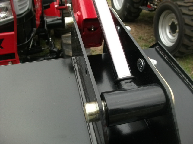

Correct on the non rigid hydraulic lines. On the Max25 the bucket brackets do not have a bushing on one side. Just my observations because I look at this interface all the time.
Here is a pic from my research mission. The brackets are 3/16" material vs. the standard 1/4". By no means am I condemning the Max series, only pointing out differences I have noted and feel compelled to add to this debate. There are no bucket stops either. The machine does have a rather wide stance and a roomy operator platform.

Any zerks on those pins?

Of course there are. Have you seen loader bucket pins without them?
I only could see the one. Just asking. I haven't seen one w/o zerks yet- but I'm sure they are out there. Probably Nortrac

These do not have zerks, the zerks are in the cylinder rod ends and in the loader arm bushing. Massey Ferguson does the same thing with their loader. Kubota does too with the lower pins on the BX series. The middle/upper pin has a zerk. Seems the smaller pins don't have them and the larger pins do, however with the Max they do not although the pins are 1".
