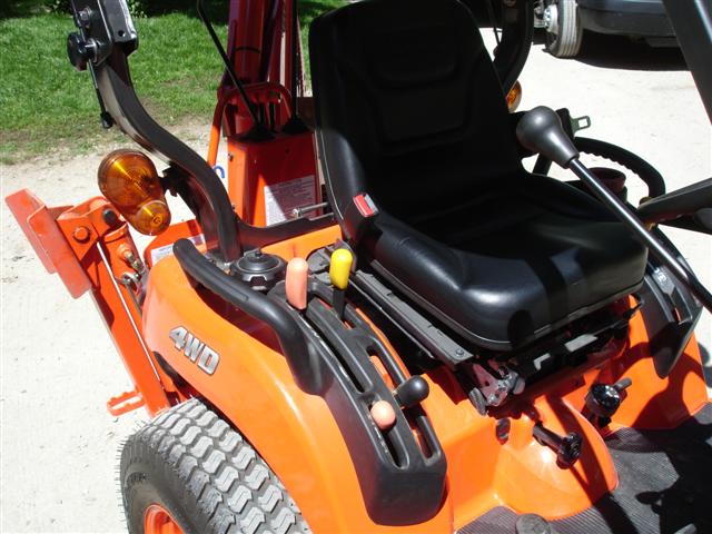

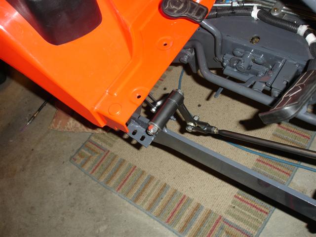

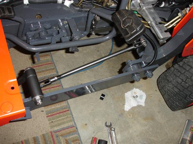

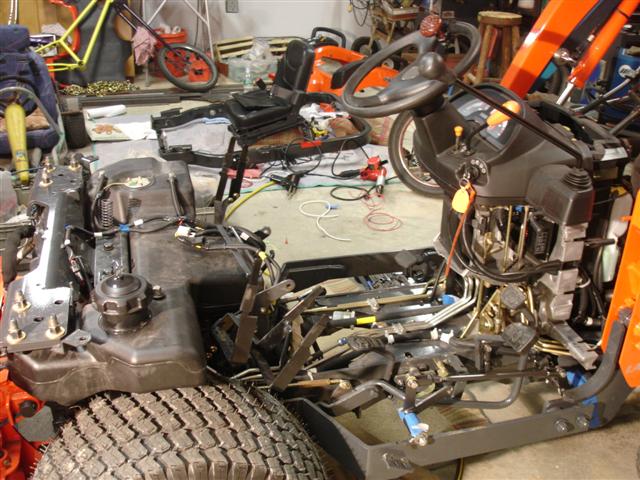

Notes from the Monster Garage; Despite the generous advice of "A light foot", and "Experience will prevail" I've read on various posts, the sudden reverse "slam" that we bx24 owners continually encounter prevails with no factory fix - until now. However, the "fix" is not for the faint of heart.
You'll see in the attached pictures the lever that was installed in the unused starboard slot inboard of the turtle/rabbit lever. It links through two bellcranks directly to the HST pedal - push forward for forward, pull back for reverse. Yes, you can now drive the tractor with the seat facing the backhoe, by simply reaching down with your left hand. It gives me a more accurate "feel" of the transmission.

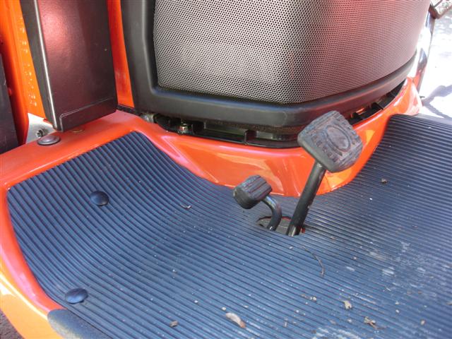

The pictured "left brake pedal" - where it was supposed to be anyhow - (linked to the transverse rod that pivots the factory brake pedal) actually solved the problem - it can be applied by your left foot as you slow in reverse with your right on the HST pedal - just as you'd do in your car or truck. I was able to fit the pedal arm up through the existing brake lock slot, welded a short 1" long arm horizontally to the cheezy lock thing and added a rubber cover to the lock thing (cover from Kubota - you'll recognize it as the differential lock pad). The left brake cover is also factory.
Both in conjunction or separately solve the problem, but were not fabbed to solve the problem - they are just two more things why my friends say I should see a doctor.

Carsce, unfortunately I did not take progress pictures as the linkage was constructed. I will take some close up shots "as built" and post them in the future for you but please heed the following:
1. If the linkage you construct binds due to faulty construction or damage ie; overstress, bad welds, dirt/contamination, incorrect geometry, damage from rocks or sticks jamming the linkage as you drive over them, you will not react in time with the brake, or if you do you may not be able to overide the hst if the throttle is pegged - someone or something will get destroyed.
2. The geometry was a real head scratcher trying to get the throw of the upper lever to match that of the hst pedal within the constraints of the frame/fender/other existing linkage/deck pan/ as well as keeping it tucked up within the side rails underneath so a bash plate could be installed to protect it.
3. In my case, the existing structures I took advantage of to mount the hst linkage as well as the brake arm location disabled the ability to mount a MMM. Not a sacrifice as I will never own one.
4. It took many hours to mock up (see #2) and many hours to fab with a heavy eye regarding failsafe operation - all pivot point components are either brass, stainless or nylon, all shaft pivots have grease fittings (read no corrosion as #1 is gospel).
All of that aside, it is the coolest thing to simply reach down with your right hand to reverse while keeping your foot on the forward hst pedal & left foot on the left brake. As we all know - the bx's brake pedal is way high, and lifting your foot up to the rear hst pedal has always felt awkward. The tractor can also be inched forward or back while standing next to it as long as you place a hand on the seat to activate the interlock switch.
I can provide only pictures, the rest is up to you.

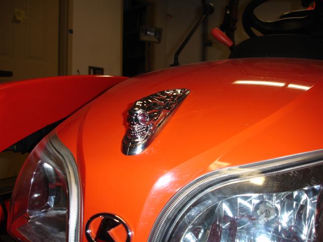

PS: I installed high intensity leds behind the eyes, always on- it is actually a fender ornament for a Harley FLH from JP's mag - ground to match the hood . . .

Dave not knowing whats under my floorboards I can't really see what you changed to solve this problem. Plus the way TBN makes you "remember a pic" then 'back button" to the thread and choose another pic, (sorry TBN I can't remember pics well enough to work like that).
Also the weight of your foot driving into the 'FWD' (as the tractor decelerates) exacerbates the 'reverse slam' problem.

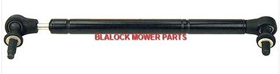

Do you think it's feasible to simply add an oil filled damper to the BX linkage so the reverse can't end so abruptly? Was thinking of something like this. Its about $30
example partnumber or search is "109-2339 Toro Z Master Motion Control Damper"
