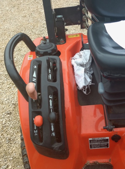

Kubota BX2350. Iseki TX 1410
Hi All
I have just bought a 10 year old BX2350, which the previous owner had just used for grass cutting (middle deck). No manuals, but I have downloaded some. He had a GCD 600 BX grass collector which I have taken off in order to use the 3 point linkage.

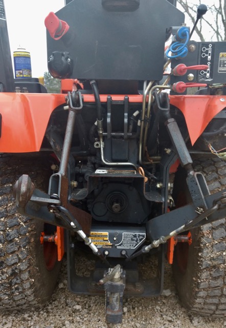

Problem is, I can't lower the hydraulic arms on the back.
There is a lever on the right which raises and lowers the cutter deck ...is there a valve which directs the hydraulic oil to either mid or back hydraulics? How would you normally select which hydraulic arms this lever controls?
There is a control wheel below the seat, pretty much in the midline, which I think may control speed of raising/lowering the hydraulics? I cannot rotate this ...guess it is seized....any suggestions on this?
The rear hydraulic arms are currently in the up position and have probably been this way for a long time.
Thanks in advance for any advice

That knob below the seat needs to be opened!
Yes, that is the Three Point Hitch hydraulic valve. They seize with grass juice and dust. Spray it repeatedly with PB Blaster, Liquid Wrench, WD-40, or some similar solvent over a period of days, they GENTLY wiggle the shaft free with pliers or vice-grips. A blast of compressed air may force solvent into gummed area.
This valve is used to hold the Three Point Hitch in the raised position. When traversing a rough field with a mower or Box Blade attached, this prevents the implement from bouncing up and down, stressing the hydraulic system. It is also used to hold the Three Point Hitch in the raised position so you can load tractor and implements onto a trailer easier.

Yes, that is the Three Point Hitch hydraulic valve. They seize with grass juice and dust. Spray it repeatedly with PB Blaster, Liquid Wrench, or something similar over a period of days, they GENTLY wiggle the shaft free with pliers or vice-grips.

When it is freed however, I still have the problem that the lever on the right controls the hydraulics under the chassis....which lever will control the hydraulics on the back? I guess the one lever can't control both of them, and at the moment this lever is raising and lowering the cutter deck.

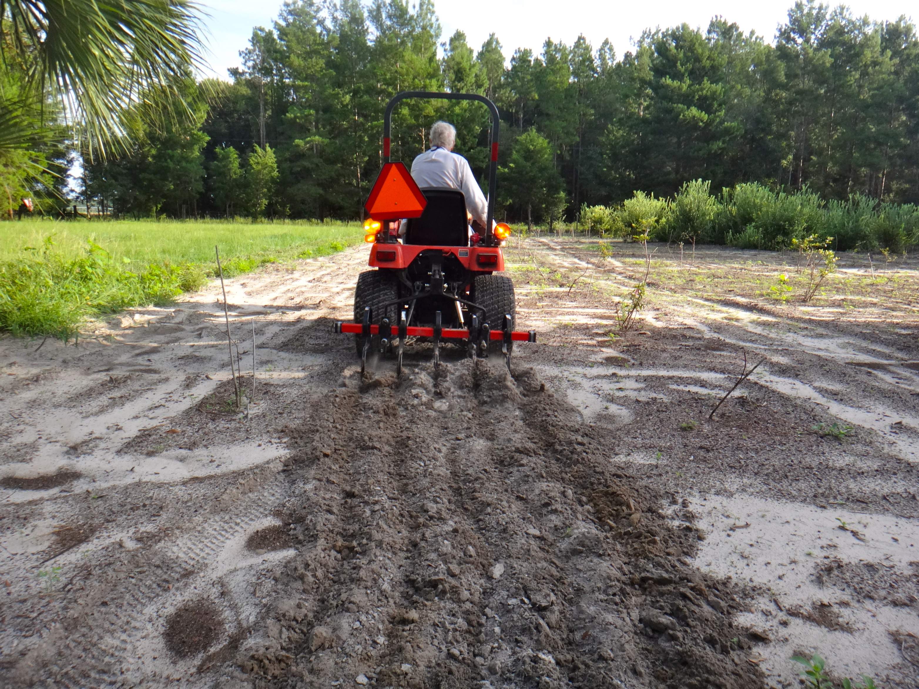

YOUR PHOTO #1: Multiple rear remote hydraulic valves on a little BX. WOW!

Both your mid and 3 point are controlled by the same lever.

As mentioned already, the same lever raises the deck and the 3pt arms. You can lock the deck up, so you can lower and raise the 3pt without the mower moving, by setting the deck height knob under the seat at the floor to "Top". The other knob is the flow rate knob which will control how slowly or quickly it will move depending on how much you close it. If you close it all the way, it won't move at all. It sounds like that is frozen right now, but not in the closed position if the deck is moving up and down - it is not closed.
Sometimes if the flow control is set quite closed (mower deck moves up and down slowly), the 3pt arms will hardly move without something attached, as there is just no weight to pull them down. Try moving your control lever to lower the deck, and put your hand on one of the 3pt arms and press down. See if the arms move down once you put weight on it.
If they still do not move down, make sure they haven't been locked (pinned) in the up position. It's possible the previous owner locked them up if he was just using the deck, and didn't want the arms to move up and down with the deck. To lock the arms in the up position is a different thing - you use a pair of tabs on the frame up by the 3pt arms with a hole in them, and pin the arms up. I'll see if I can find a picture, but if you look back there is should be pretty obvious if the arms are pinned into those tabs.

Thank you all so much for the advice. I soaked the shaft overnight in WD 40 and with a bit of gentle persuasion got the 3 point hitch drop speed knob turning this morning. And yes...the three point hitch now works fine....very pleased.....
The tractor had been left outside for a while and is a bit neglected but I will get it back. Next jobs are to unseize the little black mower wheel shafts, and source one of these wheels...it only came with three. I also need to do some engine maintenance.
