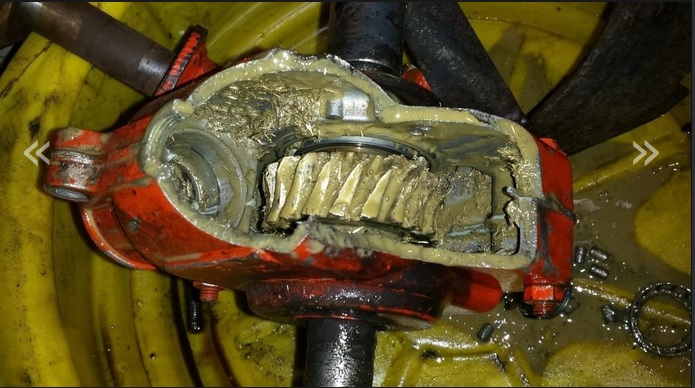

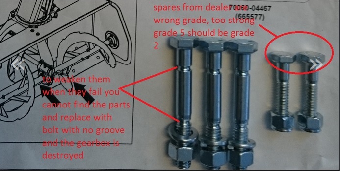

The information I am going to share with you may or may not apply to your particular blower, new or old.
The light weight Kubota blowers, same as the John Deere ones and made by the same company, are about the same as a big walk behind in their design. They need to be treated with respect and not like an industrial unit.
The gearbox in the middle of the two auger halves is vulnerable to failure. Shear bolt design and shear bolt manufacturing have been bouncing around.
There are two shear bolt arrangements. One where the shear bolt goes through the fan shaft and the updated one where there is a flange and the shear bolt is in the flange.
Sometimes the auger shear bolts have grooves machined in them to weaken them and the same design bolt must be used to avoid gearbox damage.
In my photo, the flange is black. This was an upgrade mid season. New designs probably have the flange but it will be orange.
Dave M7040

Thank you Dave
I did not know about the shear bolt design change on the impeller .
Some of the newer models have a 4 blade impeller versus mine which is a 3 blade.
On mine I have broke many auger shear bolts, but only 1 impeller shear bolt in 15 plus years.
