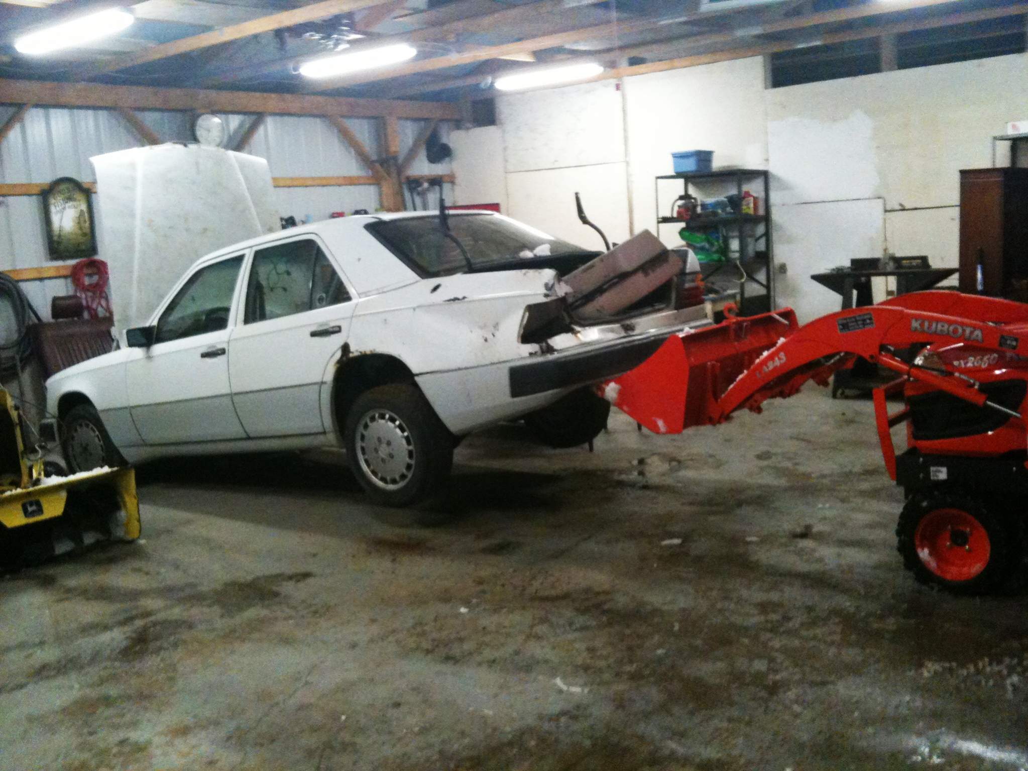

I use the bxpanded pallet forks that attach to the bucket. Its a good system and works well. My only gripe is that since the forks are so far forward of the lift point, this severely limits your capacity. Then again, the one that bolts directly to the pins adds over 100 pounds. So its all a compromise I guess...
I find the lifting capacity of the BX is little anyways, and often wish I had a bigger loader. I was surprised when my BX did this the other nignt...even though it was the "curl" cylinder that took the wheels off the ground...
