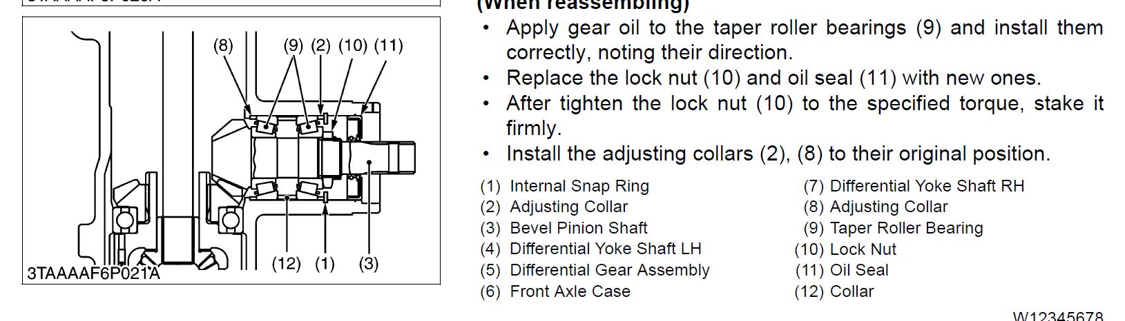

Dec 27, 2017 / Kubota BX front axle pivot bolt leaking oil #11 T tractorbarry Member Joined Apr 20, 2009 Messages 27 Location Ramona ca have you replaced the seals
Dec 27, 2017 / Kubota BX front axle pivot bolt leaking oil #12 T tractorbarry Member Joined Apr 20, 2009 Messages 27 Location Ramona ca
Dec 28, 2017 / Kubota BX front axle pivot bolt leaking oil Thread Starter #13 OP twisted_pair New member Joined Jan 12, 2004 Messages 15 Location Ontario Canada Tractor Kubota BX1500 (2004) Your diagram appears to be the front axle drive input shaft. That's not where my front axle leaks. It's leaking at the center mounting bolt, where the axle pivots on the mounting brackets. Yes, I've changed the seals twice now.
