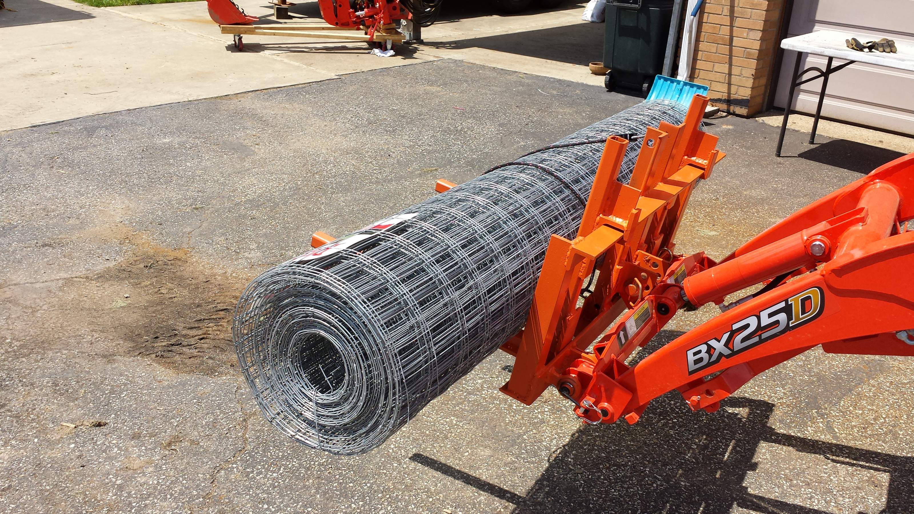

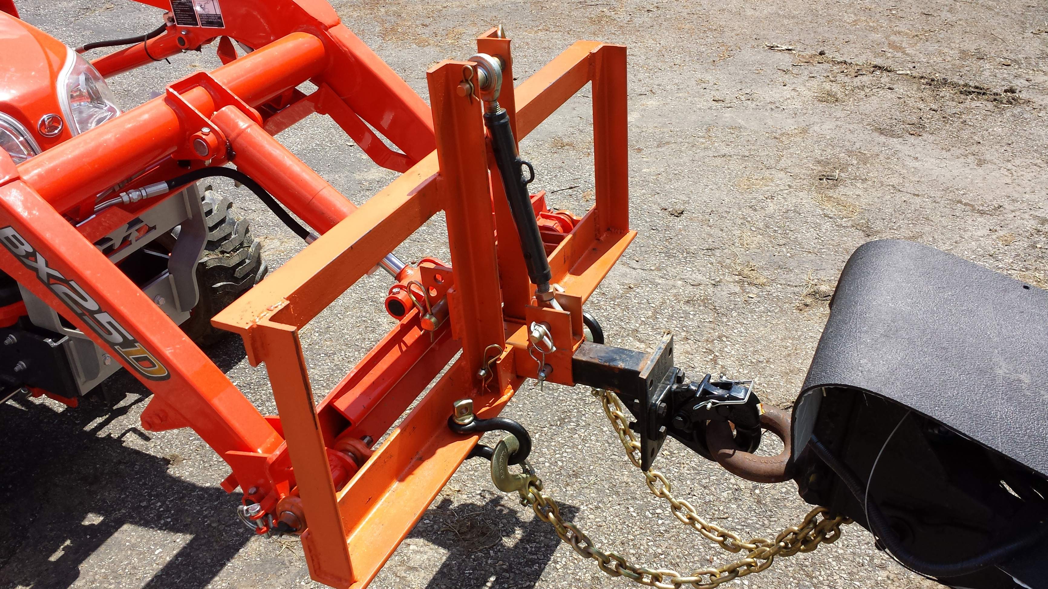

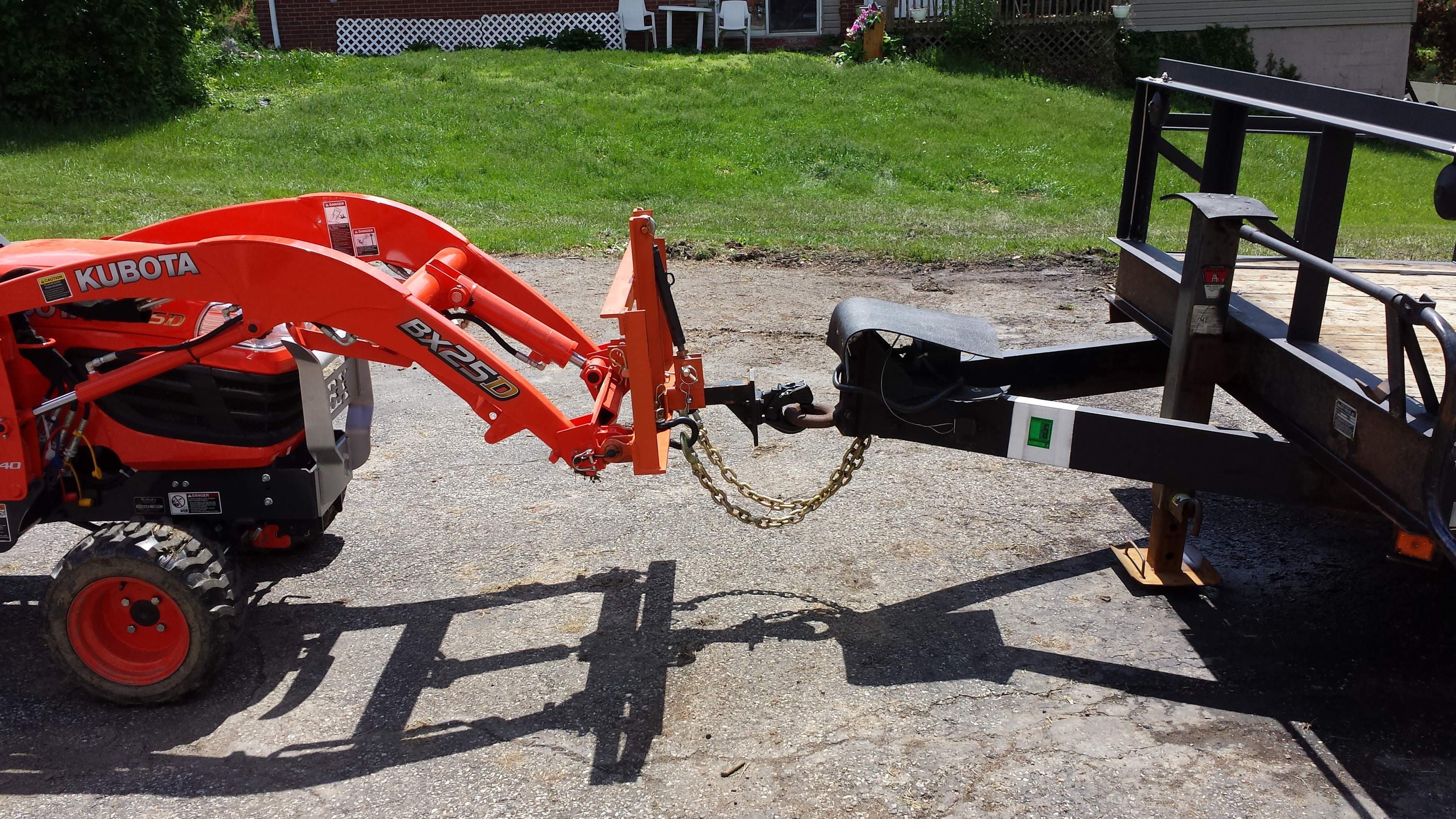

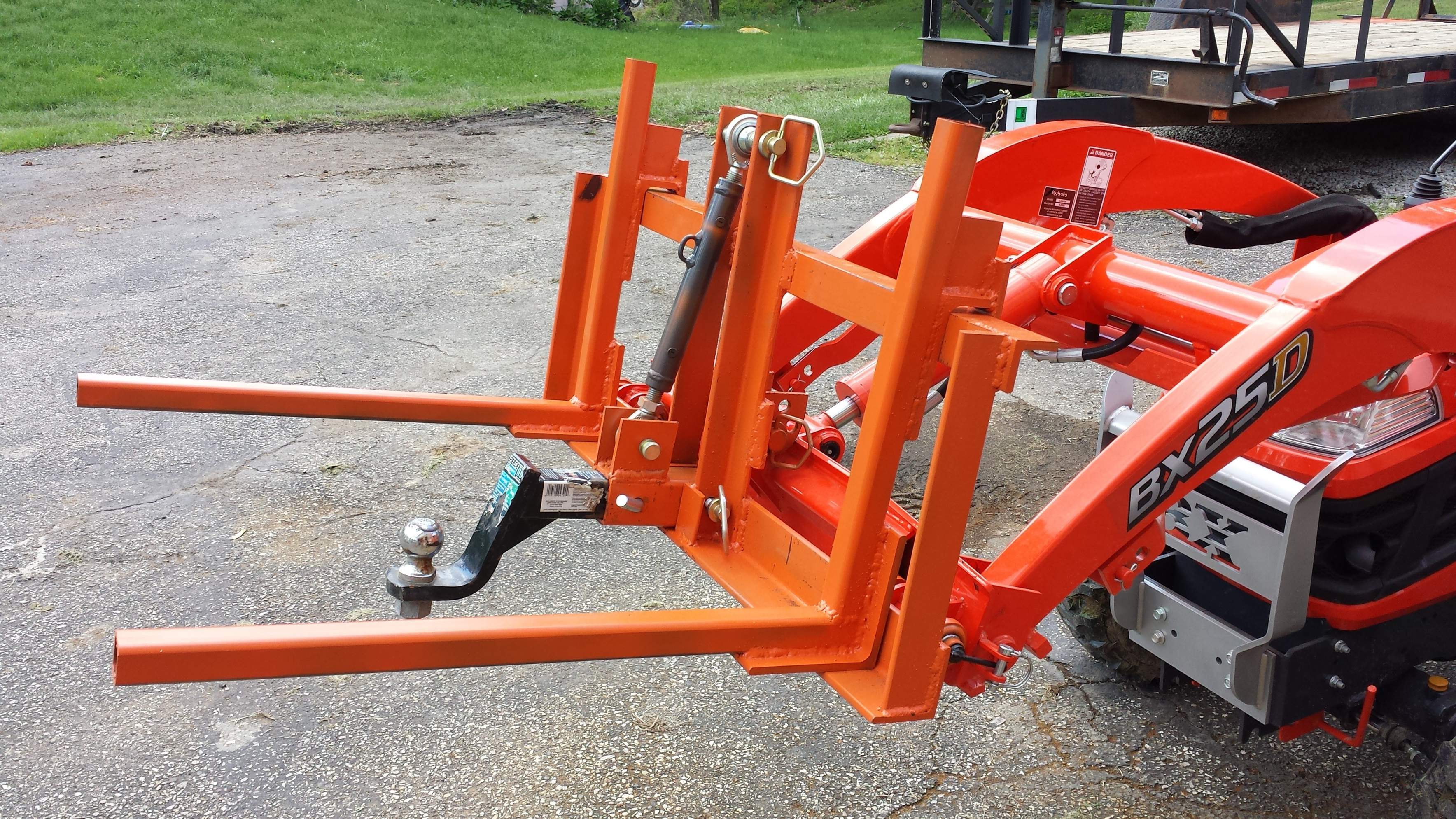

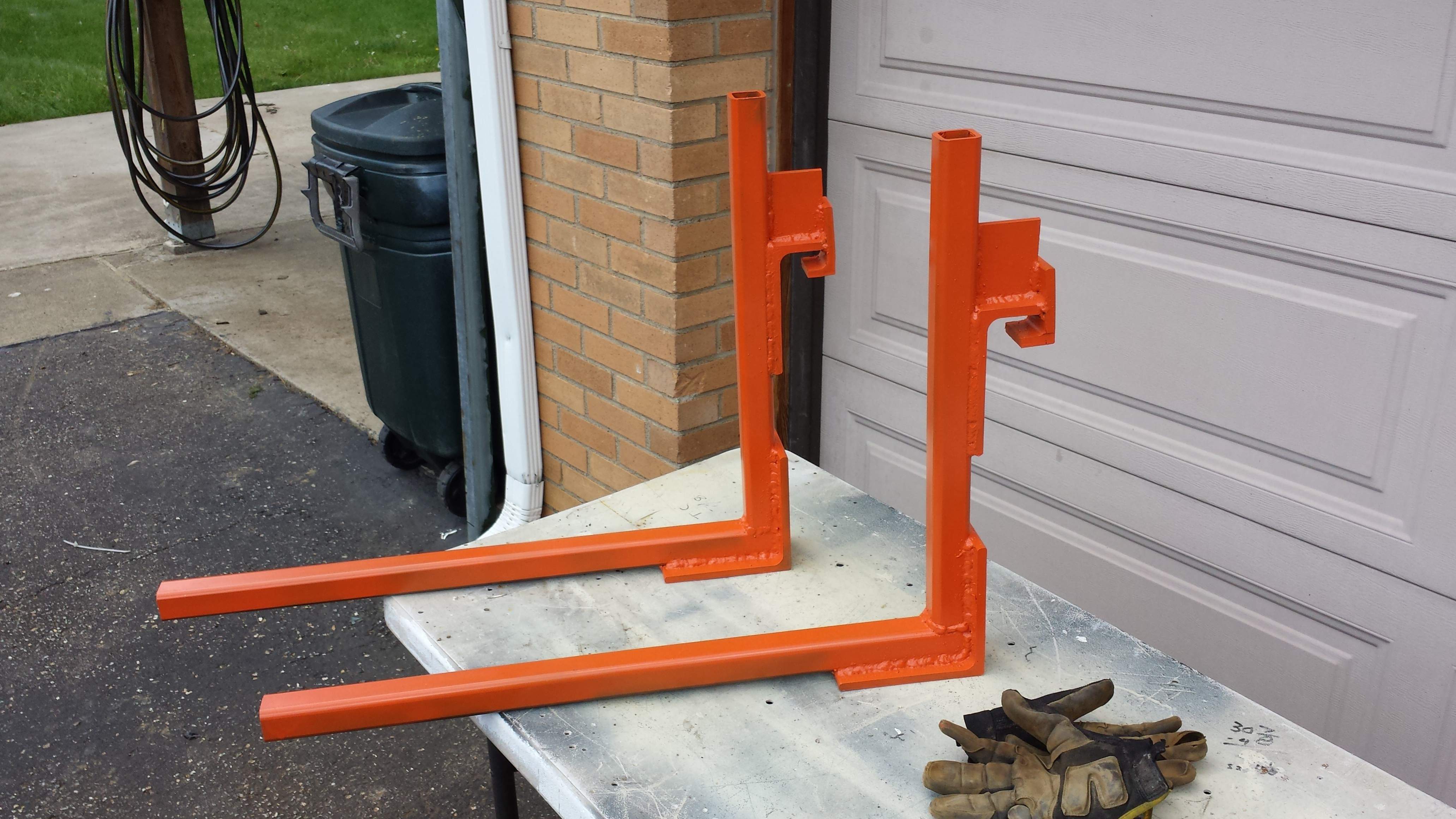

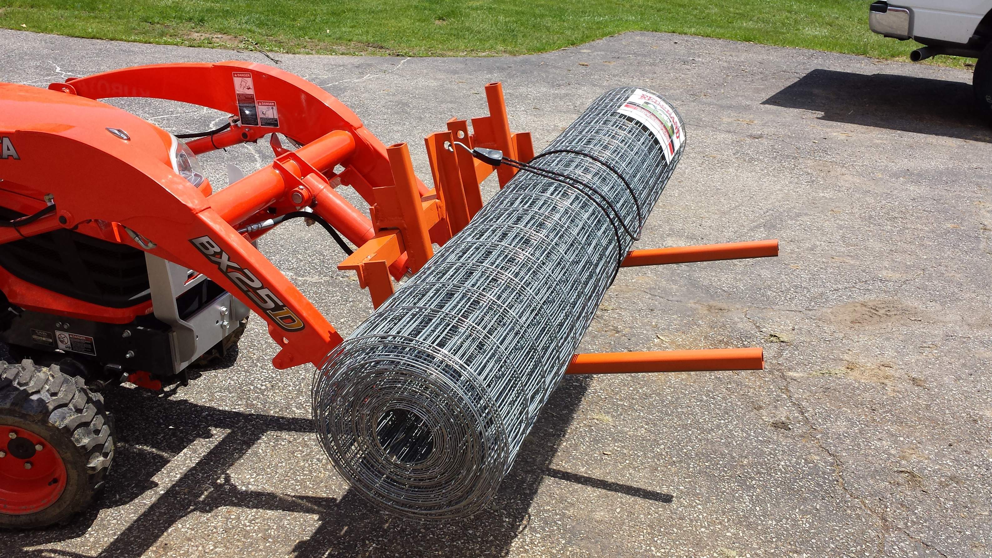

I finally got around to building the Pallet fork hitch combo. Pictures are attached.
The quick attach forks pictured are 30" long which fits the bill for most of my lifting. Longer "brush" forks are under construction.
The hitch is a 2" standard square receiver to take any size ball combo. It is easily removed with hitch pins to allow quick change between fork and hitch mode.
I went with a open frame design to allow easy visibility of the task at hand. It is amazing how much easier it is to move trailers around when facing the right direction and operating a short wheelbase machine.
The Bx tires are loaded and I have a rear ballast box but still only move empty trailers on flat surfaces.

Looks stought!
Might want to put an angle on the front of the forks to make it easier sliding into pallets and such. Plus cap the ends so dirt doesn't get jammed in there.
   / Kubota BX 25D FEL Pallet Forks/Hitch combo
Good idea Zick,
I will cut and plate the ends soon.
Its built mostly out of leftover 3/8 2" angle.
Thanks
