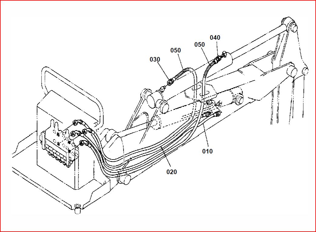

just took my boom cylinder out of my bt751 to replace hoses, now i cant figure which way it goes back in, hoses (fittings) facing up with steel tube up, or hoses (fittings) facing down, towards ground. this is with boom fully extended bucket touching ground. Any input would be greatly apreciated. thanks
   / kubota bt 751 backhoe #2
Do you have this picture from the Kubota parts diagram?
I do, but my cylinder did not match diagram, with no hoses atached i. tried it both ways... fittings down is correct way .thank you for responding.
