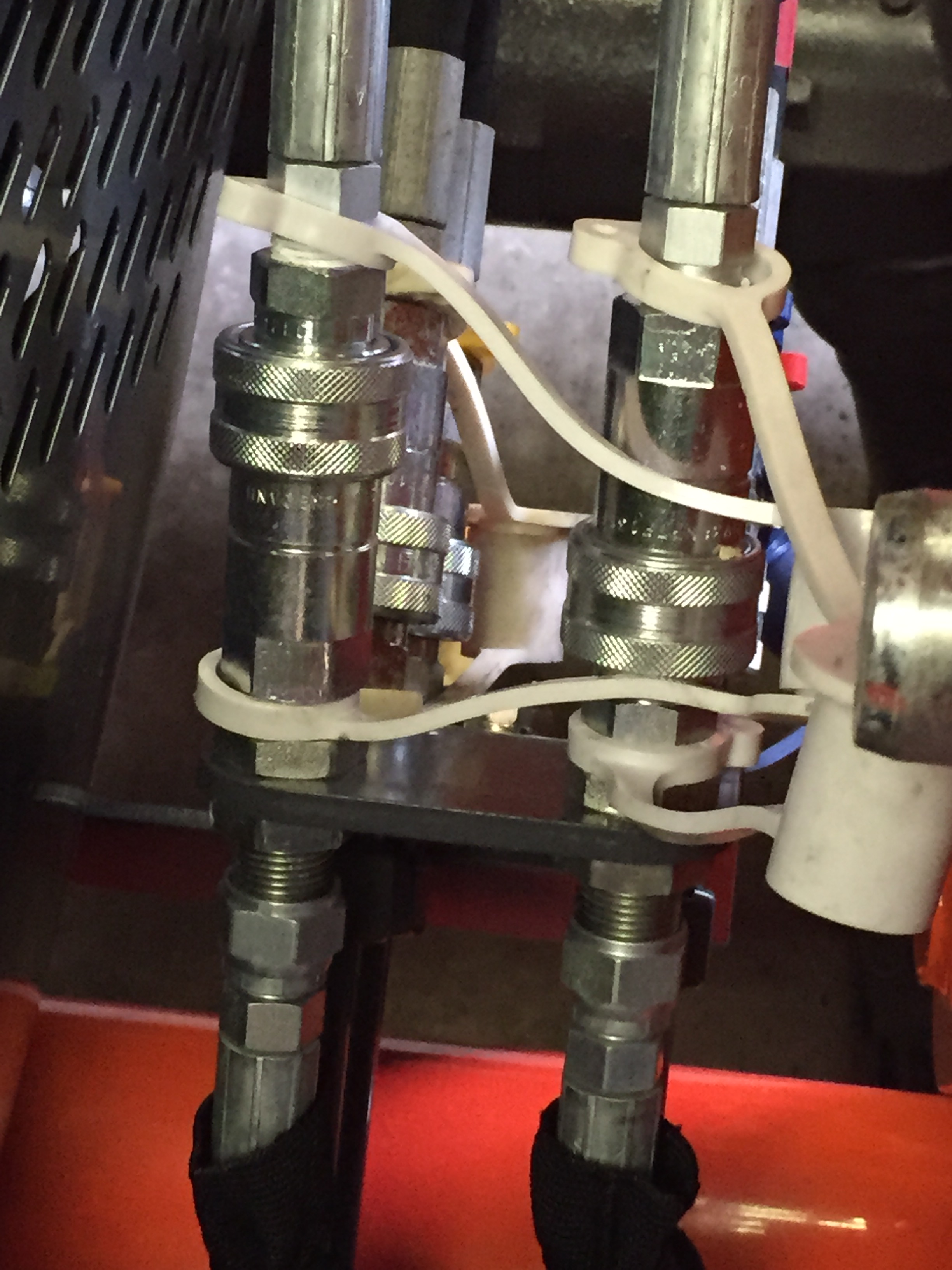

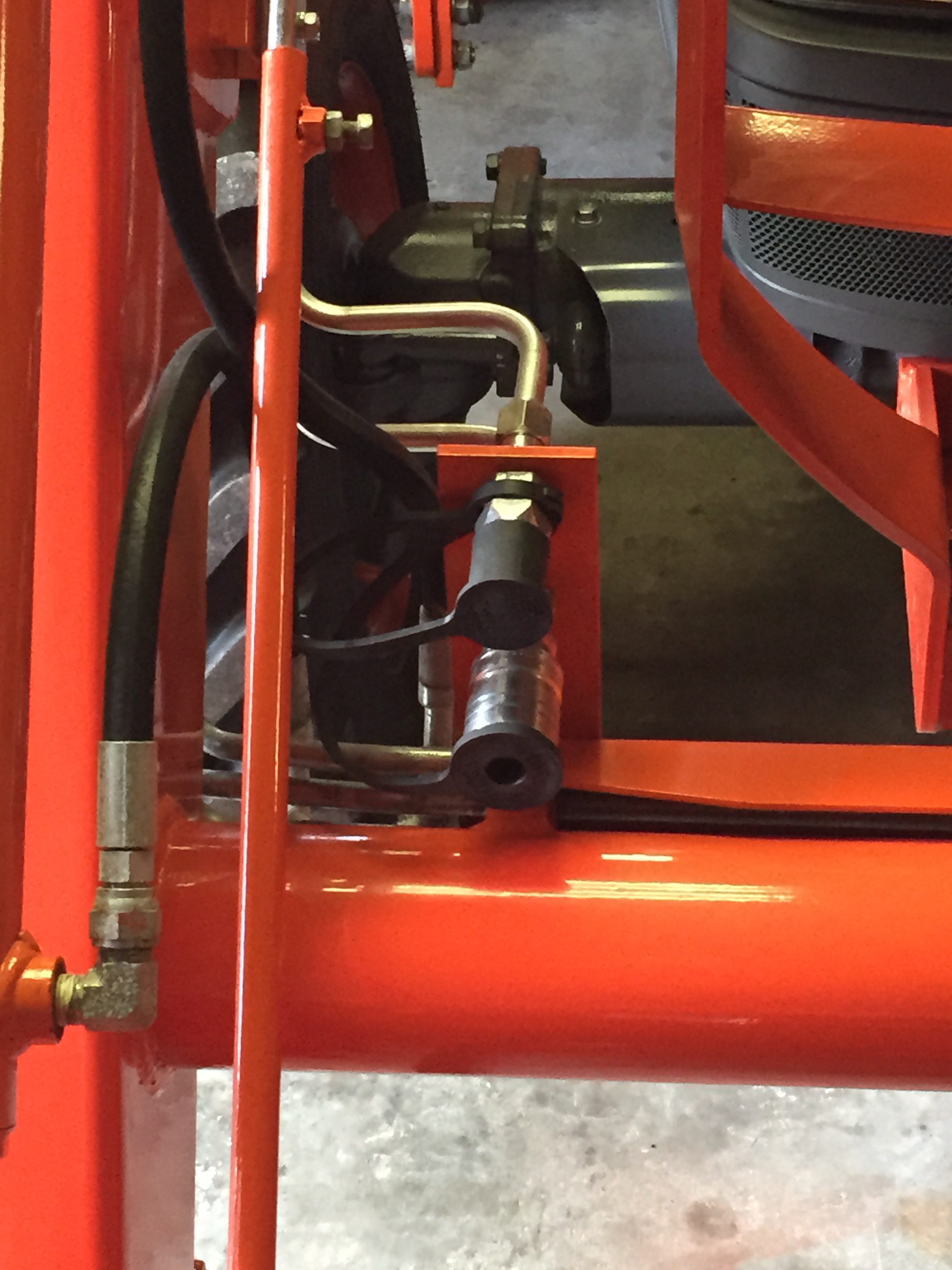

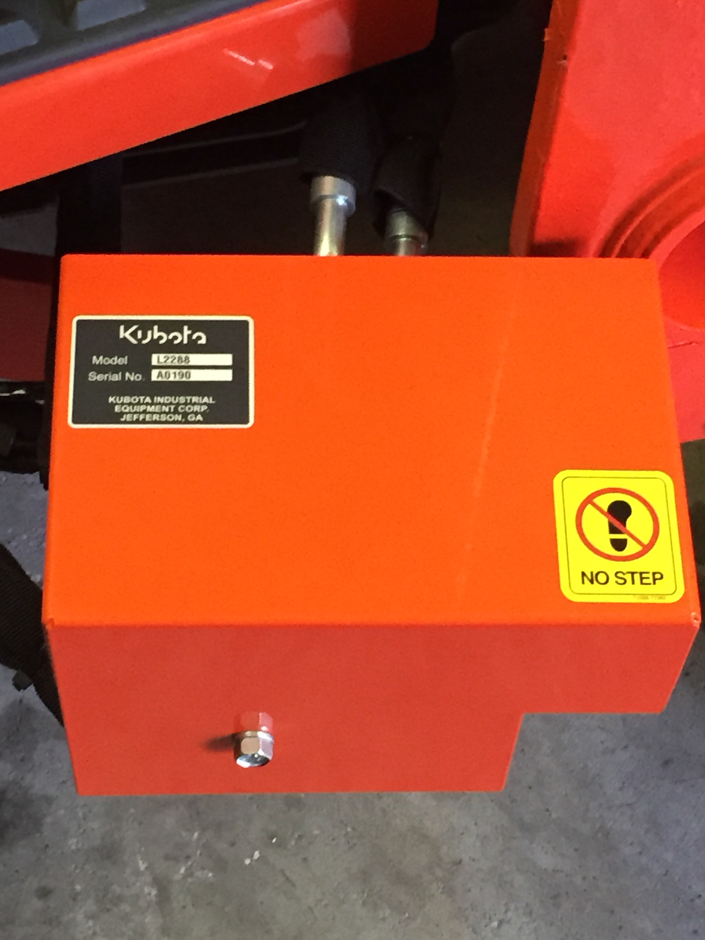

IMG_1970.JPGIMG_1971.JPGIMG_1966.JPGOn my L3540 all the Kubota factory 3rd function lines are steel all the way to the couplers.
