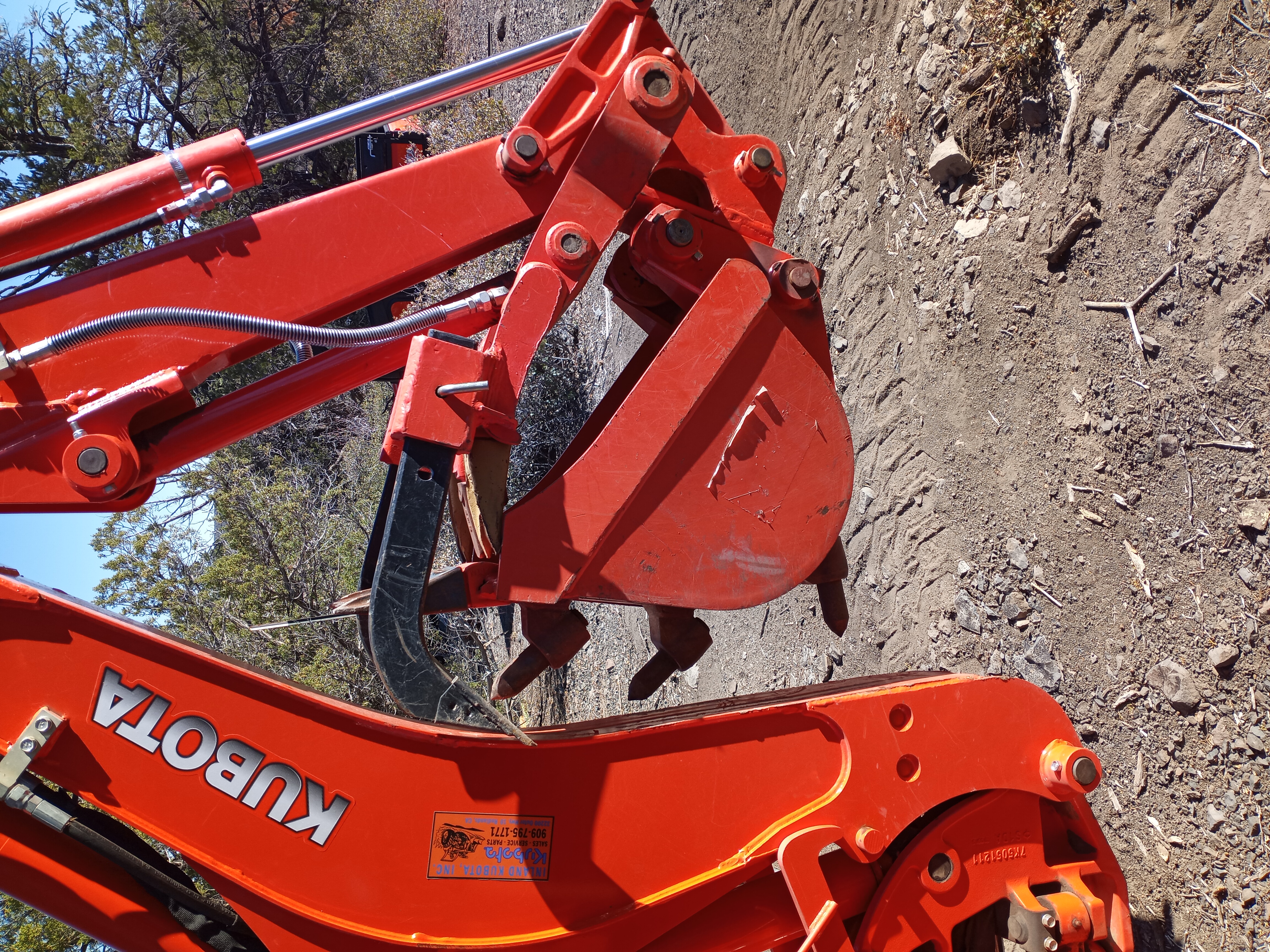

The added Rippers on the Hydo. Thumb makes my backhoe a perfect Grapple for what my uses are now. I can pick up trees and position them to cut up for firewood and I do not have to bend over anymore to do the job. Getting old sucks and proper tools and equipment make life a lot easier.
I used 1/2 inch flat bar to make the sockets for the rippers (material I had on hand) and welded the sockets onto the Thumb with E8018. The thumb being cast steel is harder than mild steel material and I was not sure what to weld it with. I thought E9018 or E11018 would be to hard. All of which I have on hand. Been welding and Fabing. for over 45 years.
The rippers run up the side of the Backhoe Mast with enough space that they do not even come close to and Hydro. Hoses.

My man, never has the term "preaching to the choir" been more appropriate! That's exactly me, and I've been thinking up all sorts of ways how to add to my backhoe to make it more grapple-like. I even got a thread on it milling around here on TBN. I was actually thinking reverse of your setup, ie, leaving the thumb as is, and instead having some sort of claw thingie instead of the bucket, mounting it via quick-attach. I even ordered a quick-attach bracket and a ripper tooth mount (which I was gonna weld a claw on) from a certain vendor, but I wasn't too happy with the quality. But now I think your ripper shanks added to the thumb is a better idea, may have to rethink this!
I notice you got a hydraulic thumb too, I was thinking just mechanical. My method now for picking something off the ground, I position the backhoe so that the thumb makes contact with the ground at around 90 deg, and then curl the bucket to grab the tree limb or whatever. Having the thumb jaw longer and with more curve would definitely help there.

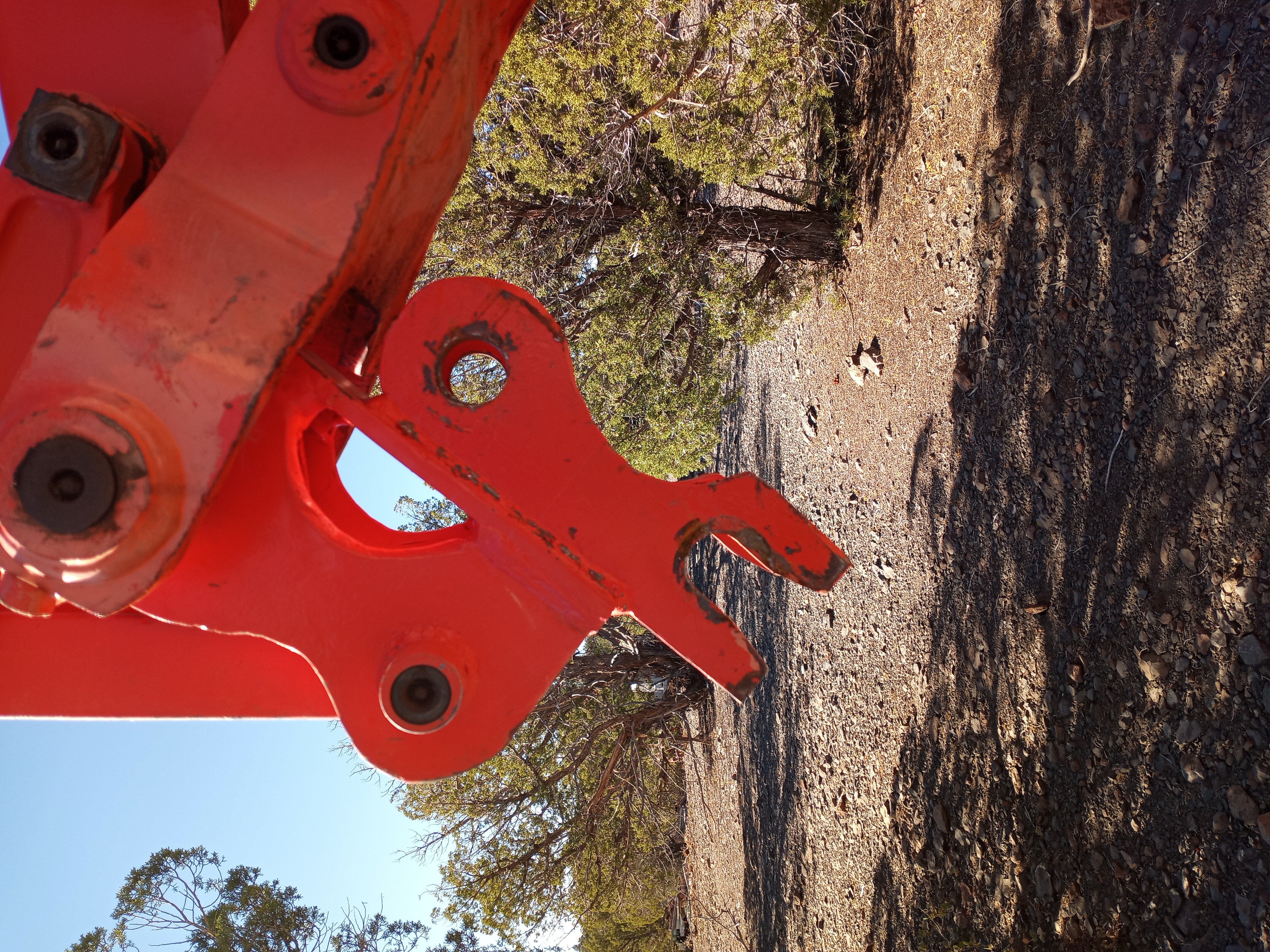

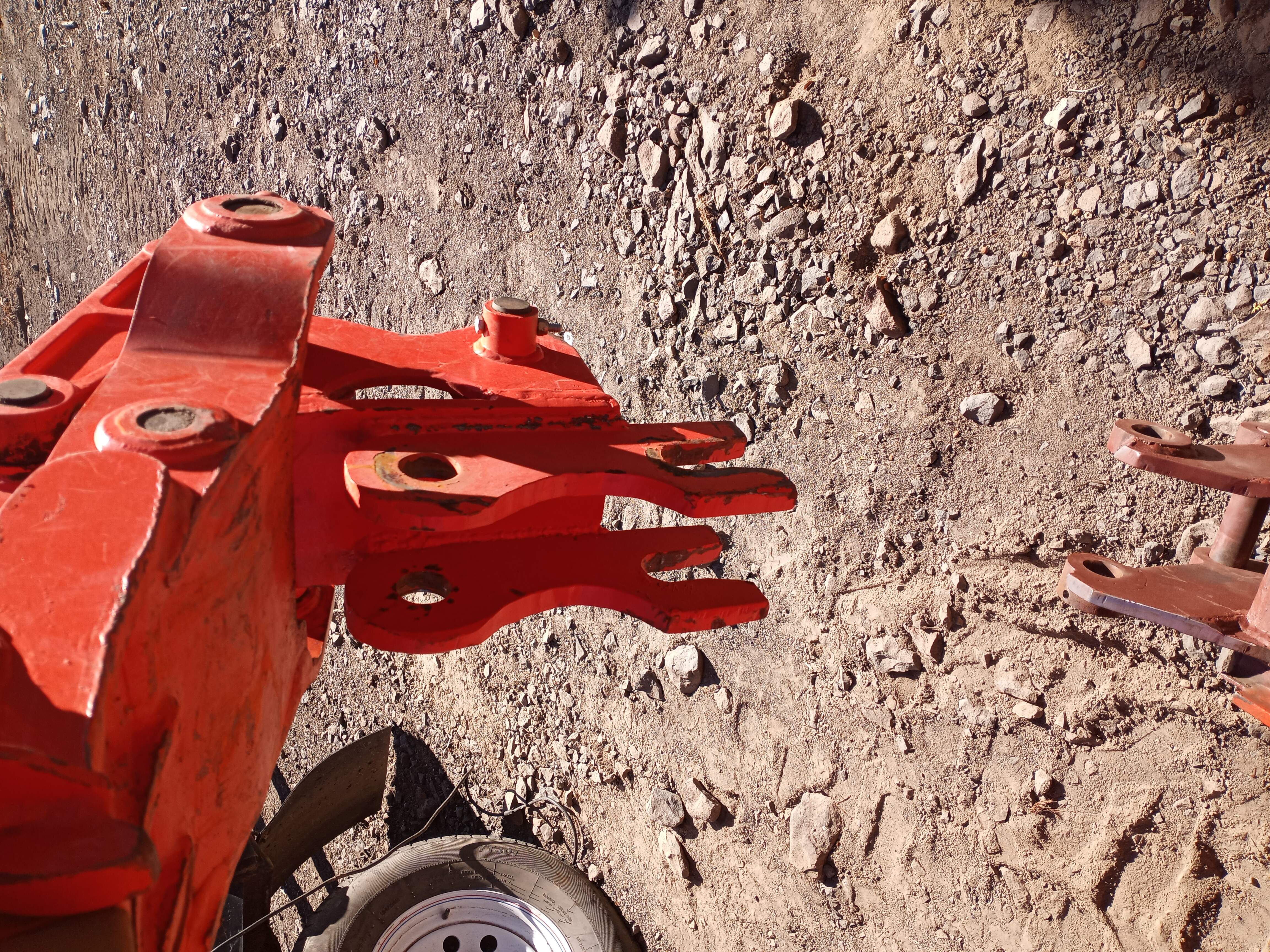

I made a quick connect for my bucket.
So I can use the pin on buckets and with one pin I can change the buckets.
You can see it in the pic.
I was thinking that if I find that the Bucket is inconvenient in some applications . I can make another Ripper attachment that will replace the Bucket.

Nice, man sounds like you're always into something! Oh yeh, I went back and looked at the pix, see the quick connect yeh, very cool. Can you take a pic of it sometime w/o the bucket connected to it?
   / Kubota BH thumb vs BXpanded Barracuda thumb #17
When I get back you to my Tractor in the next couple of weeks I will try and make the time to take a good pic of the quick connect attachment
   / Kubota BH thumb vs BXpanded Barracuda thumb #19
Here are the pics of my Quick Connect for my Backhoe.
it is a 1 pin connection now.
I do have to watch when I role the bucket up now because it re-positioned the bucket and it hits the mast if I do not watch what I am doing20201128_125941.jpg20201128_125902.jpg20201128_130935.jpg
