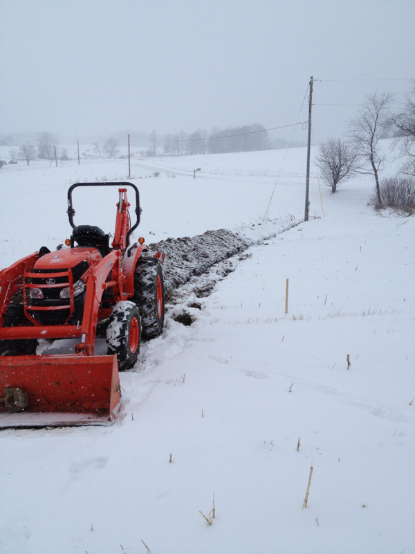

/ Kubota bh 92 backhoe attachment #6
Mine operates just fine digging at 1500 rpm. I just finished this trench about 250' long 4 - 5 feet deep through hard clay and shale. The machine performed perfect.

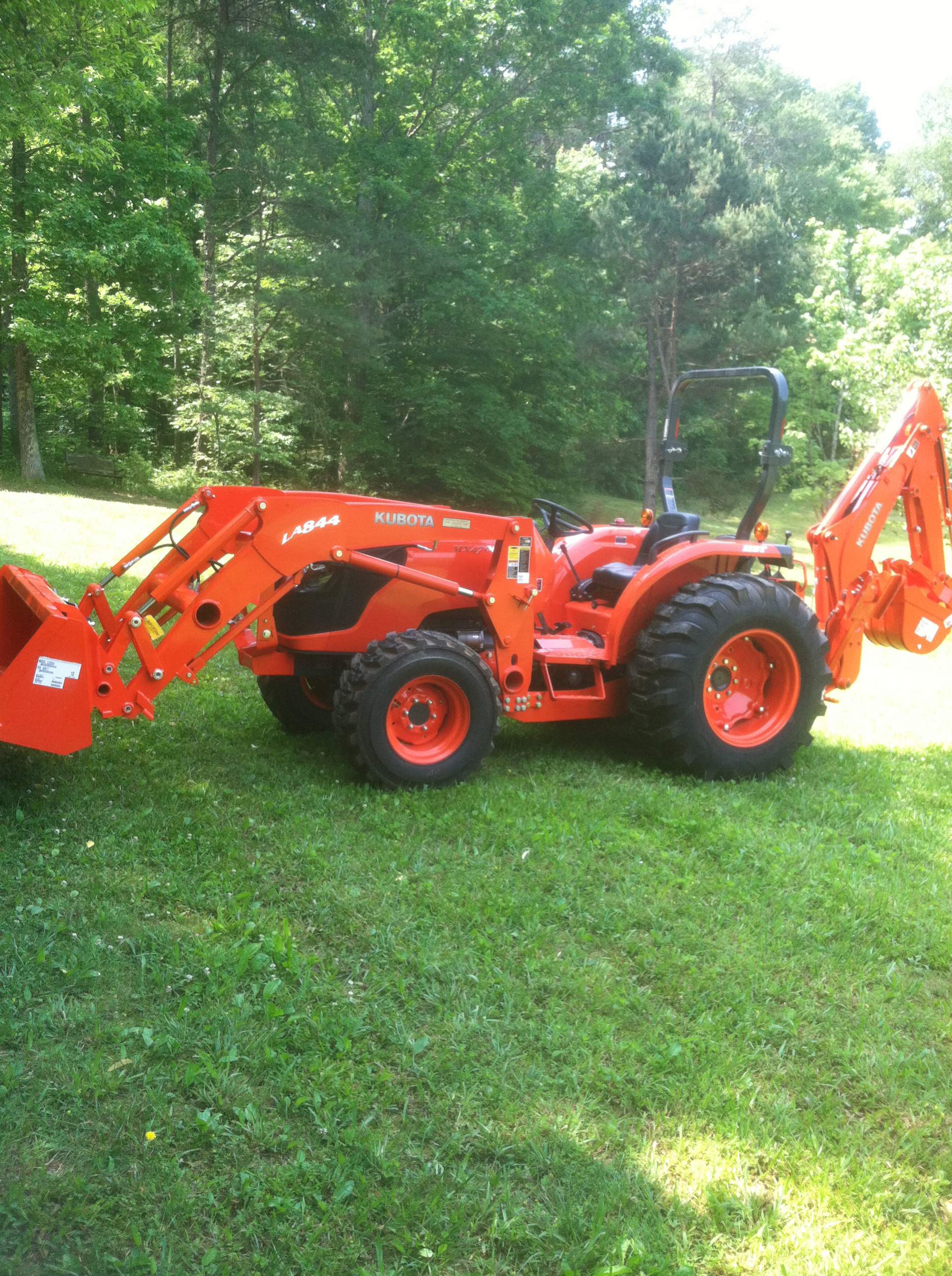

/ Kubota bh 92 backhoe attachment #10
1500rpm seems to work very good for me, anything less and its just to slow to get things done, Picture 002.jpg
