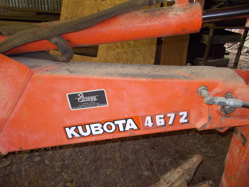

kubota backhoe on a yanmar
/ kubota backhoe on a yanmar #1
shovelrider
Apr 9, 2014
183
USA
YM1700 w / fel
I had an older Kubota bh on yanmar 1700 before. But, that was an older one. My question has anyone attached a 98' or in the 90s, kubota bh on yanmar? I read somewhere, that a newer kubota won't fit spline, i don't know. Backhoe attachment is a 4672, 6.5' reach and self contain unit, pump runs off pto. I know the yanmar has a 6-spline and i think 1 3/8" dia. shaft. But i was just wondering if anyone has one fitted to their tractor. Thanx

That 4672A looks so close to a Yanmar model of the same 90's era. hmmmm
My neighbor with an 8N has a Yanmar version like that Kubota. He has this interface coupling to connect the PTO spline to the BH.

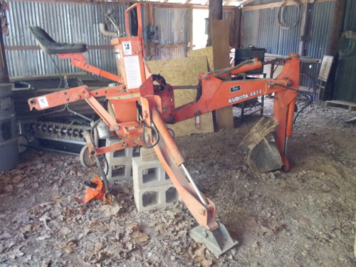

With about 200lbs in the fel, it rides pretty good at slow speed. One question, should the holes where i have the lifting arms attached to the uppers, in the correct hole ? It's in the upper hole now, is that for max weight or no? Like i said this is going on the 1720d, i believe like the other ones limit is around 1400lbs on lift. But i'm only using for small jobs in sandy soil and clay (about 12-18" dn), fairly level ground.

It's not the weight of the implement at all, it's the force imposed on the rear case from the digging and bucket action of the BH that imparts strain, especially on the upper 3 point mount. Years ago I had one just like the one you have and sold it. Exactly like it.
That upper steel arm that pins to the top link bracket allows the BH to exert tremendous force on the mount and the mount is directly connected to the axle case which is a thin wall casting.
All I can say is be careful, Never use the bucket to move the unit around, never set the stabilizer pads down to the point where they lift the back wheels off the ground and never curl the bucket against an immovable object like a root and try to break it free by curling the bucket and retracting the dipper stick.
All those things allow that top strut to impose unnatural strain on the top link and will crack the rear gearcase casting.
Know of a guy with a hoe like yours and mine that cracked his axle gearcase and it cost him 7 grand to have it replaced, an expensive lesson and why BH's are all direct frame mount now for the most part. With the frame mount ones, you take the lower lift arms off entirely and there are steel rails that run up the tractor frame rails that impart the load to the tractor frame and not the gearcase casting. With yours, the entire load force is on the upper mount, bearing down on the gearcase casting. It's not designed for that. It's designed for moderate pulling horizontally and the drawbar is for hard pulling. Good luck and be careful.

Here is an example of a 3pt backhoe damage on a Kubota L3560 if I recall correctly.
/ kubota backhoe on a yanmar #17
The 7 grand repair bill... Rips the upper mount right out of the gearcase casting. The rigid upper arm is a heck of a lever.
They don't work too well like that.
Kind of surprised, Kubota offset part of the cost the first time (had had a non frame mount Kubota hoe on his Kubota) but the second time he did it, they said nope.
Don't know what became of the unit, he might have sold it for all I know.
Looking at the lower lift arms on the OP's tractor, they aren't nearly as stout as the Kubota so I assume the upper mount isn't either.
The sub frame mount totally eliminates the upper link mount entirely.
