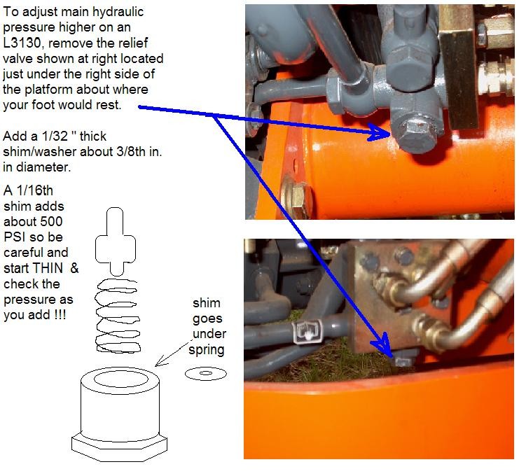

I purchased a new B7800 kubota and shortly after had a bh75 backhoe attachment install.
My problem is the first time I dug with it I noticed that it had very little power.
The tractor hyd are so weak,if you put the stabilizers down the front bucket will not lift the tractor off the ground.

My question is. Could there be anyone out there in kubota world that could tell me where the relief valve is located? I have adjusted the ones one the attachment several times,that's not my problem.I need to set up the relief valve at the pump,but can't seen to find it.I did put a gauge on one of the cylinders on the hoe. 1500 lbs.

Someone else posted this a while back it should get you in the area. Your valve should be around this same place. Good luck. KennyV.

KENNYV,
Thank you so much for taking the time to post those pictures.The only problem is mine is a B7800.The pictures you posted were for another size of tractor.Mine does not look like the one that was posted.
Any ideas???????????? Thanks again: COMPRESSOR

Go here and download the B7800 parts manual. Index of Kubotabooks/Tractor/ Your valve is on page 127 and the shims are item 090. I assume they work the same as what you saw in the above post. Adding shim will increase pressure. It looks like you have a gauge so be sure and use it to see how much change you have made. For shims you can remove what is already there to get an idea of size then go to a good hardware store and get some similar washers the same size. I tweaked mine up on my L3400 because I think from the factory they are on the low side. Let us know how you make out.
