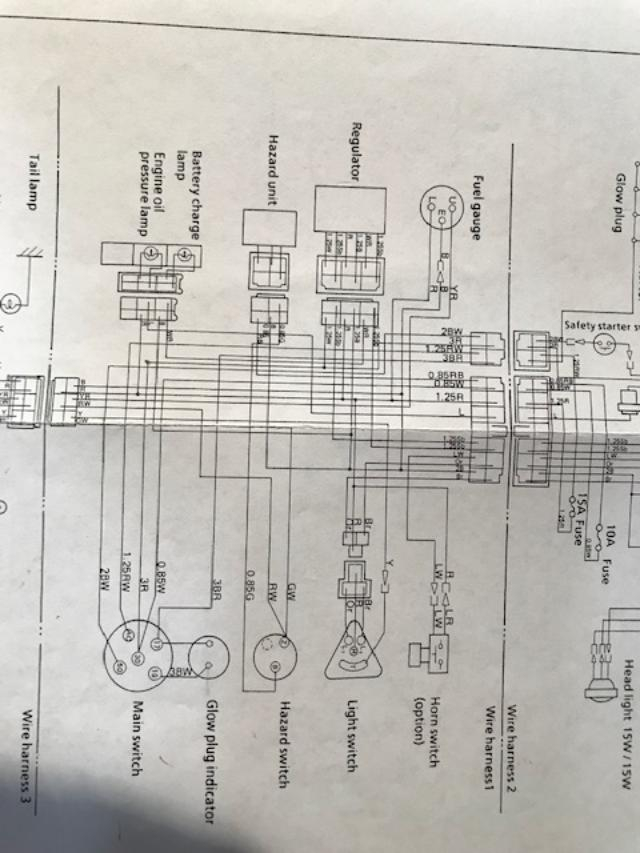

So I've been bragging about my b9200 being bulletproof and karma got me. I have nothing electrical. When I turn the key on there's nothing, no lights, no fuel gauge NOTHING! Thinking it was the battery I put a new one in and still nothing. I then went to the key switch. I checked it with a meter 1 terminal had 12 volts with the key off but when I turned the key on no terminals had any power. So I took it out and checked it by continuity and it checked out ok. I'm baffled! Any help out there would be greatly appreciated!

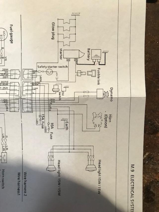

Seems like there is a fusible link around the radiator area going to the starter.
Edit: Sorry, that location is on my Mahindra. The Kubota B9200 schematic does, however, shows a fusible link between the starter and the center terminal of the "ignition" switch.

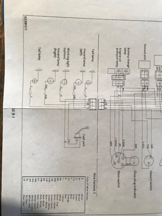

   / Kubota b9200 electrical #6
These schematics may be of some help in tracing your issue:
