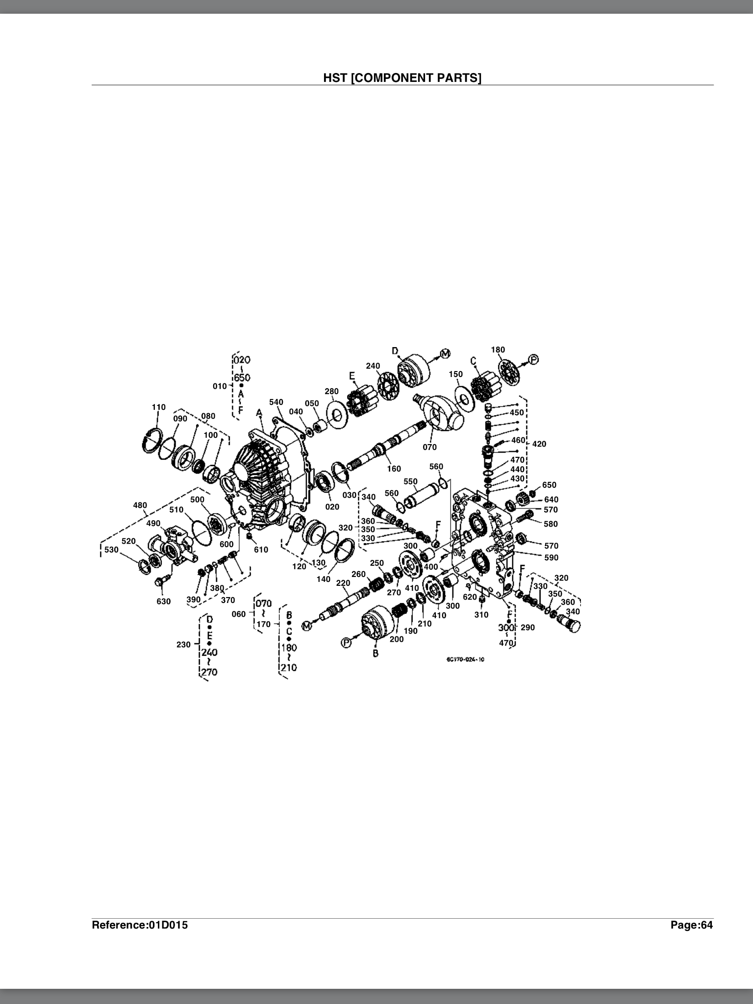

Does anybody have a part number? Even my dealer can't find it. Thanks.
   / Kubota B7800HST Front Transmission Drain Plug #2

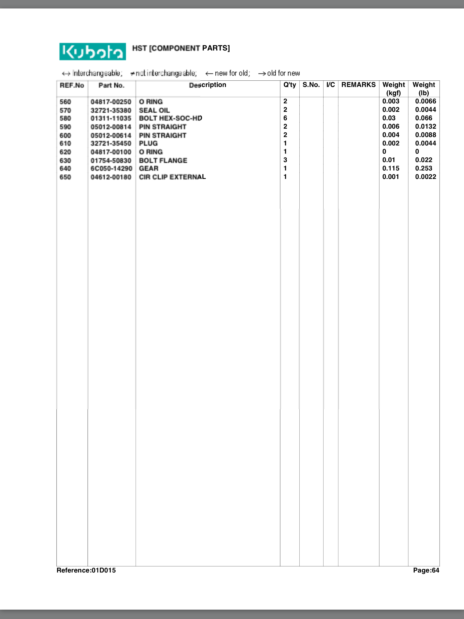

Per the attached diagram, if you are looking for "flange bolt" # 630, the part number is on the second page.
Thanks. Appreciate it.
Do you also have the second page with the part numbers?
Thanks again.
Kubota parts guy came to my ranch this evening with drain plug 01754-50830.
Looks like they found the right one.
Never found the part number, but the bolt is an M10x1.25. Mine was 9mm long, but
there are more pan threads behind the stripped hole, so got an M10x1.25-16mm off
Amazon and am back in business.
