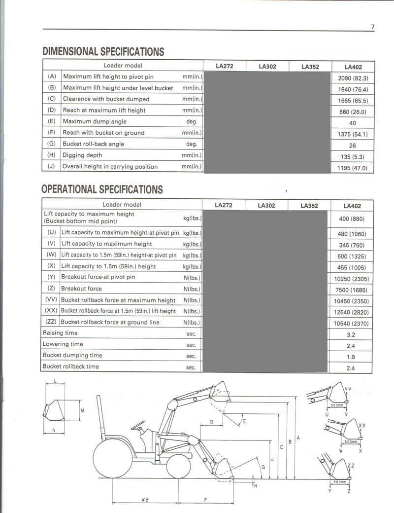

Sep 7, 2015 / Kubota B7800 FEL Lift Capacity? #1 jodebg Platinum Member Joined Mar 4, 2012 Messages 671 Location New Hartford, CT Tractor Kubota B-2650 If my memory is correct, the Kubota B7800 FEL lift capacity is around 775 lbs? Hoping someone can correct me if that is incorrect and also guide me to where I can reference this information. Thanks

Sep 7, 2015 / Kubota B7800 FEL Lift Capacity? #2 Popb1949 New member Joined Aug 17, 2015 Messages 19 Location Drummonds,Tenn. Tractor 2 Kubota B 3030HST, B2710, B2320, RTV900 Go to tractor data.com
Sep 7, 2015 / Kubota B7800 FEL Lift Capacity? #3 orezok Elite Member Joined Jan 30, 2004 Messages 3,239 Location Mojave Desert, CA Tractor Kubota B7800 Here ya go.
Sep 8, 2015 / Kubota B7800 FEL Lift Capacity? Thread Starter #4 OP jodebg Platinum Member Joined Mar 4, 2012 Messages 671 Location New Hartford, CT Tractor Kubota B-2650 Just what I needed..thanks. Where can I reference this page? Is it in a manual or available on line? orezok said: Here ya go. View attachment 440123 Click to expand...

Sep 8, 2015 / Kubota B7800 FEL Lift Capacity? #5 orezok Elite Member Joined Jan 30, 2004 Messages 3,239 Location Mojave Desert, CA Tractor Kubota B7800 jodebg said: Just what I needed..thanks. Where can I reference this page? Is it in a manual or available on line? Click to expand... Available here. Kubota: LA272,LA302,LA352,LA402 Owners Manual, Part # 7J043-69122 | Messick's

Sep 8, 2015 / Kubota B7800 FEL Lift Capacity? #6 IslandTractor Super Star Member Joined Sep 15, 2005 Messages 15,802 Location Prudence Island, RI Tractor 2007 Kioti DK40se HST, Woods BH Kubota names their loaders by lift capacity in kilograms. A LA402 will lift 402kg at ?midbucket or ?500mm from pivot pins.
