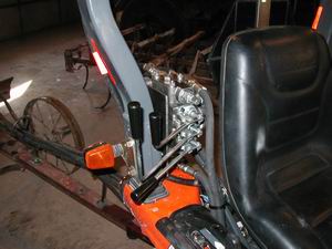

Some photos of the rear hyd outlets on the B7610 if it works. I'm not sure how to attach photos.

It appears to have worked? The outlets use prince SV series stack valve with power beyond. Plumed from the front 4 way to the SV and then back to the tractor. Not hard once I figured out where to put the valve. I did have help mounting it and fitting the hose. Originally I intended to put it outside the rops horizontally but then decided on the vertical mounting. The levers are not as handy as I would like but it works out ok. I did have to modifi the levers a bit. The bottom spool is a detent valve I intend for hyd motor use I have not yet decided weather or not to modifi that lever. Used pioneer 8010 couplers so I could interchange with ag tractors. Worked out good and it will see alot of use. I have a little trim work to do with it yet and some paint. Thanks Madreferee for all the help.
   / Kubota B7610 Rear outlets #5
You are welcome. Nice job.
