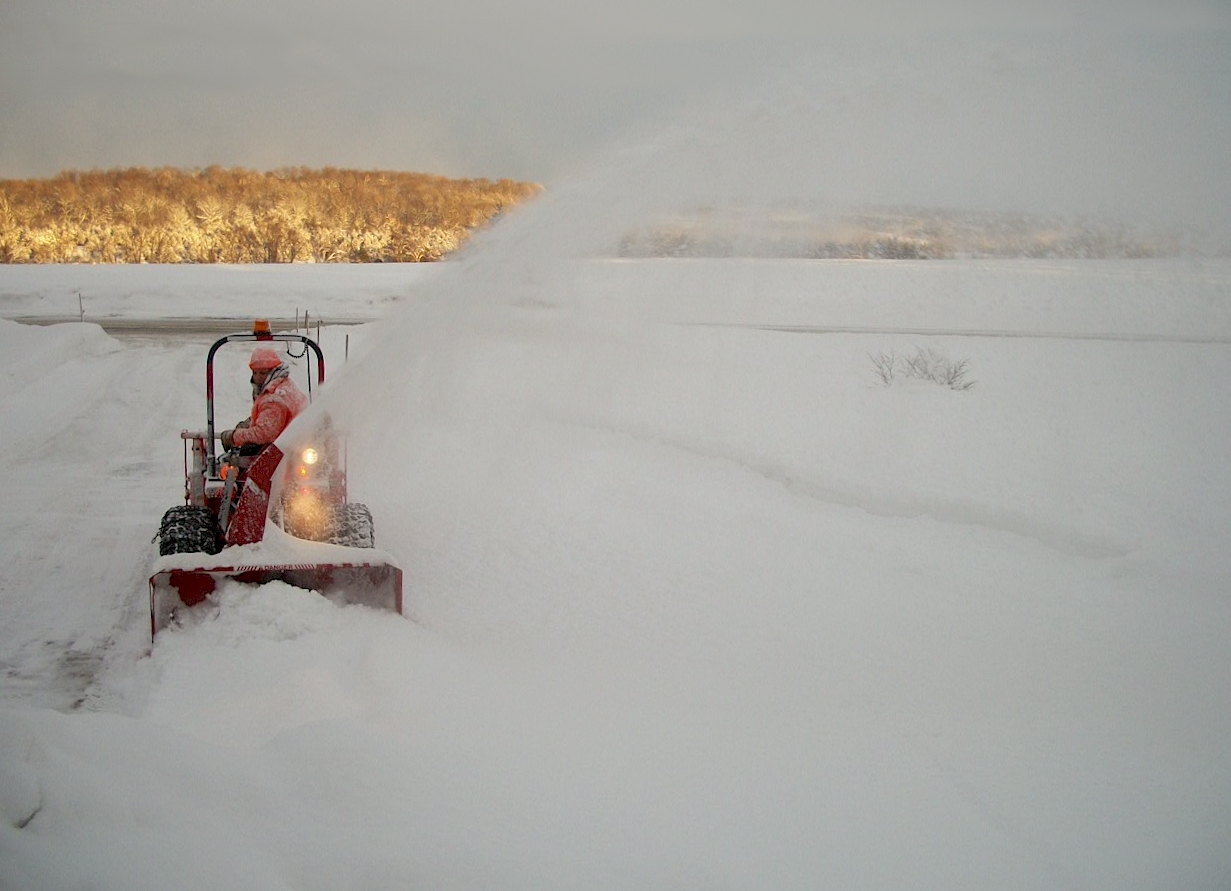

FWIW: I have had my B7300 since 2002, and I bought it with a 54" Pronovost Puma rear mount blower. While we have not had much snow the past few winters, back in 2006, when we had nearly 24" on Valentines day, my B7300 was the sort of hero in the 'neighborhood'. I was busy all morning, clearing my drive, and 4 others, (one nearly 1/4 mile long with hills), along a 1/2 mile stretch of our road. The 12.5hp on the PTO handled that snow depth with ease and I never had to refuel. I have to admit. Now at my age, I would really appreciate a front mount blower. I do highly recommend both front and rear chains. Traction on the front end really helps with steering and control. Photo shows me clearing a neighbors drive during a storm in 2011

I missed that question. I have had my B7300 for 22+ years, and other than replacing (hydraulic shop) two front FEL hoses and two batteries, the only other parts have been oil, hydraulic, air, and fuel filters. This Kubota has run literally error free all that time. I am still running the original fan belt. I believe parts are available. There are several possible sources nationwide, if need be. I once looked on-line for potential 'alternator' and coolant hose replacement, and found numerous OEM and other sources.
