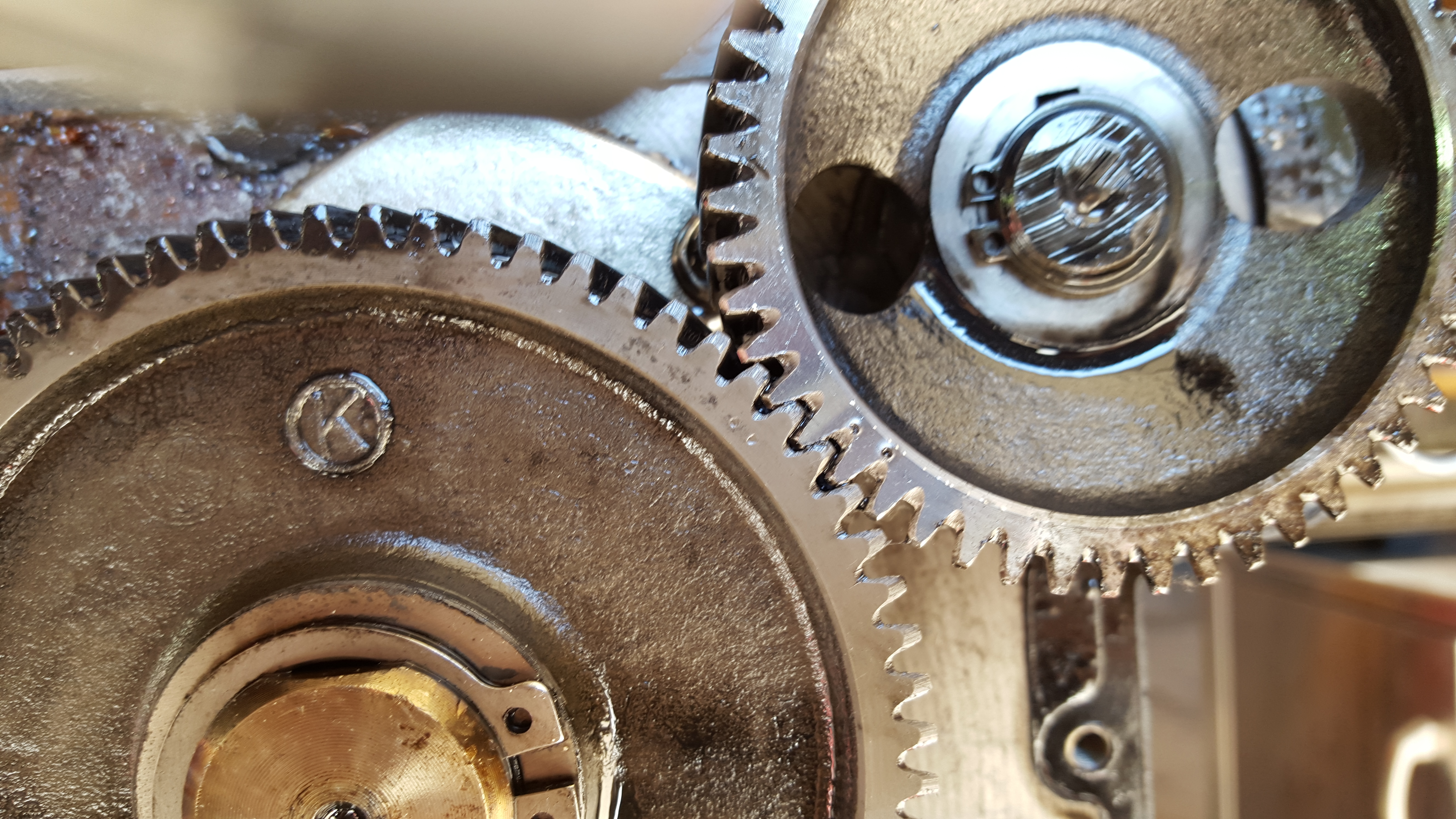

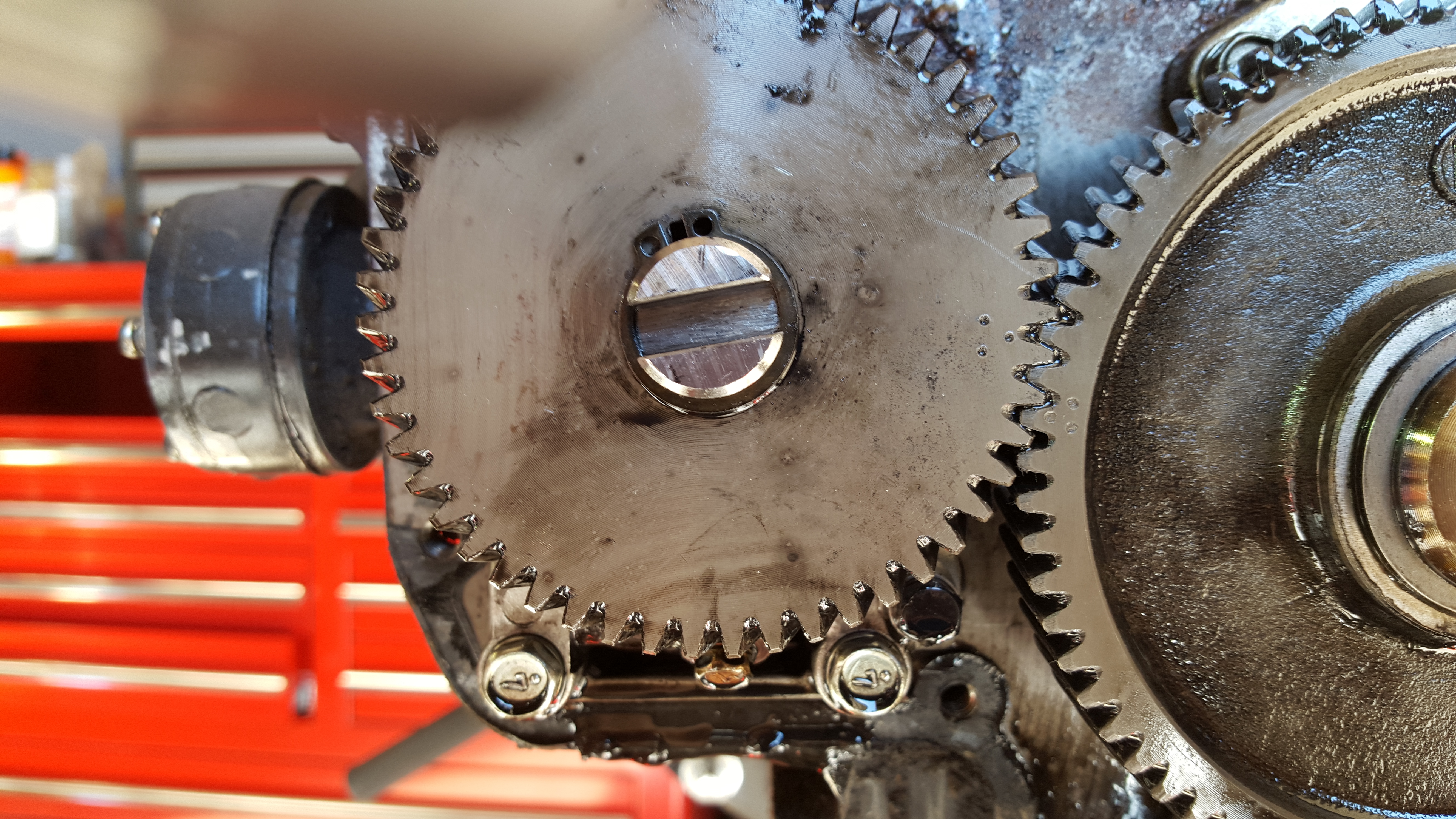

Hi All:
I recently completed an overhaul of my B7100. The tractor was not running when I bought it, so I knew there was some work ahead. I recently completed a full rebuild. When dismantling the engine, I noted the timing gears were off a bit (see pictures) and decided to line them up "correctly" according to the repair manual. I anticipated this may throw the timing off but tried to start the engine after completing the rebuild without checking timing just to see how it acted. It produced a lot of white smoke and tried to start, but that was it. I added some shims and now appear to have the timing set correctly. The tractor will now start but only runs about 3 to 5 seconds and then dies. It still produces a fair amount of smoke. I did install new Kubota fuel injectors just to make sure everything was good after the major overhaul.
Does anyone have any suggestions as to the problem? I am thinking possibly fuel pump??? I checked the diaphragm and it looks OK? Injection pump??? How can I diagnose these areas with my limited tools, expertise??

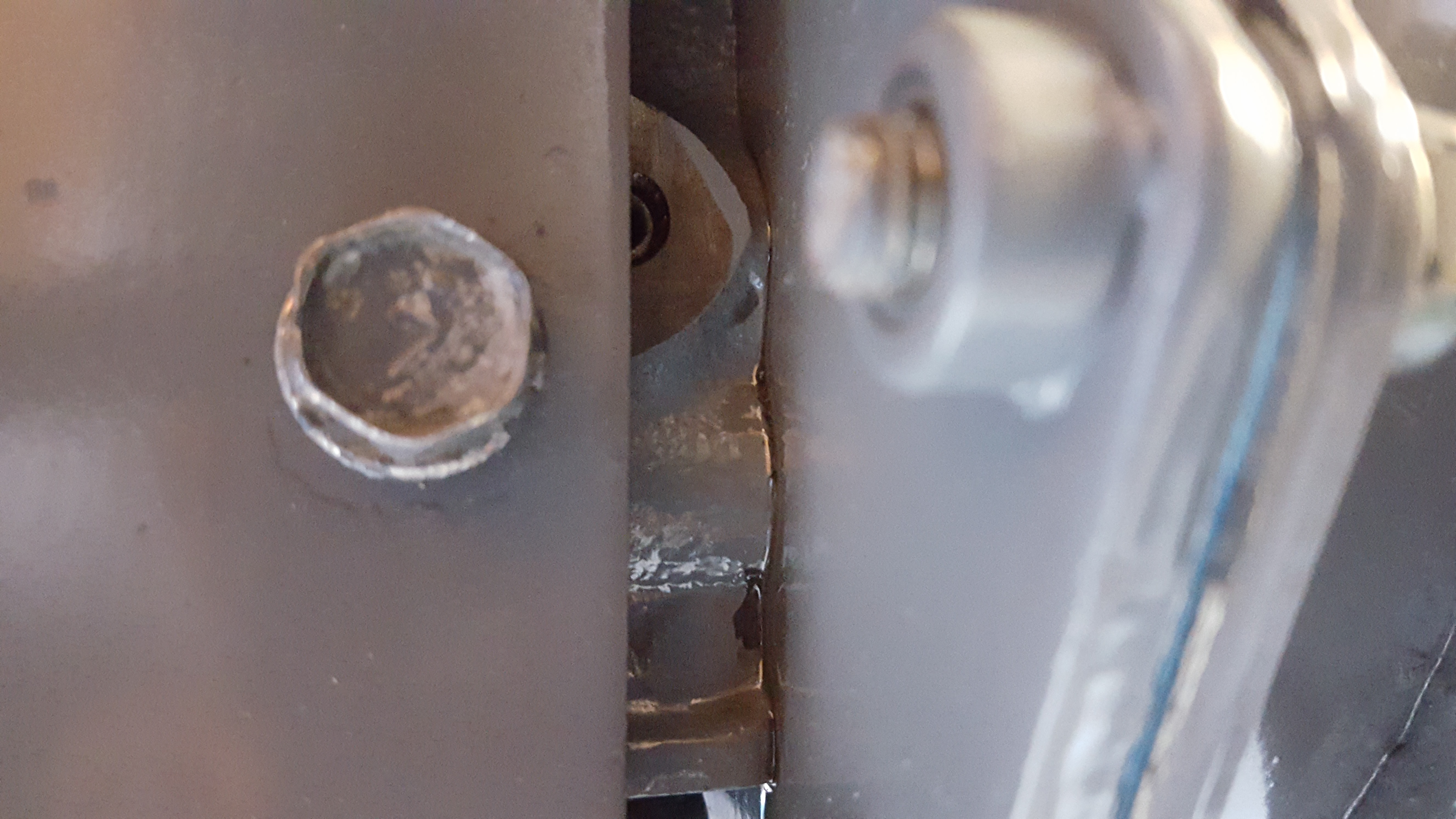

After the short run session, I noticed oil leaking from the back left (exhaust) side of the block where the steel plate mates up. (see picture) It only leaks when trying to start the tractor, no leak just sitting. I did have the block bored out and I noticed there is a plug in the side of the block near the leak, but it is not the source. Maybe there is a similar plug on the back side of the block?? It is not coming from above at the oil pressure sensor - I wish that was it. Looks like I will have to split the tractor again to get to the source but just wanted to know if anyone has any ideas based on the area of the leak??

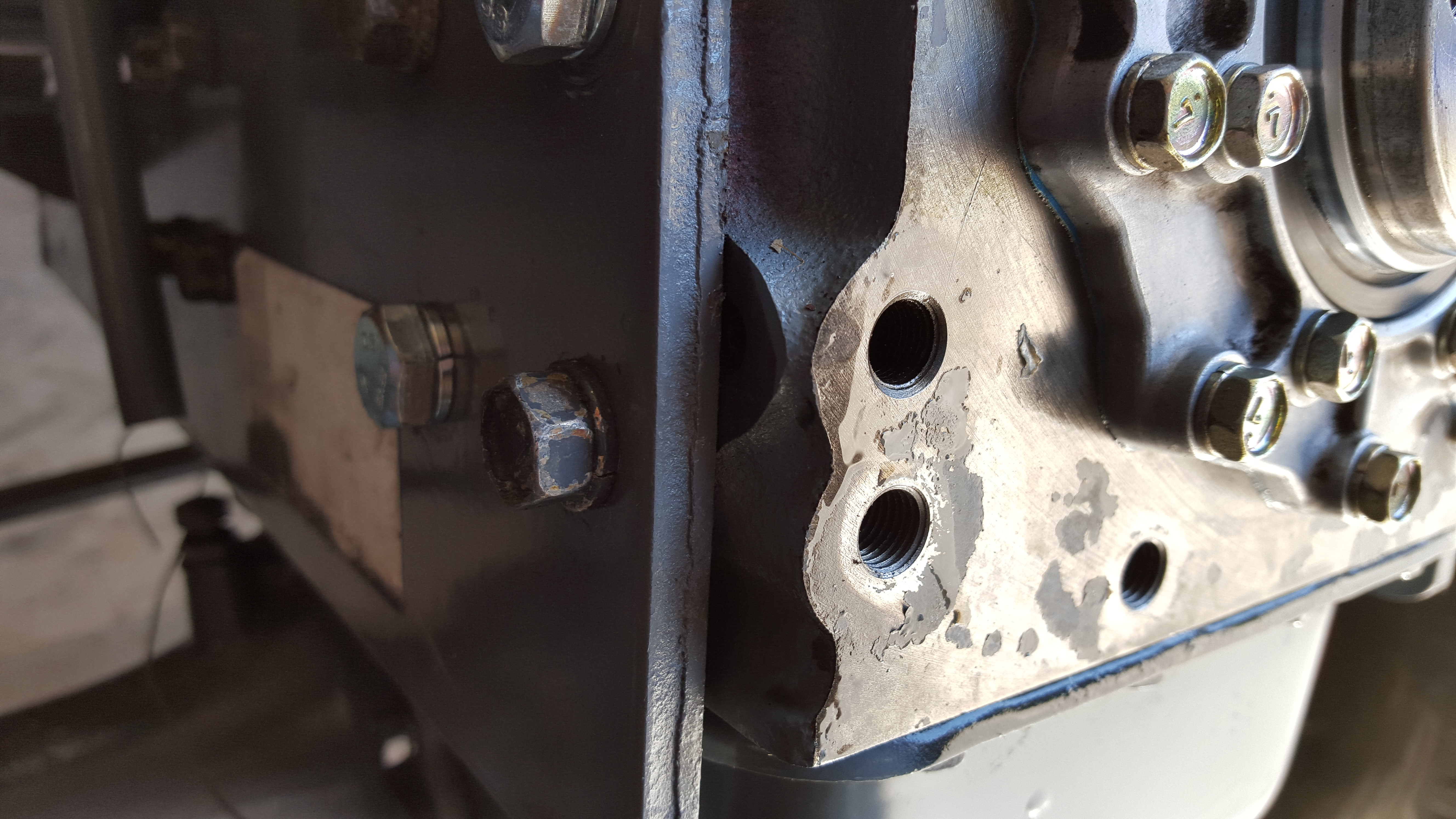

I found the oil leak. There is a missing plug in the back of the block, adjacent to the one I could see on the side at back left side. Apparently, the machine shop left this out after the completed boring the block and cleaning it up. It the same diameter as the holes used to bolt on the rear flange and I did not notice it missing either AAUUUUGGG!! Problem solved with a lot of extra work, assuming I can get a replacement from Kubota - it does not show in my parts diagram???

Picture of missing oil plug, second hole up from bottom left.20160319_145006.jpg

I checked the timing again this morning and it appeared to be right on the money - 25 degrees BTDC. I turned the engine over slowy by hand and the front injector port on top of the injection pump showed an indicatation of fuel rising right at the 25 degrees BTDC. Before I retimed the injection pump (after alining the timing marks on the gears), it would not start, just acted like it was out of time and blowed a lot of white smoke while spinning over.
