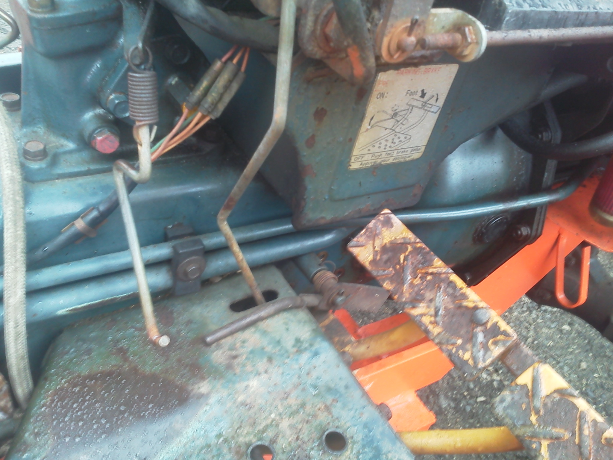

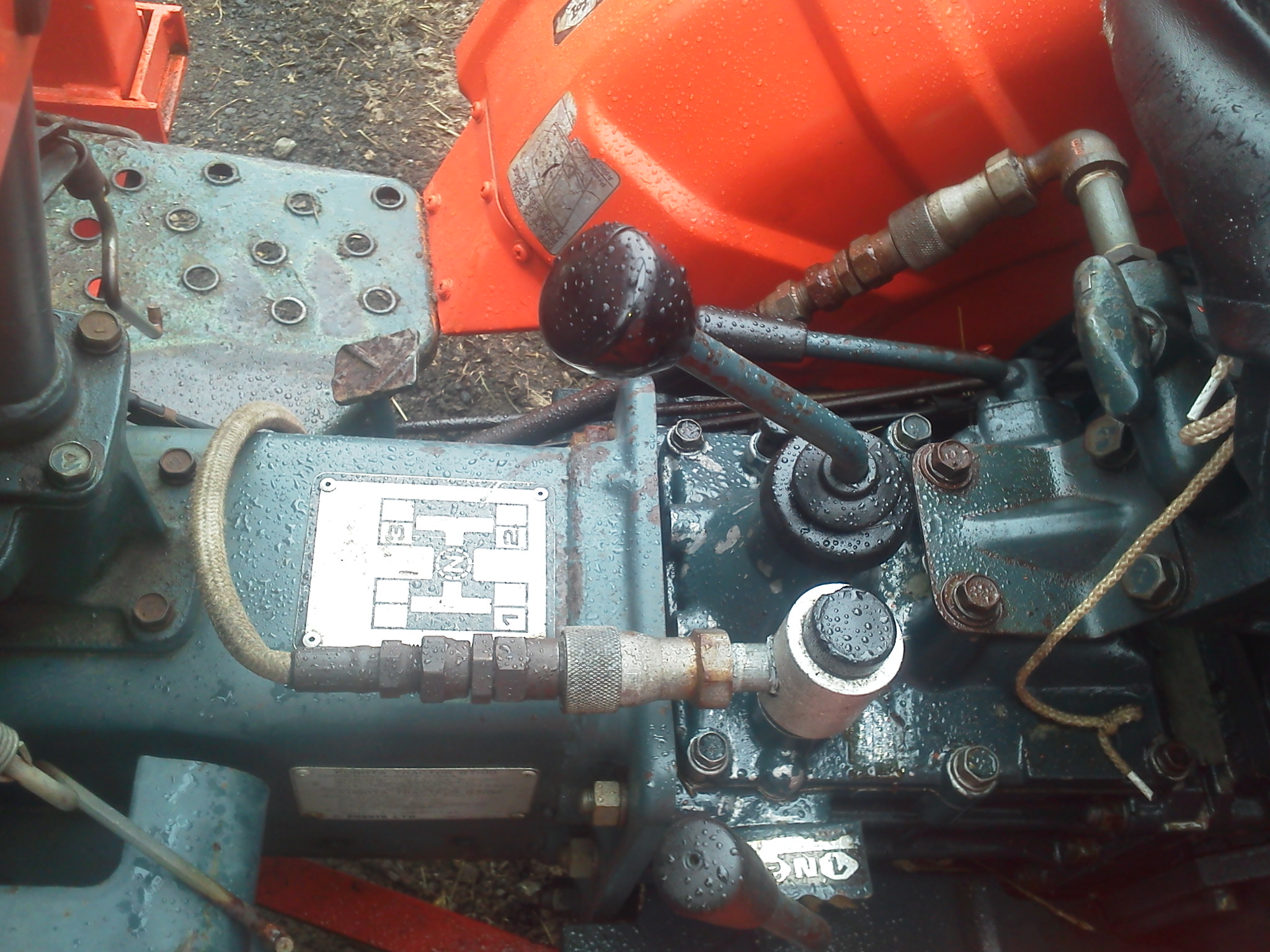

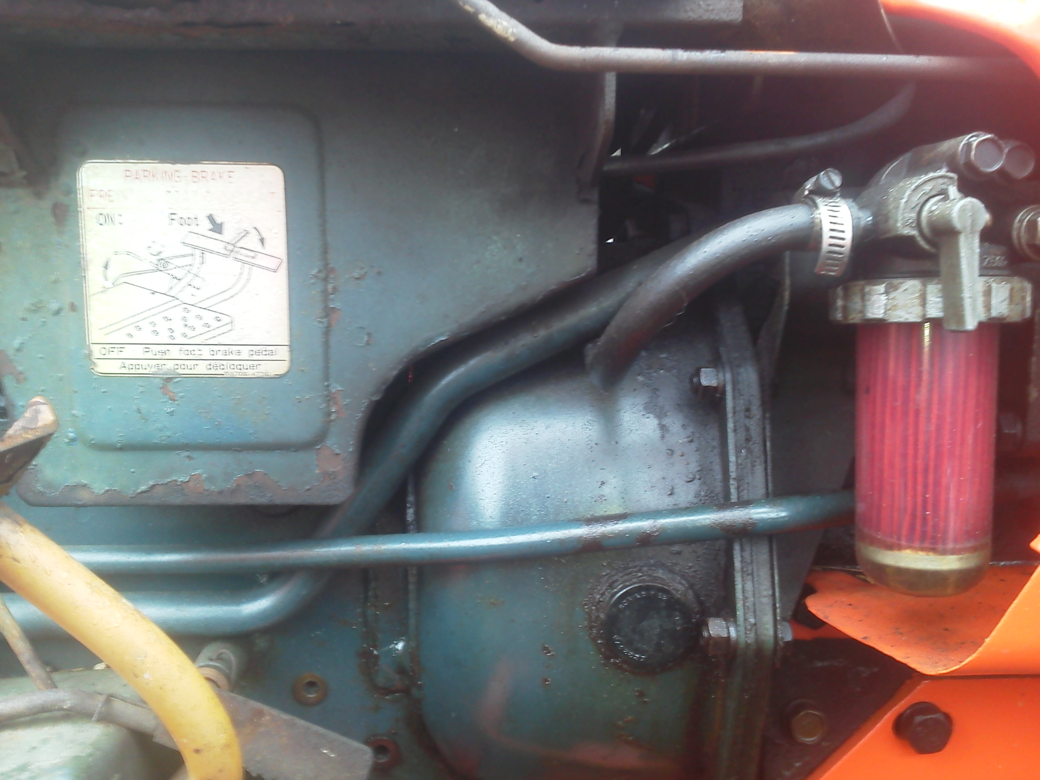

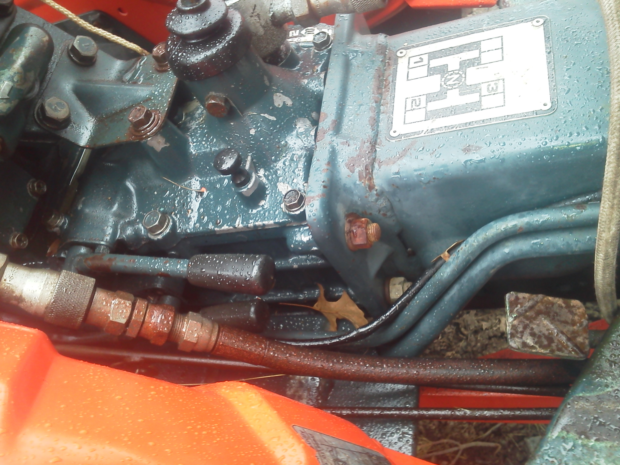

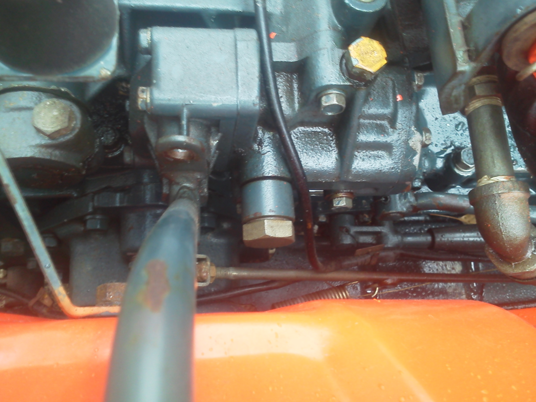

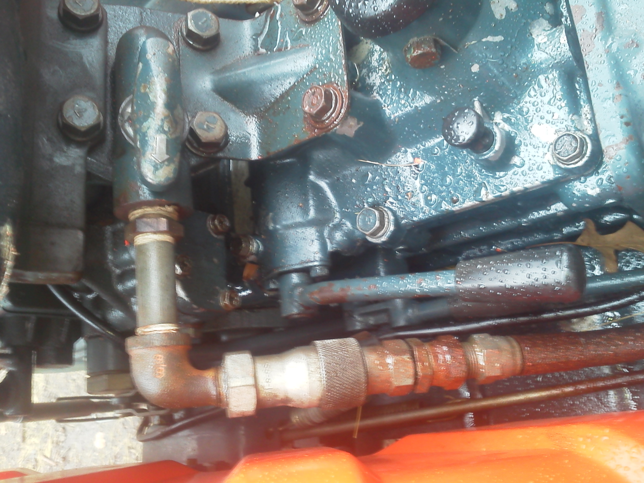

I will upload photos ASAP, ishiboo there is no hydraulic block on this tractor and if there is it is not on the steel line.
   / Kubota B7100 FEL only works when 3 point raise lever is pulled back
#18
IMG_20140302_142409.jpgIMG_20140302_142403.jpgIMG_20140302_142356.jpgIMG_20140302_142348.jpgIMG_20140302_142324.jpgIMG_20140302_142313.jpg
Ok heres some photos! Tell me what you guys think! The pressure line for the loader is the flexible one coming out of the 3 point valve assembly. The return line is that one going into the dip stick/ trans fill.

Seems like someone did something similar where they paralleled the 3pt with a tilt wagon cyl.
I am thinking they did the hyd all wrong.
Since the B7100 hydrostatic models all had the adapter plate in the pump in line, it would seem normal to cut into the hyd line and install the loader valve so things would work correctly.
