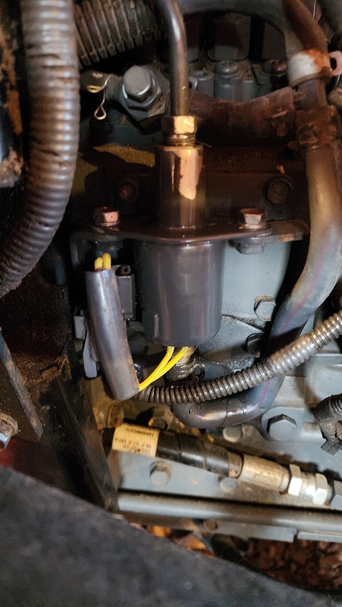

I took off the top fuel line to this. And no fuel came out while cranking... is this the fuel shutoff solenoid? The bottom line comes from the fuel filter and has fuel. The top line goes to the injectors and no fuel is coming out of it while cranking.
I’m quite sure that’s your electric fuel transfer pump, should have fuel squirting out when you cranked. check to see if you’ve got power to it.

Hey guys, just wanted to give you all in update..... I was stumped on this one and spent hours running down the issue. I even spent hours on the phone with a kubota mechanic. Long story short, we had it towed to the Kubota dealer and it took them almost a year of working on it to fix it.... They threw part after part after part, until they got it to run. Nearly 20k later(All but 1k was under warranty.) it runs! They still don't know exactly what it was, but they did replace the entire regen system and alot of other stuff. It made me feel better that I wasn't the only one that couldn't figure it out. Thank God most of it was covered under warranty!
