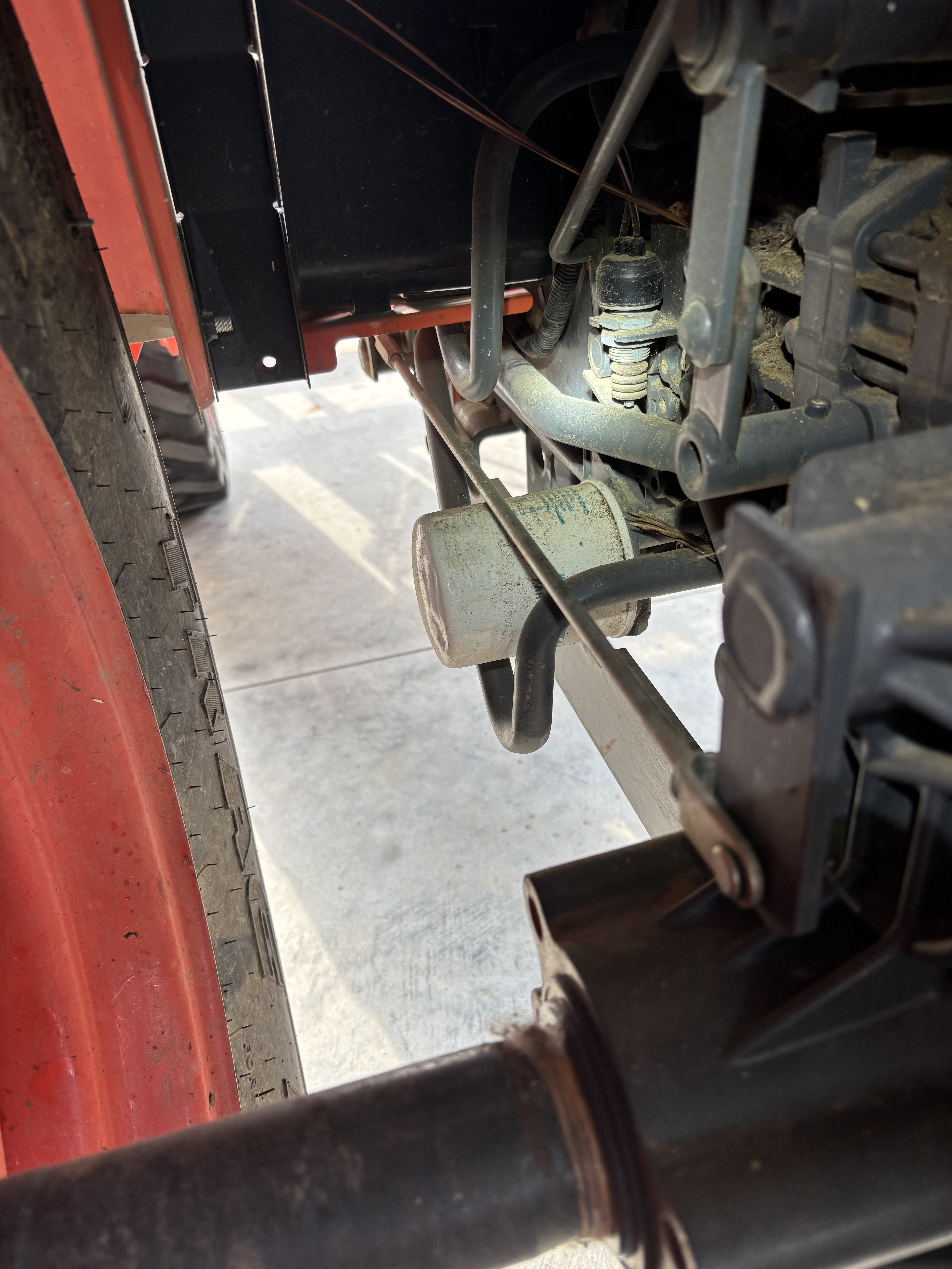

So my dad was driving through the trails on the property when he stopped and shut the tractor off to cut up a tree that was across the trail. HE got back on the tractor and went to turn the key and the ignition switch fell into the dash. I went out and was able to take the dash off and put the ignition switch back in and screw the cap on that sandwiches it together on the dash. Now the tractor wont start. When I turn the key, all the lights come on the dash, the fuel pump kicks on. When I turn the key all the way to start, it doesn't do anything. No clicks from the solenoid, nothing. I checked the connection on the back of the ignition switch, and it is secure. I tried to cross the solenoid on the starter and the start spins freely but doesn't come out to engage with the flex plate. While looking at it... There is a black remote wire that is plugged in the starter, a positive cable that bolts on the starter, and another wire that goes from inside the starter to a terminal on the solenoid. There is also a white wire that comes off of the terminal on the solenoid, but it goes to a white plug that wasn't plugged in to anything. I cannot find any spot that this connects to. Is it just an extra plug for something this model doesn't have? I took the starter off an I am taking it to get tested. We are also charging the battery and I took the ignition switch off to try and check it as well. I've about had it with this tractor!!!!

Do you have a voltmeter or test light for 12 VDC circuits? If yes I would suggest checking for power to the starter solenoid when you turn the key. If no power there you need to start tracing the start circuit to what connection is not being made. Not familiar with your tractor but are all of the safety switches being made? If driving down trails through the woods could a stick possibly have snagged a wire under the tractor?
   / Kubota B3350 wont start.... AGAIN #4
I'd be checking all the fuses also as maybe when the switch was loose something shorted out.

Starter tested good.( for those doubting what im doing) I did not have a voltmeter in the woods or test light. So I took everything I could home with me where my tools were. Again, starter tested good, I also used voltmeter to check the ignition switch. The switch worked in every position. Im going back out this week to check the remote wire at the starter with a test light. I too am wondering if a safety switch is stuck or bad. Some of these are in pretty easy spots for mud, sticks etc to hit them.

The other reason I took it off is because I was out in the middle of the woods with limited tools ( no test light or multimeter) and no cell service. I didn't want to make multiple trips. So everything it " could be" that I could remove easily, I just took with me to test at home
