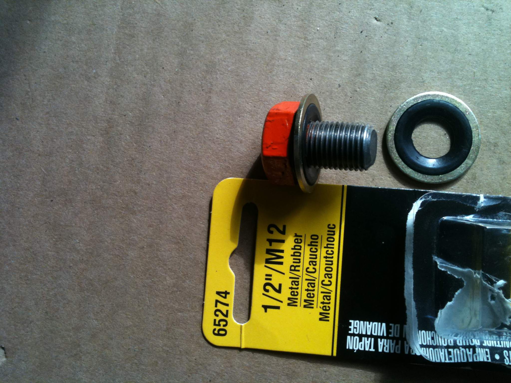

It's a bit overkill, but I modified all of the drain plugs with neodymium magnets. Also added o-ring type drain plug gaskets. Below are a few pictures to help with the modifications.
Milled the center of the drain plug to accept the magnet. Neodymium or rare earth magnets are very powerful.
Package of Magnets
Painted drain plug and O-Ring Gasket
