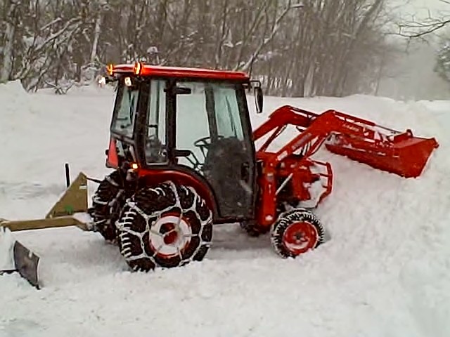

Hello fellow members.
Two winters ago I purchased some double ring tire chains for my B3030 cab tractor.Unfortunately they rubbed on the inner part of the fender and I returned them.Problem is,I have a steep grade that requires traction in the winter.It's almost impossible to get traction when there is ice or packed snow.I do not want to spend the xtra $$$ for wheel spacers.My question is: Is there a type of chain or cable that would clear the fenders on my tractor without the use of wheel spacers? Not sure if studding the tires would work.
Thanks for any advice.-Andy.

I found that spacers for my B3030 was one of the best investments I ever made. They cost $325 with an additional cost of one hour labor to install them. For this, you get to use your tractor year round without worry of rolling it or getting stuck in the middle of a storm--where nothing or noboby is moving.
I forgot to say: In the land of ice and snow, the man with chains is king!

I have to agree with AStanton....... rear spacers were money VERY well spent.
I did see a 3030 at the local dealer.... on consignment, I think. I do not know what brand of chains they were, but they did fit with no spacers. Very small chain.... and it didn't look like they would last very long. So.... it is possible.

My chains are the smallest I could find at the time. They came so close to the fender that if they loosed up they would hit the fender. Put a set of spacers in. Have not looked back. Never have taken them back out. B2910 and B3030 have same wheels/tires and fenders.
