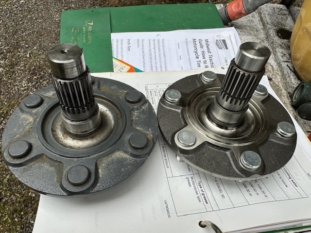

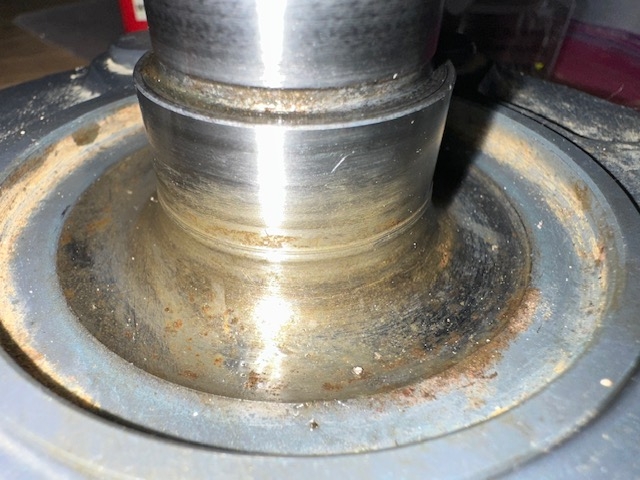

I replaced the left front axel today. I couldn't appreciate any physical difference between the replacement (4 lbs. 1.2 oz) and original axel (4 lbs. 3.6 oz). After cleaning the point of attachment of the axel to the wheel flange with a brass bristle brush I found rare short hairline cracks and some superficial pitting (more easily seen if the picture is expanded). Not sure when or even if it would fail. If the new axels last as long as the originals I’ll be at the century mark and unlikely still driving a tractor.
   / Kubota B2710HSD front axel sheared off. #66
Thanks for up date and pics. Looked at enlarged pic of the "old" hub and see annular series of pits but no cracks. Are the cracks you see radial or annular?
If the overloading were equally distributed across both front wheels, I would expect to see significant cracking in this hub, but I don't.
Perhaps the R hand failure was unique to that hub and for yet to be determined reason.
When you expand the picture look very, very closely at near center slightly above a ridge. Beginning in the horizontal band of corrosion and extending upward slightly to the left you'll see a short tiny linear crack. If you look down and slightly to the left from that crack you will see another fainter, slightly longer crack angled in a similar direction. I used a pick to make sure they were cracks and not just a stray line. Not sure if they are significant or not. As you have pointed out there are a lot of unknown variables to consider in what caused my right axel to break. Having acknowledged that fact, I’ll sleep more soundly knowing that I replaced both axels; however, the tractor and I are long in the tooth so as Gilda Radner so famously said "It's always something."

I do have a theory on why the front axels may eventually break at the junction with the wheel flange. If you look at the picture of my original axel you will see a raised band of the axel with the corrosion/cracks only appearing adjacent to the junction near the flange. The raised band is where the axel is surrounded by a bearing with an oil seal (which I did replace). It did a really good job as I never saw any axel oil seeping through. Perhaps if that area was lubricated it would not have corroded.

Petdoc,
I had good look at highly magnified lower pic of post #65 and both pics of post #1 and conclude that your right hand hub/ axle failure was a single dramatic event, likely overloading, due to Kubota's improper weld at axle to flange joint. Both post #1 pics show a annular brown band surrounding a white annulus. I believe the brown discoloration is indicative of a weld failure and joint created during manufacturing where the brown is oxidation of the metal and the whitish band is the recent crack and failure. Notice the radial cracks in the brown band are also brown indicative of a long ago failure that was open to oxidation but not sufficiently open to allow water entry to cause pitting.
If the weld failure was an ongoing process, you would see significant burnishing of the brown oxidized annulus due to flexure of the failing joint
I do not see the above sort of failure in the recently removed left hub which reinforces my opinion of a one off manufacturing failure. If you bought the tractor used then it is also possible the left hub had failed and was replaced and therefore has fewer hours on it.
Given other TBN members have brought up axle failure, I suspect Kubota or a subcontractor had some manufacturing/ quality assurance issues.

Petdoc,
You very well may be right. The junction is obviously a weld site. I did purchase the tractor new. When the right axel sheared off the loader bucket was empty, but the separation may have already started. The morning it occurred it was below freezing. After allowing the tractor to warm up I had driven at a very low speed about 30 yards when the wheel suddenly began to turn outward then separated-all within a single rotation. My initial thought was the bearing seized up, but that was not the case.
