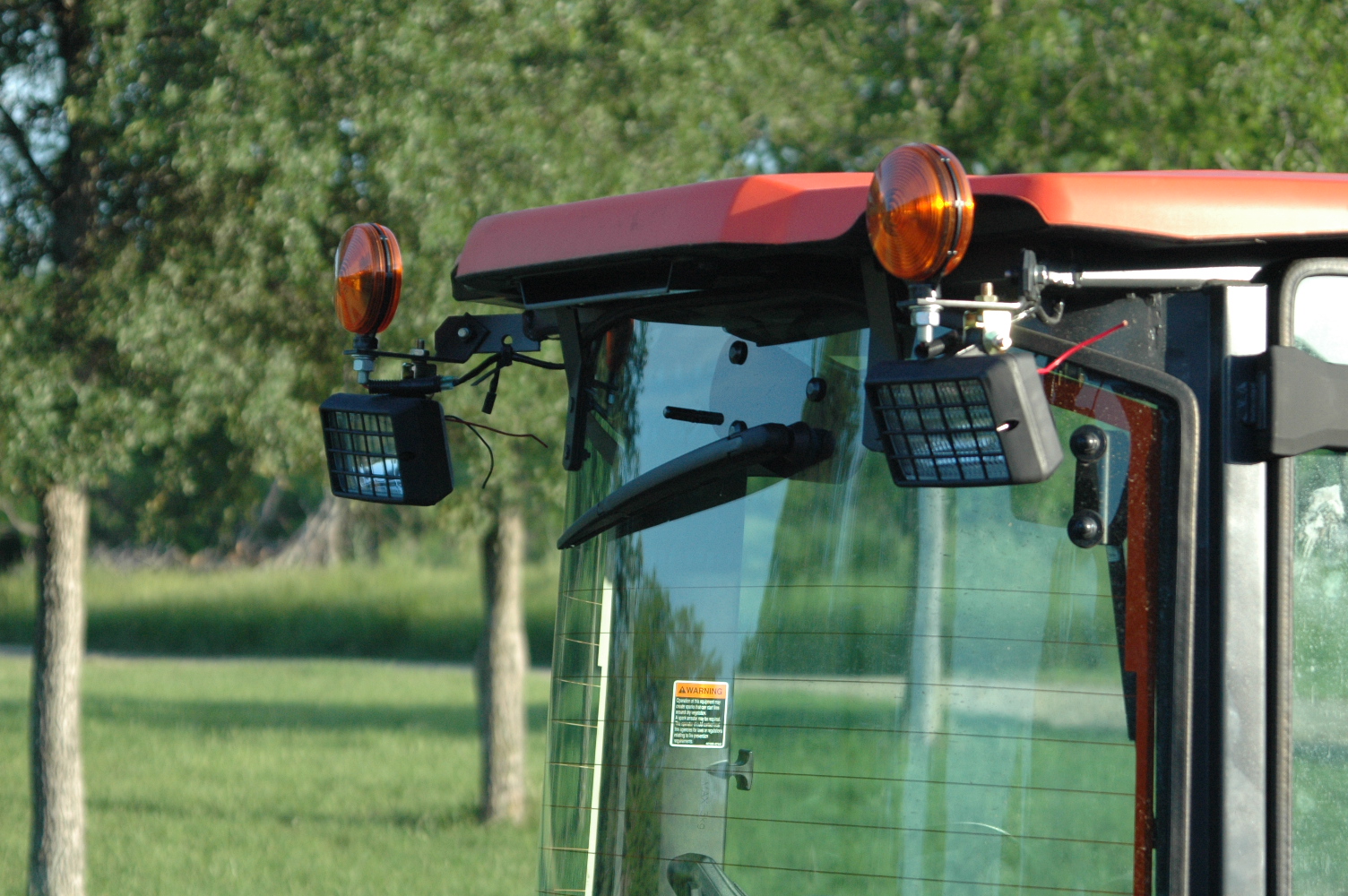

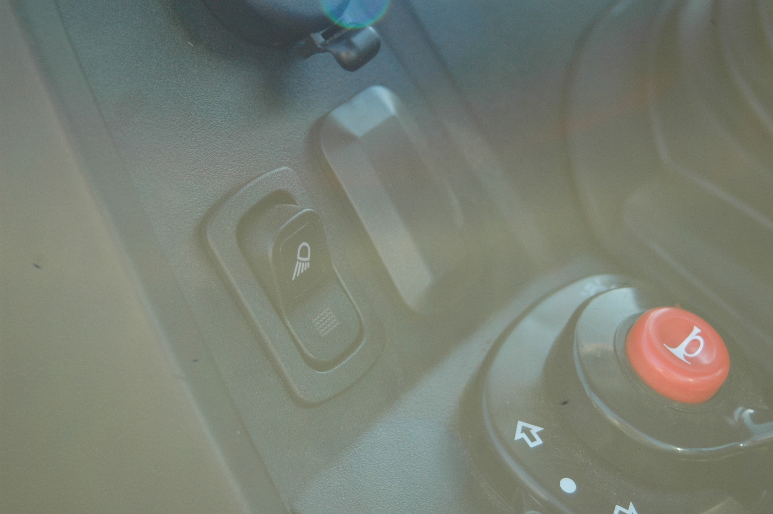

Does anyone know how to wire the dashboard switch for the rear worklights for a Kubota B2650?

it is the coolest tractor ever.. perfect size for my place. the serial number is A0106, so i figure i'm the 106th kid on the block to get one... i just finished putting the rear work lights on.. so now i need the proper connectors (the wire is there with the female connectors).. and i need a proper rocker switch for the dashboard. I had to drill the holes in the brackets for the lights.

If it's anything like the B2620/2920, there are leads already run to the rear right fender for the work light circuit, which are switched on when the ignition is on. You can wire a switch inline to the light from those leads. On the B2620/2920, there is a blank panel on the fender that is a perfect place for switches.

As for the wiring, yes, I believe the tractor already has the all the wiring pre-installed for the rear work lights based on what I saw in the parts diagram. You should only need to order the switch (p/n: TD350-75360).

Behind the dash, at least on the B3350 . . . the B2650 should be the same, the plug and wire for rear work light switch is secured with blue tape to an upper portion of the wiring harness. It is not reachable without partially removing the dash so as to remove the tape and bring the plug down.
To remove dash, remove one Phillips head screw under the center package cubby. Then loosen two 10 mm hex head bolts one each side under the bottom lip of dash. Lift steering wheel rubber boot and then pull dash outer section up and to the right.
Here's a picture of my rear work light install, they are 36 watt LED's ($57 eBay) and provide much better light than the stock front work lights. Note that the "lollypop" light brackets on the "larma's" B2650 look to be reversed from the way mine were delivered. This opens allows mounting the work lights higher and in the recess area of the rear roof line as shown here:
I made some simple brackets to mount the work lights using the existing lollypop light bracket, shown in primer:
