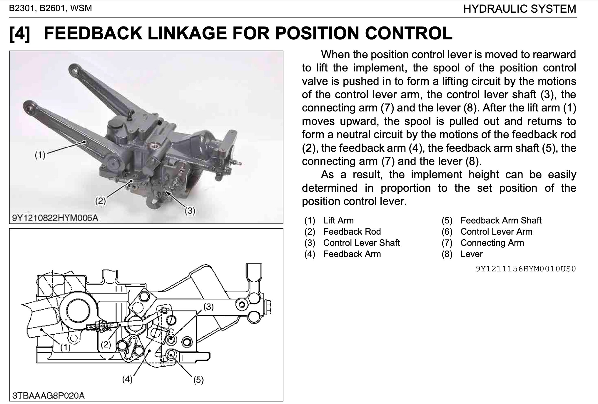

What I noted today was that the position lever control at the right hand of the operator had little response to initial movement. That is, positions number 0-3 were all the same, and at the lowered 3pt hitch position.
When the control lever was pulled to the greatest lift position, the lift arms were higher than I will ever need, so there is no loss of range.
I'm wondering how to set the position control feed back adjustment (under the seat) to obtain greater sensitivity in those initial position control lever settings.

First, I am not confused about the drop speed adjuster. There is another double nutted adjustable link that is just accessible from above when the seat is fold up and forward, and visible in the region adjacent to the right upper lift arm. The entire piece may be six inches long and is nutted to a stationary plate while hooked to a lever arm that in some way influences the lift arm positions. I just don't know how it works....yet! ;-) I should have taken a picture or two.
Second, the rake tongue does not contact the ground even when the tractor control lever is in the fully forward/ minimum lift.
Third, there is no top link on this set up. the rake tongue is pinned to the tractor lift arm tool bar.
Yes, the rake has a rake height mechanical adjustment that sets the rake depth relative to the wheels, but that is not part of the issue.
You have it correctly in the part about "if the tongue is hitting the ground, it won't start to lift until it get to 3".
It's just that there is no change of lift arm position when the control lever is anywhere between 0-3.
I'll just go at it "trial and error", but it's cramped in there and may take some "special wrenches" to get any changes made.

Item #2 is what I'm wondering about
   / Kubota B2601 3pt lift adjustment help?
Hmm
Without using ai, I typed in "how to adjust the position control ......"
And got this return.
Which Exactly describes my question, without an remedy ;-)
