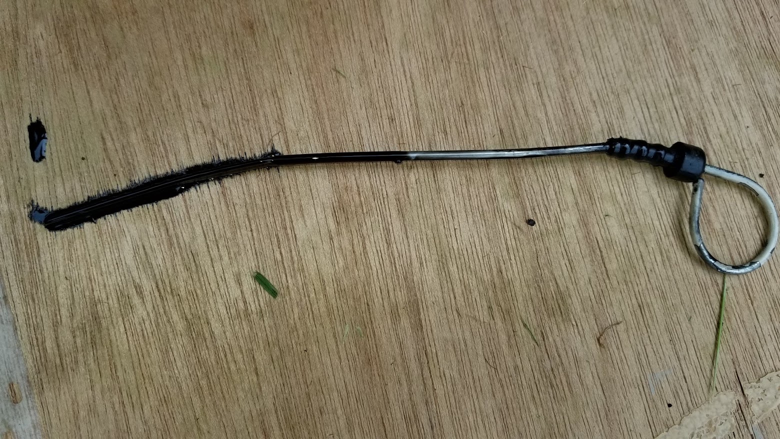

Just got a B20 and doing an oil change before putting hours on it. Drained the oil, surprising little came out, est 1-2 quarts. Specs says 4.1 qt capacity. I changed the filter and added 4 quarts. I started the engine, let idle, then checked the oil level. It is very overfilled according to the dipstick, like twice as much as it should have. I am not sure what to do.
First I double-checked that I drained from the correct spot and yes, from the bottom of the oil pan. The pan seems small. Not sure if I should drain and re-fill according to the dipstick or just call it good with 4 quarts.
Advice??

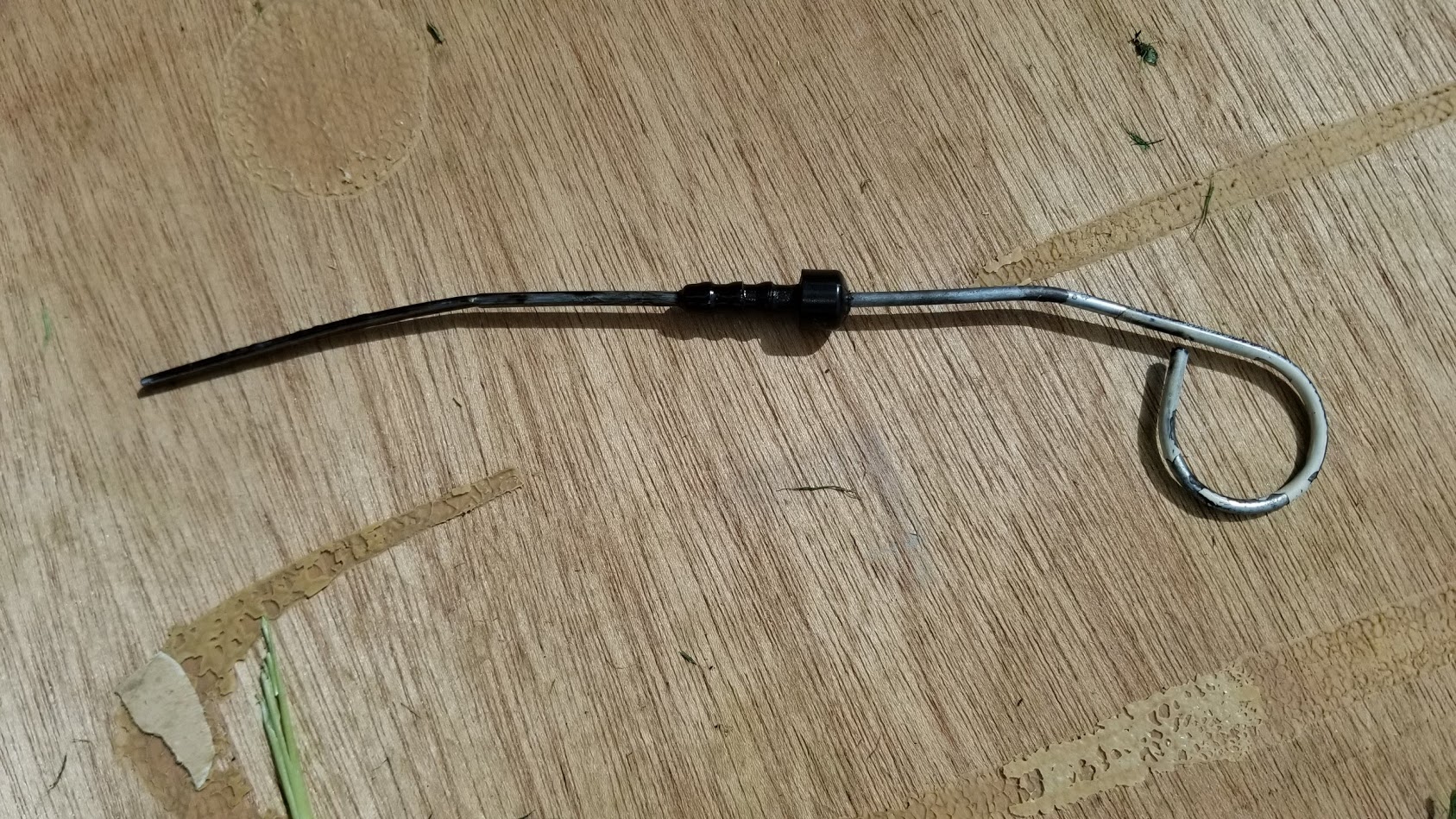

   / Kubota B20 - Engine oil overfilled? Yikes!!
Ok, looks the dipstick stopper had slid to the top of the dipstick.
Now I can adjust it and get an accurate reading.
I am sure it was running very low on oil for a long time, hopefully no harm done
I measured the oil it had been running on, just 24 oz. Less than one quart
