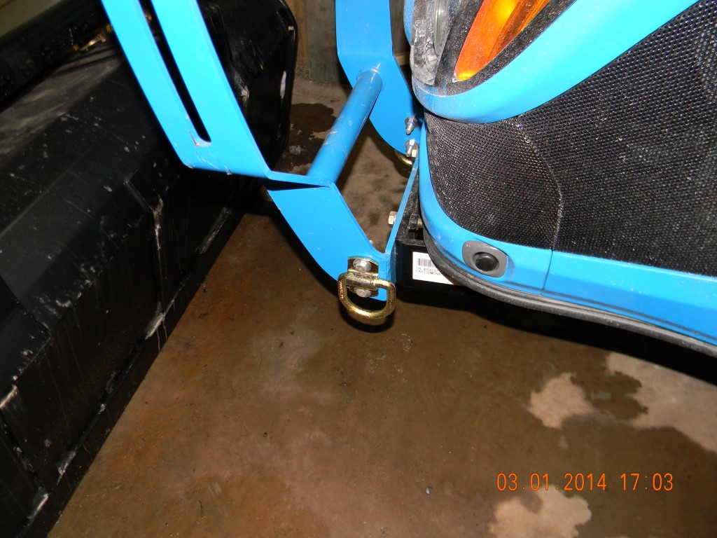

Do you have room to drill and bolt on some D rings. That's what I added for tie downs.
