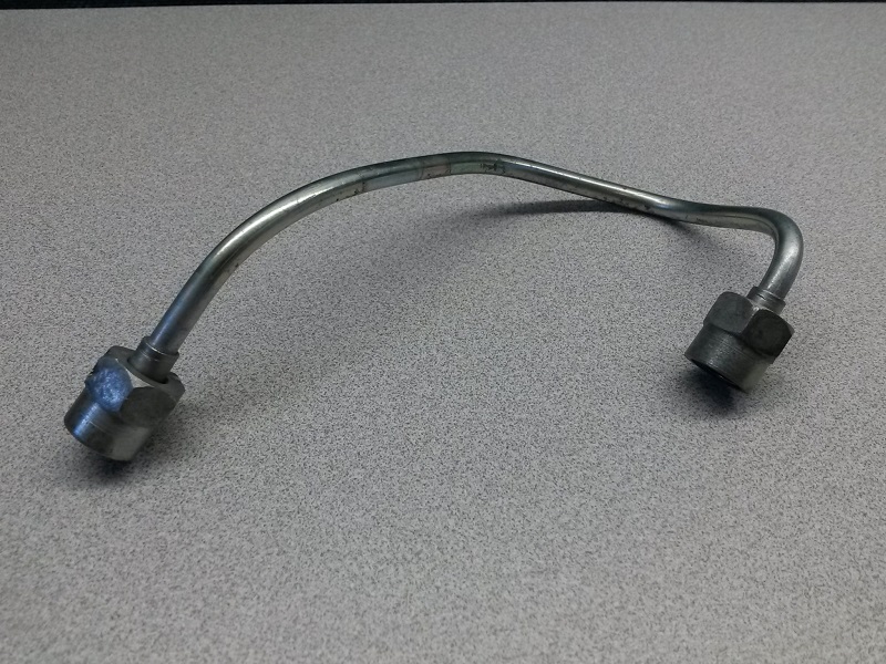

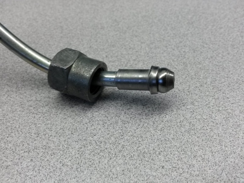

Injector 2 hard line cleaned up:
Closeup of hard line end:

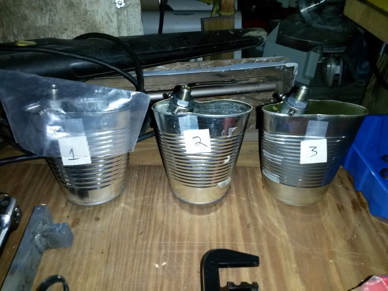

Tested injectors 2 and 3 tonight. 2 had good pop pressure (~2000 psi), but the spray was a little more "streamy" than injector 1, which was nice and misty. 3 was the worst of the bunch, initially popping at 2800 psi a few times and then popping a good bit lower than 2000 psi. The spray was very streamy and erratic with regard to shape and direction. I'm going to re-clean/re-build 2 and 3 and test again. I did come up with a good way to store the injectors upright - pinched the mouths of some steel cans and let the return barbs rest on the rim like little arms. Figured this would help keep air out of the injector and subsequently out of the fuel system when I reinstall.

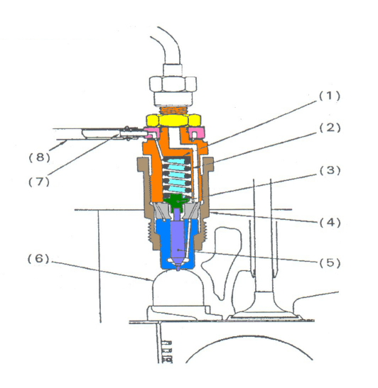

Got injector 3 re-cleaned and rebuilt. Spray is much better now. Pop pressure was around 2100 psi, which is on the higher end of the specified range. I made sure everything was well-aligned, especially where the butt end of the nozzle needle fits into the spring plate. Here's the assembly process I used (after cleaning the parts in the ultrasonic, rinsing with clean water, and spraying healthily with WD-40 while holding in clean nitrile gloves):
1. Stack shims on top of spring.
2. Insert shim/spring stack into upper housing (orange), held right-side-up.
3. Flip over; place spring plate (green) on bottom end of spring.
4. Place spacer (gray) over that.
5. Place needle (purple) and nozzle body (darker blue) assembly on top, with butt end of needle in recess of spring plate.
6. Hold all of the above in alignment with one hand while installing lower housing (brown) over top with other hand.
