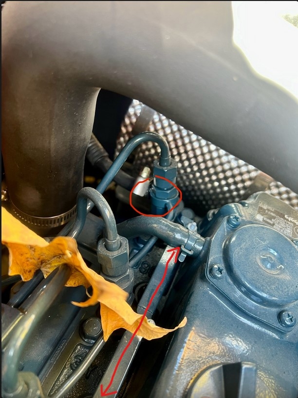

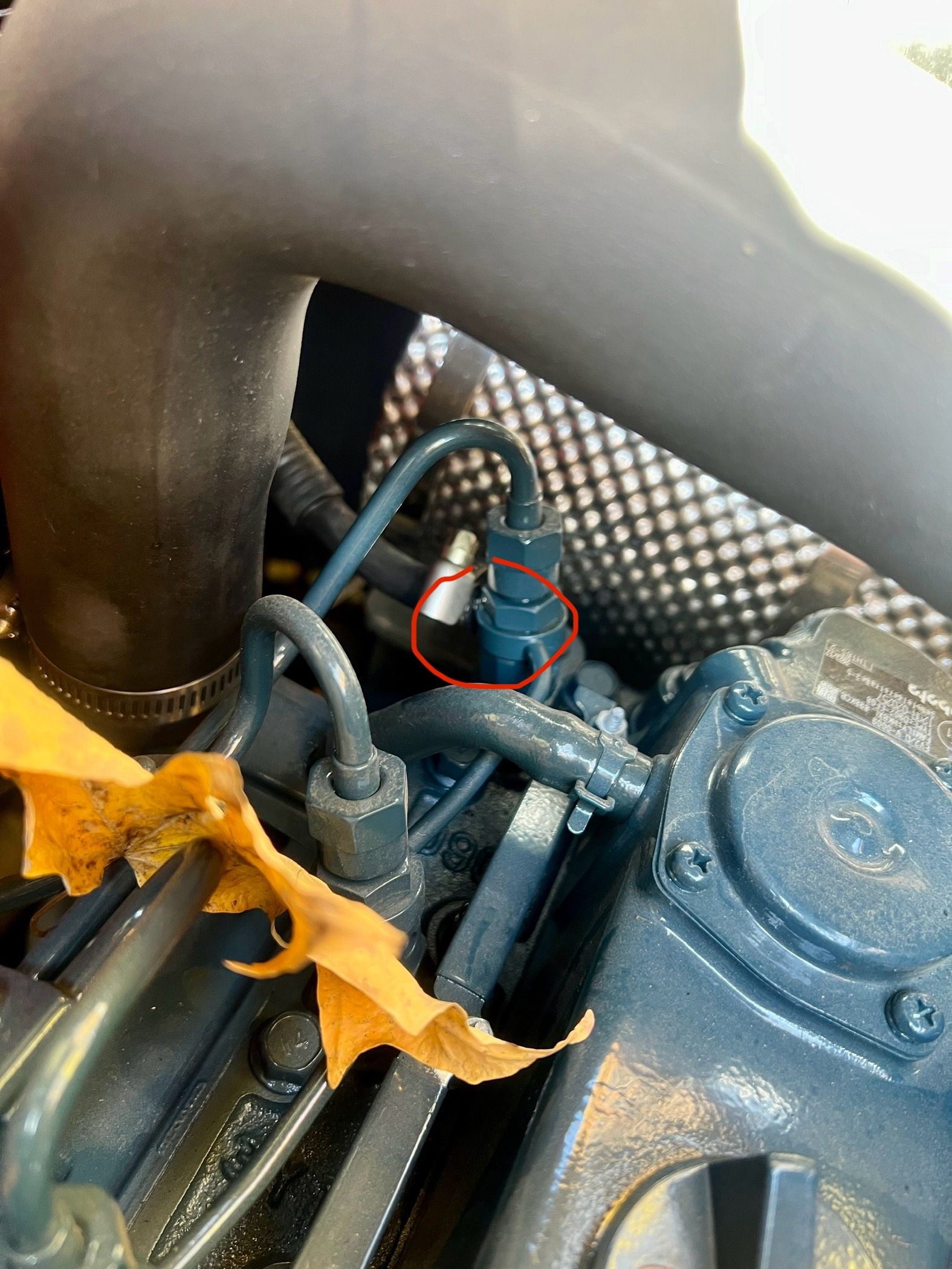

One other thing I noticed when I was running the glow plugs was a bit of a fuel leak right here. It wasn't clear if it was on the rubber hose side or the injector. I don't know if that's the cause of my problems but I'm assuming it's not supposed to do that....
   / Kubota 902 engine, can’t start in cold (Edit: Probably not a "cold" problem) #10
Your red circle is fuel return from the injector. On my example is where the glow plug wires are hidden beneath.
