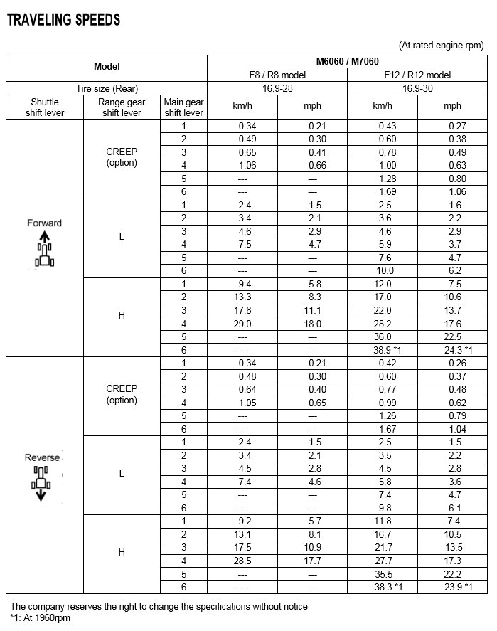

Here’s the ground speed chart linked from another thread
https://www.tractorbynet.com/forums/kubota-owning-operating/401235-m7060-ground-speed.html
/ Kubota 7060 question #31
so from the chart we get 18mph for the 8x8 and 24.3 mph at 1960rpm for the 12x12 I wonder what happens past 1960 rpm.
/ Kubota 7060 question #32
It won’t go past 1960 rpm in 6th gear, there’s an idiot box hooked up that limits the rpm.
Annnd, for what it’s worth, legally (here anyway) 40kph is the max speed permitted on road for a slow moving vehicle.
/ Kubota 7060 question #33
Thats interesting. so if you set the hand throttle above 1960 and put it in 6th gear High range once you get to 24.3 mph the computer will reduce the rpm. Man, tractors are getting more and more complex.
