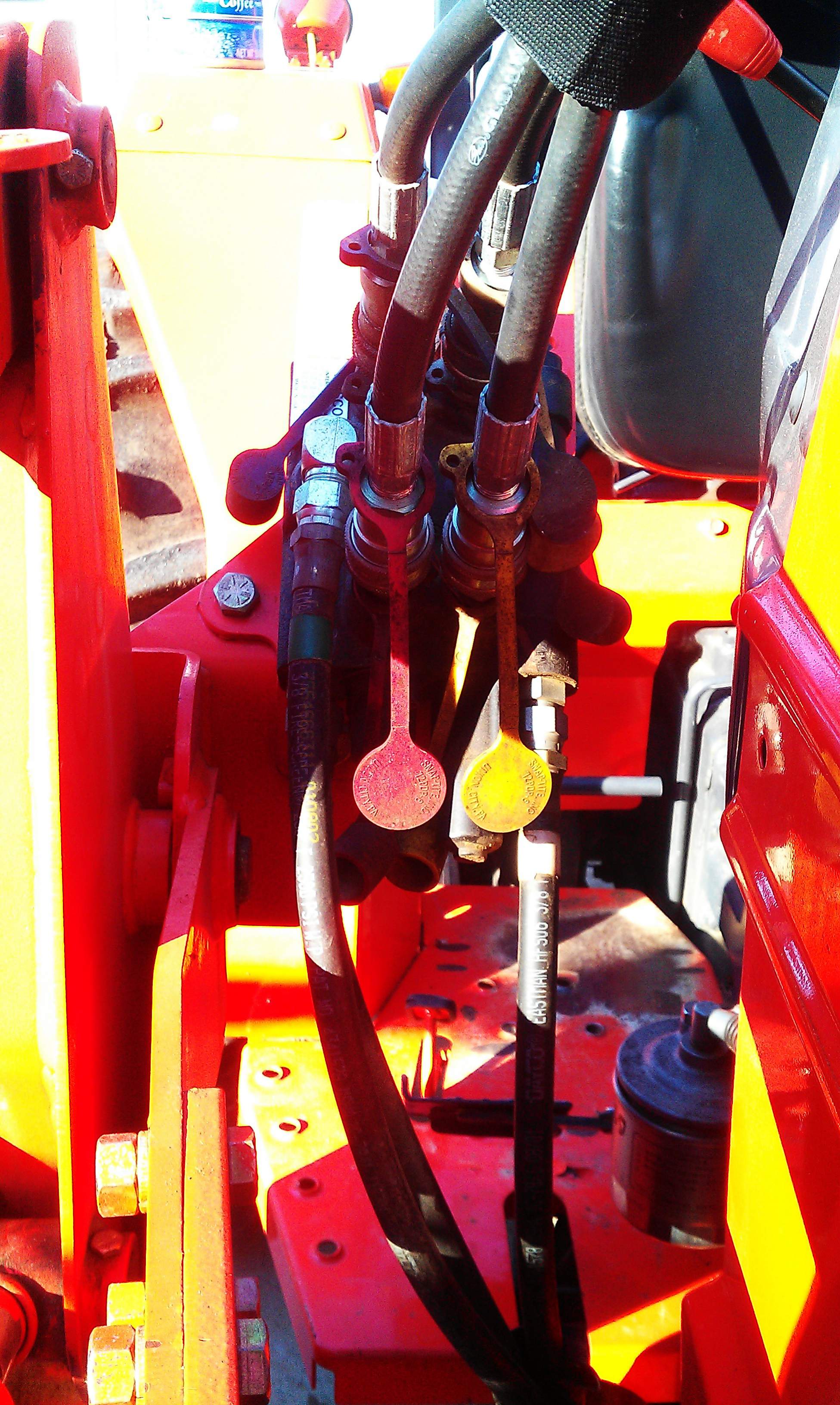

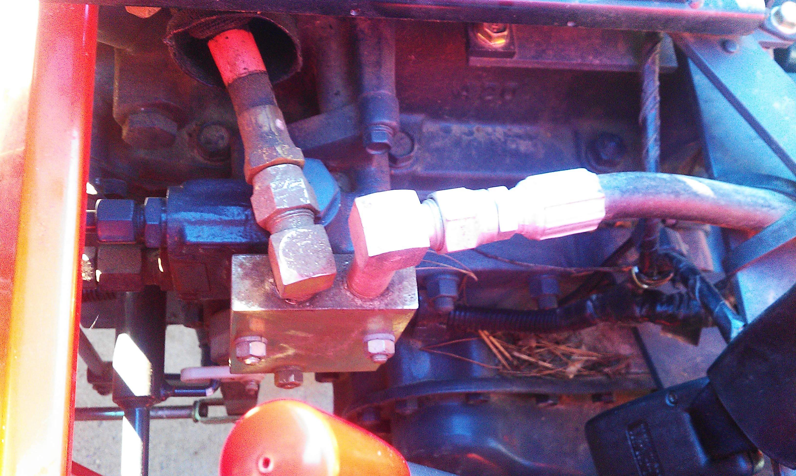

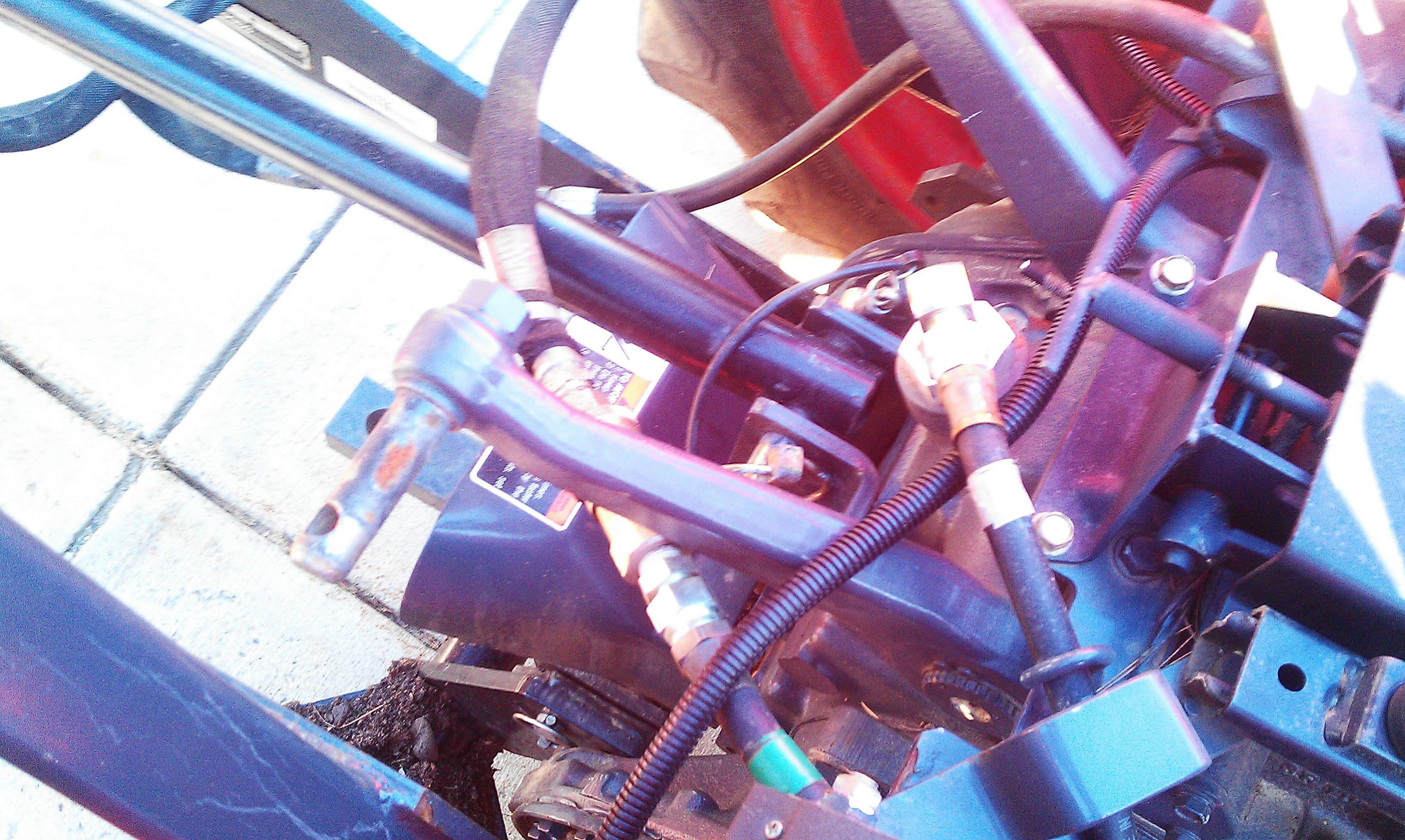

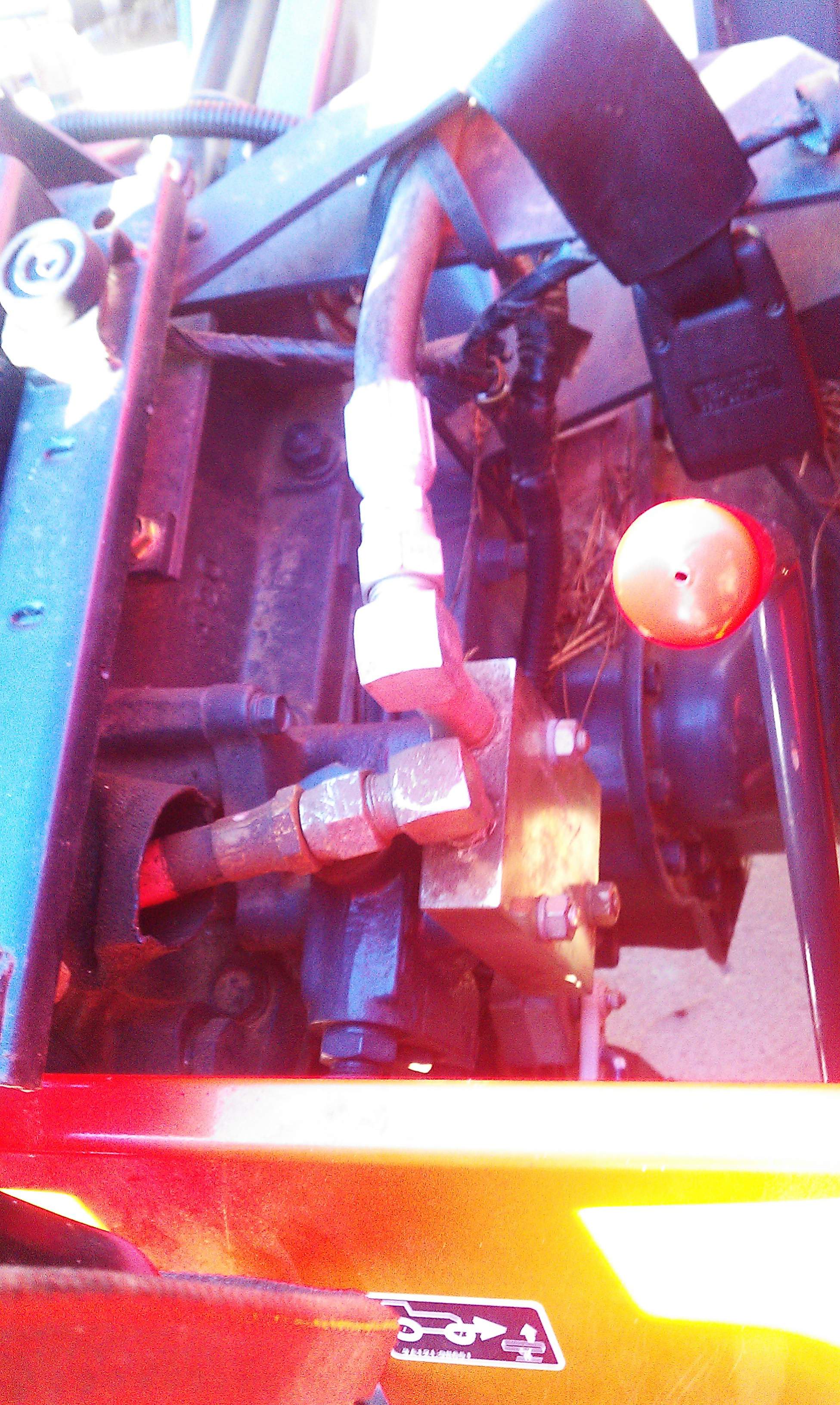

My tractor has a factory FEL. The power beyond (green tape) goes out back to supply my Woods backhoe. There is a block on the left side under the seat that appears to supply the FEL valve (orange tape) and a return hose from the BH. Additionally there is a hose going from the "out" on FEL valve to the back of the tractor between the TPH arms (grey tape). Is the hose with the gray tape dumping into the tank or is that for my TPH?

I will try to attach a few pictures of my setup:

Since you have a BH pressure source, you can use that to plug into the new valve and the PB out of the new valve will go to the 3pt.
Are you using a jumper hose when you disconnect the BH?
I believe in general use, the male QD is the pressure or supply hose.
Do you have PB on the BH valve?

Is my 3ph externally plumbed? Is that the hose with gray tape that goes in the back of the of tractor? Shown in picture 3
My backhoe hoses simply connect together when BH is removed.

Your 3pt is probably plumbed through the hyd block.

The BH only has 2 hoses and I could not find power beyond on BH valve
The system appears to be configured as follows;
There is a brass colored block that is attached over the top of a block with lines going to power steering. The line from that block goes directly to the FEL in port. From the FEL power beyond port a hose goes to the backhoe. The return hose from the backhoe goes back to that brass colored block. A third hose comes out of the "out" port on FEL valve and goes into the back of the tractor between the lift arms for the 3ph. Is this last hose power for the 3ph?

The pressure line from the hyd block goes to a port under the seat.
The only problem I can see with the BH valve is the back pressure on the OUT port of the valve.
Most OUT ports will only take about 500 psi, and there in poses a risk when installed in series with a 3000 psi system.
Since the BH valve has been used this way for a while, the source for the remotes should come off the PB from the FEL valve.
I would just insert the new valve into the PB from the FEL and put a QD on the PB port, and plug in the BH.
The hyd block will feed the 3pt.
The OUT line from the FEL will go to the back probably in the side of the tractor.

Thanks JJ for that link. I ordered the service manual, but it hasn't arrived yet. After looking at the messicks pages I now see how it is laid out. Without a great knowledge of tractor hydraulics I assumed the pump was inside the rear case, not powered from the engine as it is.
Is it a big problem that the BH only has 2 hoses? The return line goes into that brass block where the FEL in powered from.
There is a hose from the "out" on the FEL that goes into the back of the rear case where messicks diagram shows a fill/vent plug. Is this the tank dump? Is that where I should tee in the "out" from the new valve. Additionally, Is that a good place to install a true filter set up?
