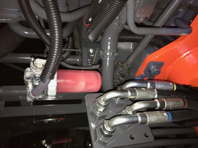

You could see the separator in this next pic all cloudy. So I figured this was likely the issue.

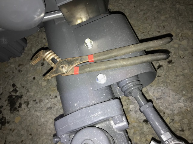

Took the separator housing off with a pair of adjustable wrench pliers to break it loose. It was a tight fit and I had to turn the pliers backwards from how you would normally use them to get in there. Not sure if they make an actual wrench for removing these, but the pliers is what I had and I've used them on other tractors in the past for those large nut rings on the separators/filters.

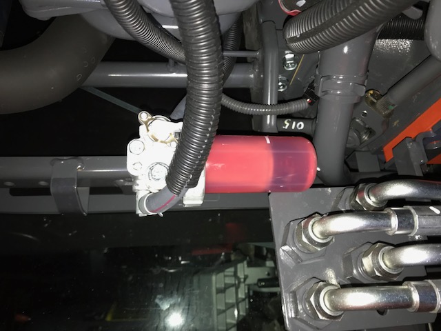

Once I got it installed, I opened the bleeder on the top of the fuel filter but I never got any fuel coming out of this even after I remembered to open the fuel valve (dulh, I was really ticked at myself for that). So, I tried turning the key over twice to watch for fuel there, didn't get anything, so I tightened the bleeder and tried to start. It did start (the second time after turning the fuel back on) and then ran for about a couple minutes until I noticed the separator filling up with gel again. I didn't catch it in time and it shut off again.
So, I put the heat gun to it (far away, like where the loader frame was, probably 18", I was a little chicken to get it too hot) and let it thaw the gel. I then started it and rocked the tractor back and forth to get the treatment distributed through the tank. Then I had the gun on the separator for about 5 minutes while the tractor ran and that kept it from geling up at low idle enough to get the treatment into the lines.
This is what it looked like when it started to gel up again:

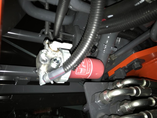

And here it is all the way clear:
