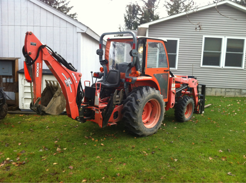

   / Kubot 3130 or NH TC33D adequate? #13
Just a pic of the L3130
