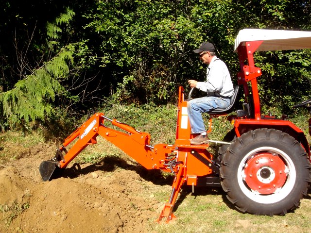

We sell the LITW korean backhoes, 300 % better quality than the chinese backhoe, JIC fittings, USA hoses,Swedish valves, Powder coated paint.They have there own tank and PTO pump,they also make a sub-frame that you could modify for your tractor.Very nice units
Tommy
Affordable Tractor Sales
Bellville,Texas
AFFORDABLE TRACTORS
