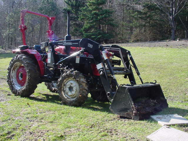

This picture might help, its not anything to do with side to side anything. Just when the bucket is level with the ground for scooping dirt, and its to hard to gage the top part of the bucket even though I know its level with the bottom of the FEL.

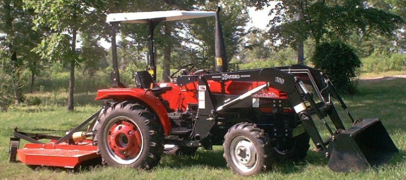

You have the idea right. Just a rod poking through a hollow tube. Fasten the end of the rod to the linkage between the lower and upper connectors to the bucket (see white line on attached pic from your loader). The hollow tube is at the upper end, and fastened to the loader arm below the upper pivot point and the lower point. The rod moves within the hollow tube as the bucket moves.

I have a Koyker 160 and I do the same thing. After using it you get used to keeping the top of the bucket parallel with the ground by eye balling the the top plate of the loader. When I try to scoop gravel dirt etc. I curl the bucket down and with down pressure listen to the tractor motor and as the motor starts loading up I curl the bucket slowly as it starts filling with whatever I'm trying to fill it with.
