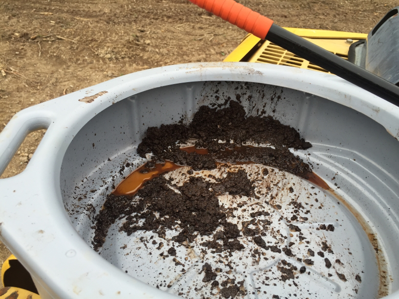

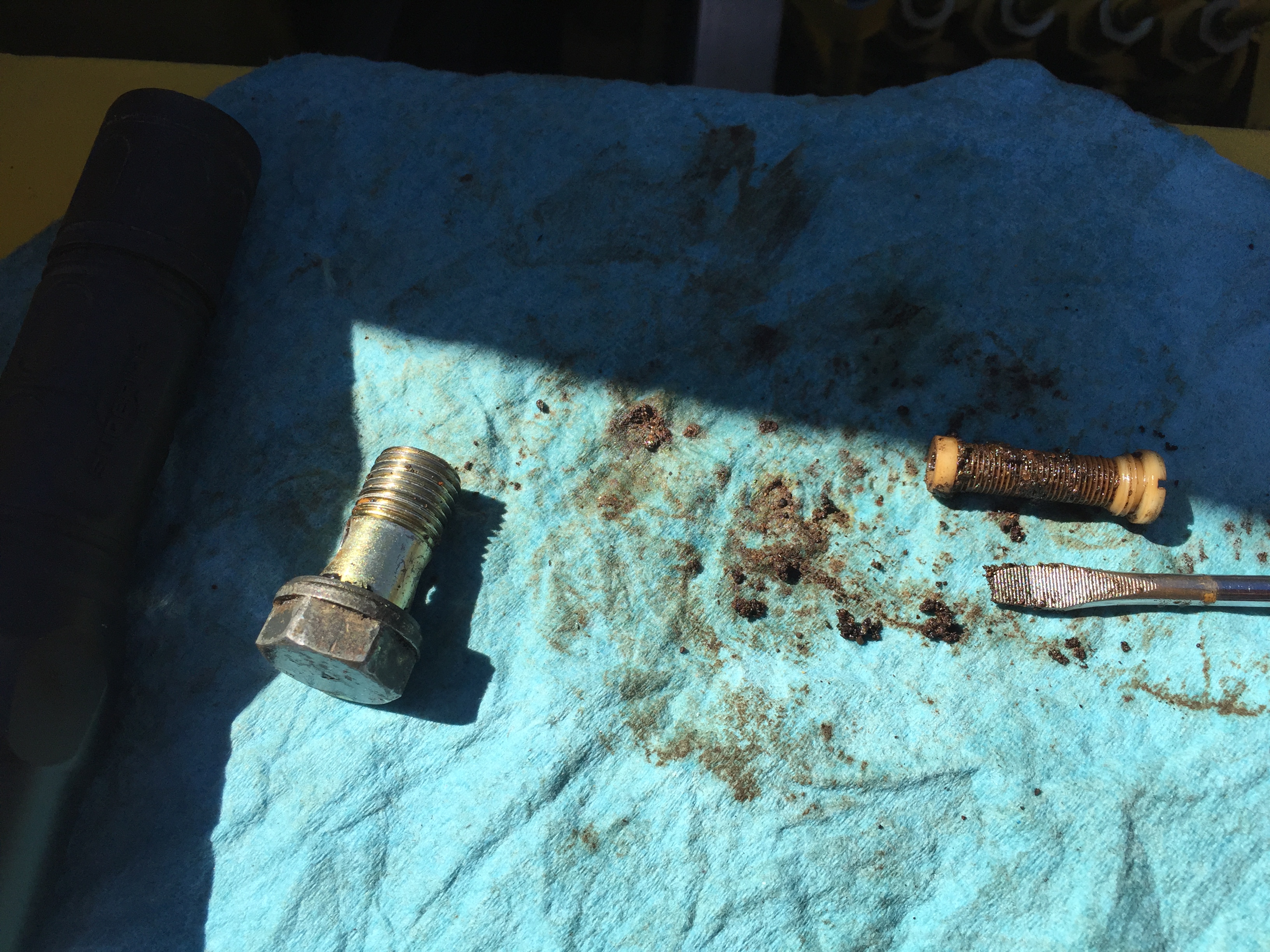

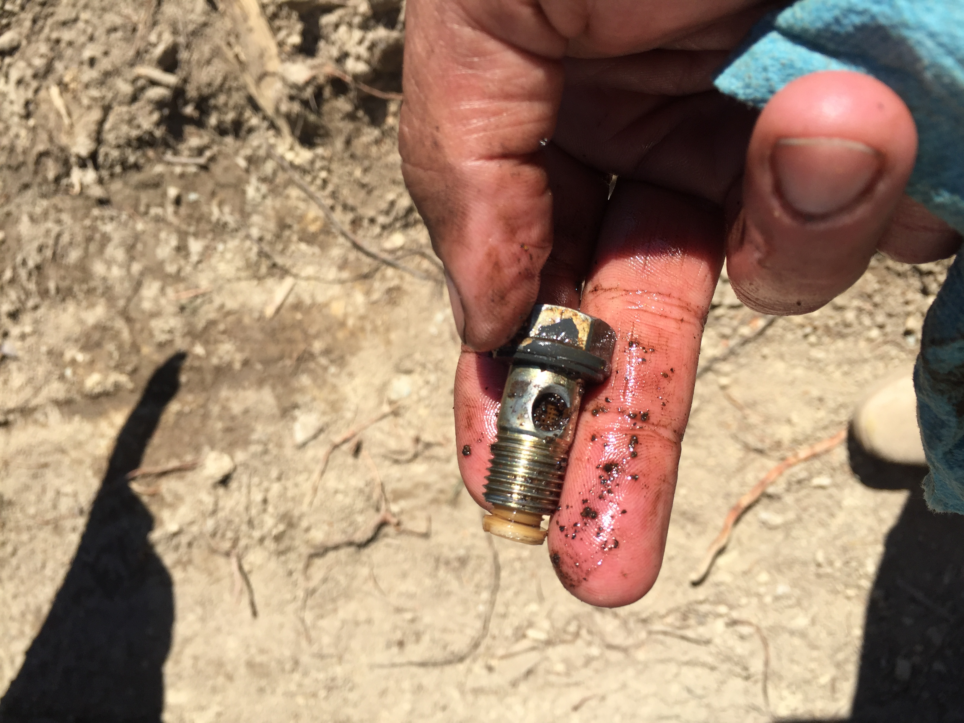

EddieWalker, you are a wonderful human being. It was the Banjo Bolt strainer. As soon as I got it loose and started to unscrew it, my hand was filled with gritty crud and I knew it was going to work. I took out the screen, which did not want to budge because of all the grit, cleaned the banjo bolt, screen and the elbow that attaches to it with carb cleaner. I then blew out the hole the bolt goes into, with compressed air. put it all back together, primed it, and started up Let it idle for almost 4 minutes then reved it up and started digging. Took out a big stump then started moving so small logs....when 10 minutes had passed, I went after a large oak tree top. I ran it for an hour then stopeed to fuel up again. IT ran well all day....I stopped working at 8:15 when I could not longer see. I did notice that the inline filter is already dark and has grit in the bottom of it. I will swap that out tomorrow and start looking for a better filter....one with a valve in the bottom of it.

hi, i run a komatsu pc130-8 have same fuel supply issue, engine bogging down where is this strainer bolt located?
/ Komatsu PC130
#89
Sorry, I just saw this. It is located near the manual fuel pump that you would use to prime the engine if you ran out of fuel.
