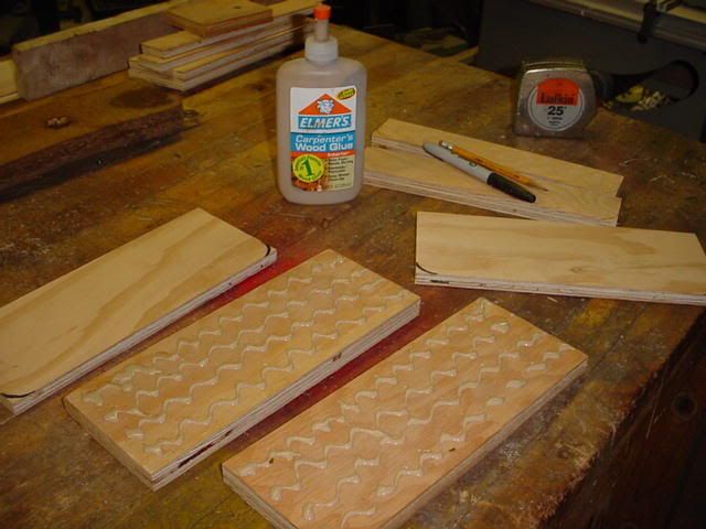

With the cutting & gluing done it was time to bore out some holes for new "T" nuts that will hold the mount bracket:
Then bore out a smaller through hole for the bolt:
Then using a bolt, set the "T" nut spikes down into the wood:
Test fit the mounting bracket onto new wood arm rest base:
Larry
