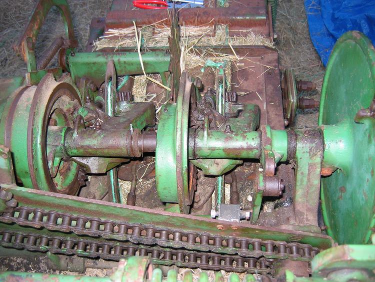

I can clearly see that the billhooks are out of position when they terminate. (see attached photo) Question is why ? Looks like they are one tooth off relative to the intermittent gear start position.
1) Knotter drive shaft is bent (caused by a previous STB).
2) The keyway in the knotter drive is chipped / key is worn or broken, causing the phase delay. Can you grab the intermittent gears and rotate them by hand so they are back to being in a similar position relative to each other?
3) Is the knotter frame mounting bracket bent? A rear view of bothe knotters ought to show if ther is a frame mispositioned.
4) Is there a tooth broken off from the intermittent gear, thus starting the billhook rotation late?
5) Is the knotter drive stop detent mispositioned so that the intermittent gears are not returning to home postion properly? You can check this in #2 by rotating them back to Home position by hand.
6) is there a pin in the billhook to drive gear broken or missing? This suggests that the billhook position is out relative to the drive gear.
I'll see if I can get you some pix of mine later today....

So the driveshaft & knotter frame don't seem to be bent... nor are there any missing teeth on the gears. Both keys are present and the gears don't spin on the shaft, so i guess there's only two options left: shaft is twisted but still straight (wouldn't i be able to see that?) or one intermittent gear was replaced by a newer/older one whose keyhole is slightly offset from the other?? Neither prosect is very appealing to me right now, since jdparts lists the intermittent gears at ~$360 and $500!! :( :mad:
I noticed that the inboard end of the hay flake was sticking out more than the outer (working side) one, so i tightened up the twine tension a bit and it seems to have helped... the one time I tripped the knotter it actually tied a knot, but then the twine got twisted around the billhook! marginally close i suppose, but no where near useable yet! eesh....
I am assuming that if I take the knotter shaft off, all the square key notches should line up, and if they do i guess i start looking for a dead 14T for "new" gears?? My (limited) understanding of the whole mechanism seems to have ruled out anything else that could cause the billhooks to be out of sync with eachother? Or maybe there's something else I could do to compensate somehow for this? (the problematic billhook is running 'ahead' of the working one...)
Thanks again!
DD
/ knotting problems with JD 14T baler #10
There may still be another option that can get you going: The intermittent drive gear is positioned by the bracket that locates it relative to the bale case deck. Put some washers under it to advance it forward in time/rotation. Too much advance will cause some hardship for the billhook tongue to open in time, but what the heck. You can also slow the other gear down to match them. I still think a picture of a rear view of the knotter action during key motions is the answer.
Also, you can reset the timing of the "late" gear by removing the key altogether and putting in a set screw with pointed tip and a drilled crater in the shaft. The knotter won't know what happened. Or, drill a hold in the gear and shaft and stuff a pin into it. WTF ....

by view of the rear, you mean like this?
http://www.dearaujo.net/pics/14T/IMG_6654.JPG
http://www.dearaujo.net/pics/14T/IMG_6664.JPG
I suppose a video would be ideal if I can get the right perspective...
Moving the position of the knotter is a great idea, thanks! never occurred to me that it's just as movable as anything else; guess i just needed a different perspective on things! I suppose this old equipment sometimes needs a new way of thinking... :D

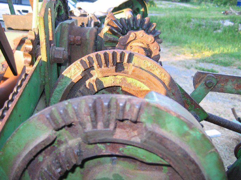

Have still not seen a view from the rear of the knotter frame. I want to see the home position of the intermitent gears, the positions of the cotter pins (to see if they line up), the angles of the billhooks and the look of the billhooks when the billhook finger opens.
What I was thinking is that perhaps what happened is that the billhook drive gear is off by 1 tooth. This means pushing out the roll pin, advancing or retarding the gear, and reassembling. That would explain why the billhook rotations are not the same at knot release....

hahaha, i'm sorry, I didn't notice I copied/pasted the link wrong...
Try this one:
http://www.dearaujo.net/pics/14T/IMG_6663.JPG
and here's the home position of the intermittent gears:
http://www.dearaujo.net/pics/14T/IMG_6652.JPG
Which to me seems like the inboard one is 1 tooth ahead.
I had a close look on the weekend and it looks like the previous owner was somewhat aware of the problem since the inboard needle is also a bit advanced. But this has now turned into a fall/winter project, since I was *finally* able to get it working on saturday! :D As per your suggestion, I put a spacer between the knotter and the little bracket that it bolts onto to delay the engagement of the knotter a little. It is still advanced now even tho I put a decent-sized nut in as a spacer, but it is close enough that the twine gets into position just as the billhook starts to turn! Can't move it any further since the needle is cutting it pretty close to the twine disks at this point... Made 15 bales without missing one so i'm hoping that is a good sign :)
I think the long term solution is to re-align the gear by putting a set-screw or something similar to turn the intermittent gear back far enough to get everything syncronized again.
