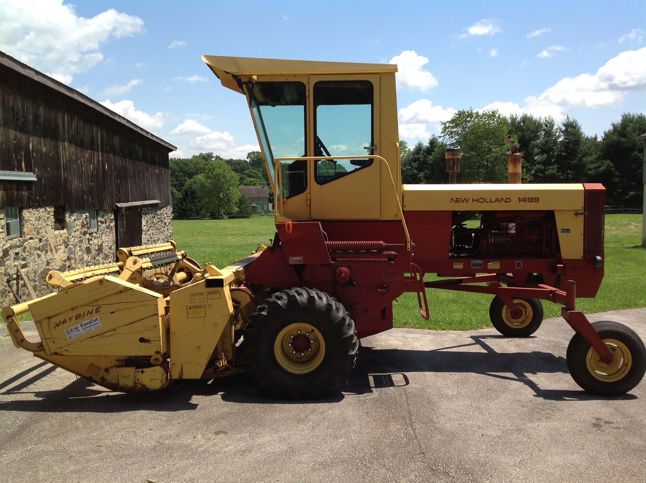

Do they work with haybines? If they do, wish I’d known about them when I was running my 1499.
