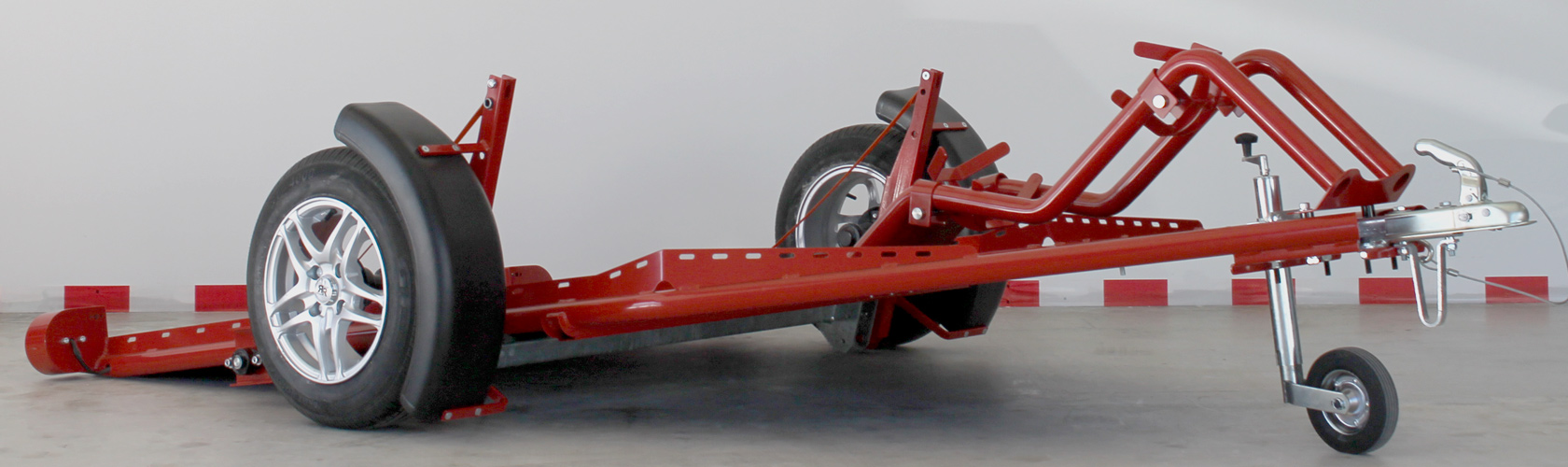

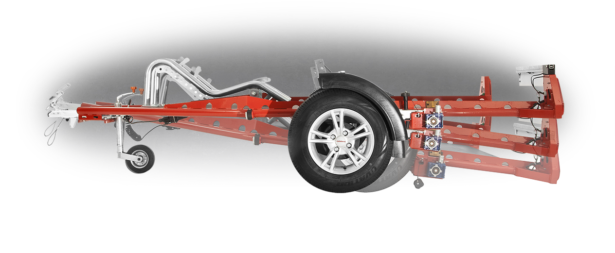

It's fairly straightforward if the width of the bed is less than 76" (low boy gooseneck). Drop deck trailers are available.
Safely load a motorcycle onto a trailer - Drop-deck, non-tilting trailers by Airtow - YouTube
You could modify this design for your use.
If your gooseneck is full legal width (102"), then a tilt bed is you best option.
