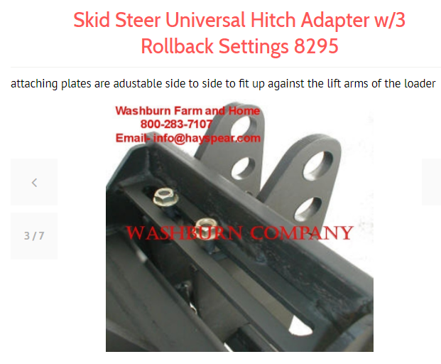

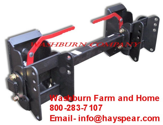

Have you seen this company? Skid Steer Quick Hitch Adapters
Call them, this one might work:
   / KMW ML260 quick attach system - needing info
No, Have not seen that company. Looks like the ticket for bolt on vs weld on. I will have to call tomorrow to get a weight estimate as I can't find it on their site. Would like to compare it to the Titan weight wise.
