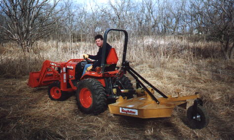

Tres, I got the holes bored out and the new lift pins put in on the KK 48" brush hog. Whew, those holes took a little longer to do than I thought they would/w3tcompact/icons/tongue.gif. You were right, I can now lift the hog way up in the air. Big improvement.... I did however have a problem with the swivel yoke that is located on the top of the hog where the top link attaches. When lowering the hog the yoke would cam over and lock much like your elbow locks when your laying on your back and lifting something heavy with your arms fully extended. To get around this I welded a couple of tabs on the yoke to keep it from coming completely down and locking. The hog will now lower all the way without hanging up. Thanks for your advice.....Dan
   / KK new XB implements for the BX
#19
Dan, I think that swivel fitting is supposed to swivel down like that, at least I think it is and it has not interfered with my use on either tractor. I mostly use the cutter on the 2410 but it has been numerous times on the BX which is how I knew the BX could lift it if you relocated the pins. Anyway, I am glad to hear that you are in buisness now, I think having to modify these implements is SOP. Be careful when lifting the cutter that your top link does not smash into the sheetmetal piece that has the top link hook on the back of the tractor (behind the seat).

#20
Dan, here is a pic of my KKK 4 foot hog on the 2410. I think you can see that I lowered my pins and left the original pins in place. Notice that I also turned them in, at least I think you can see that. This pic taken back in the "Dog Park", what we call the little stretch of woods along the beaver creek in the back corner where "the" squirrel lives and a few rabbits and such hang out. J
