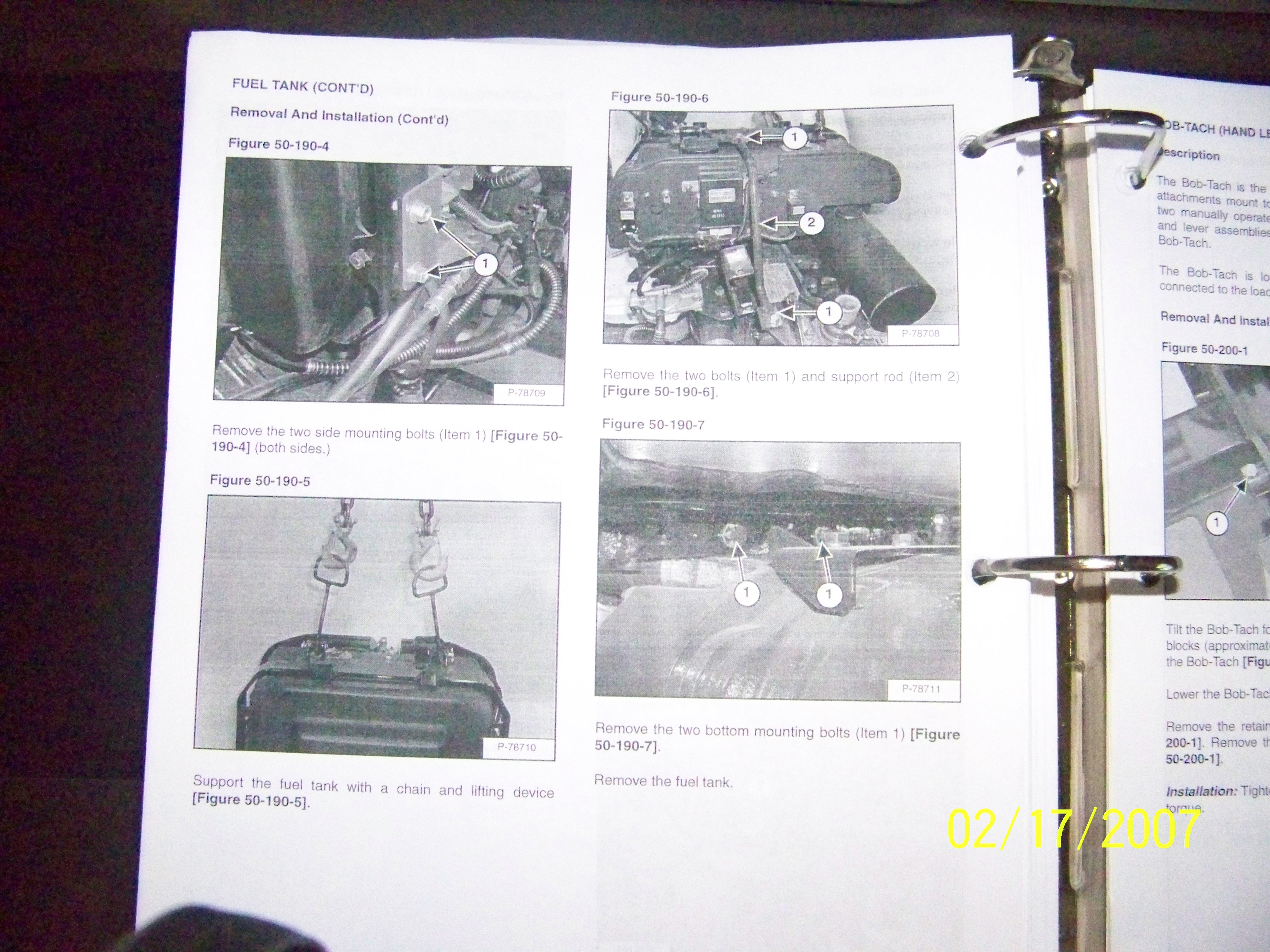

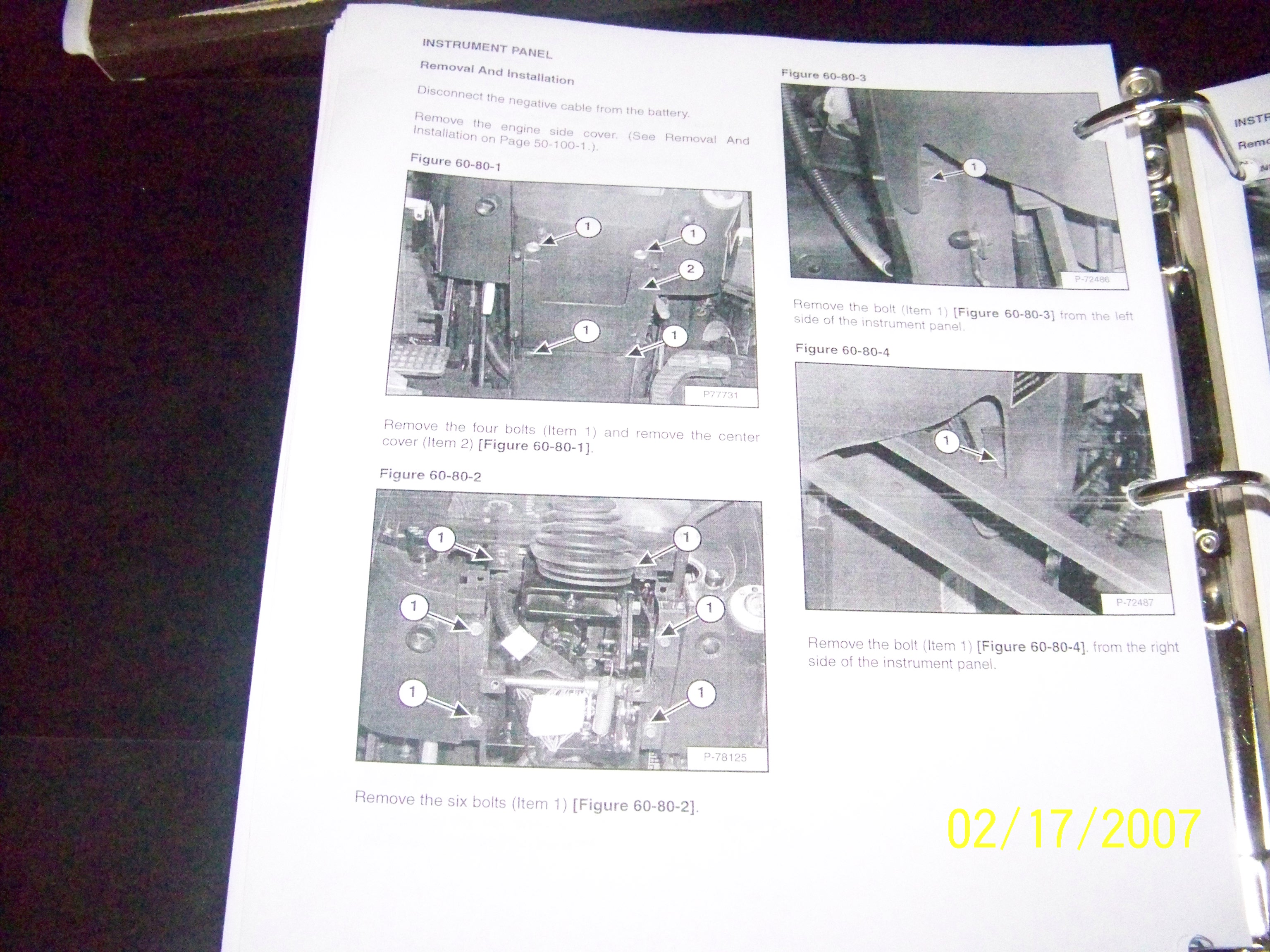

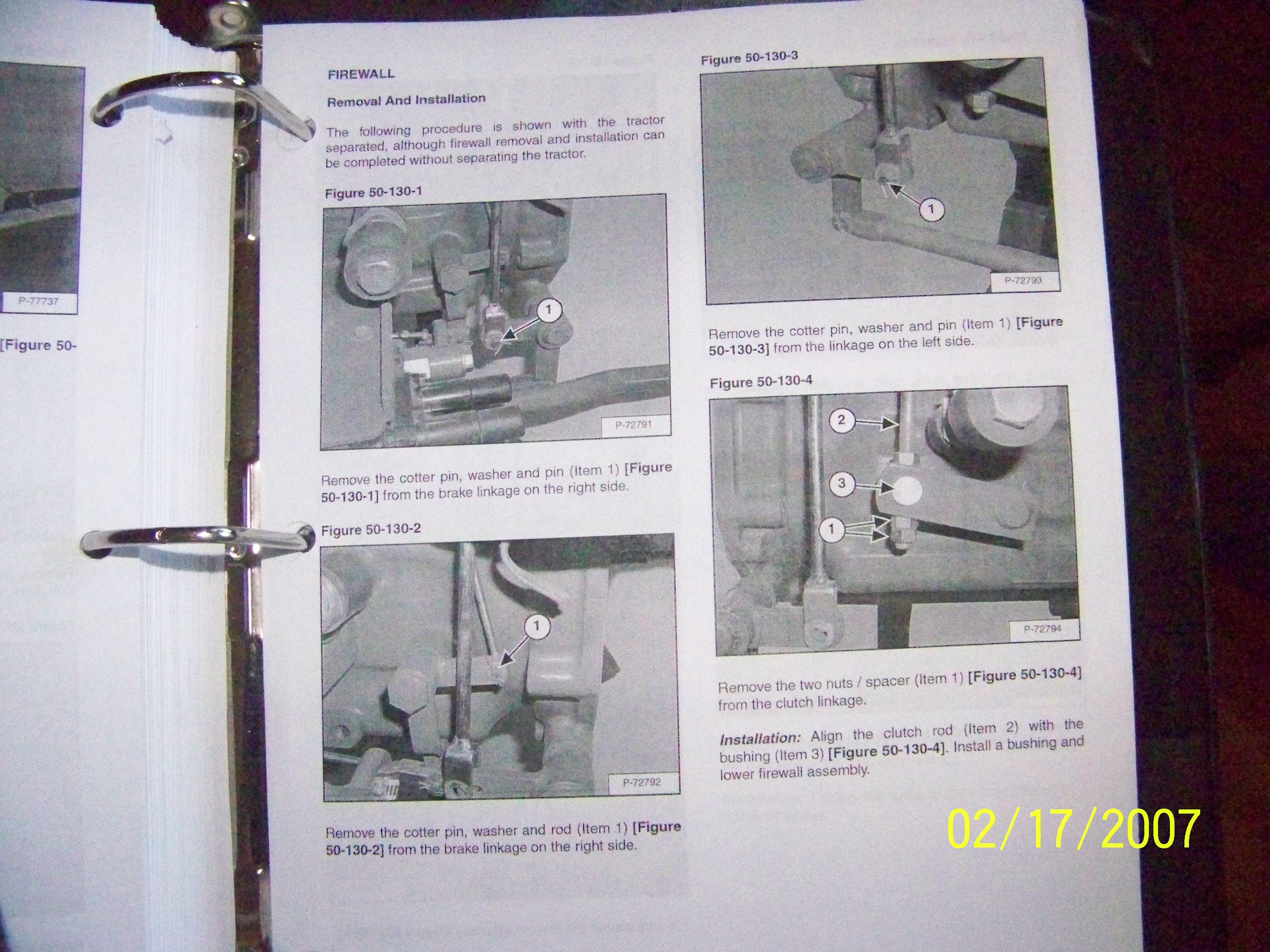

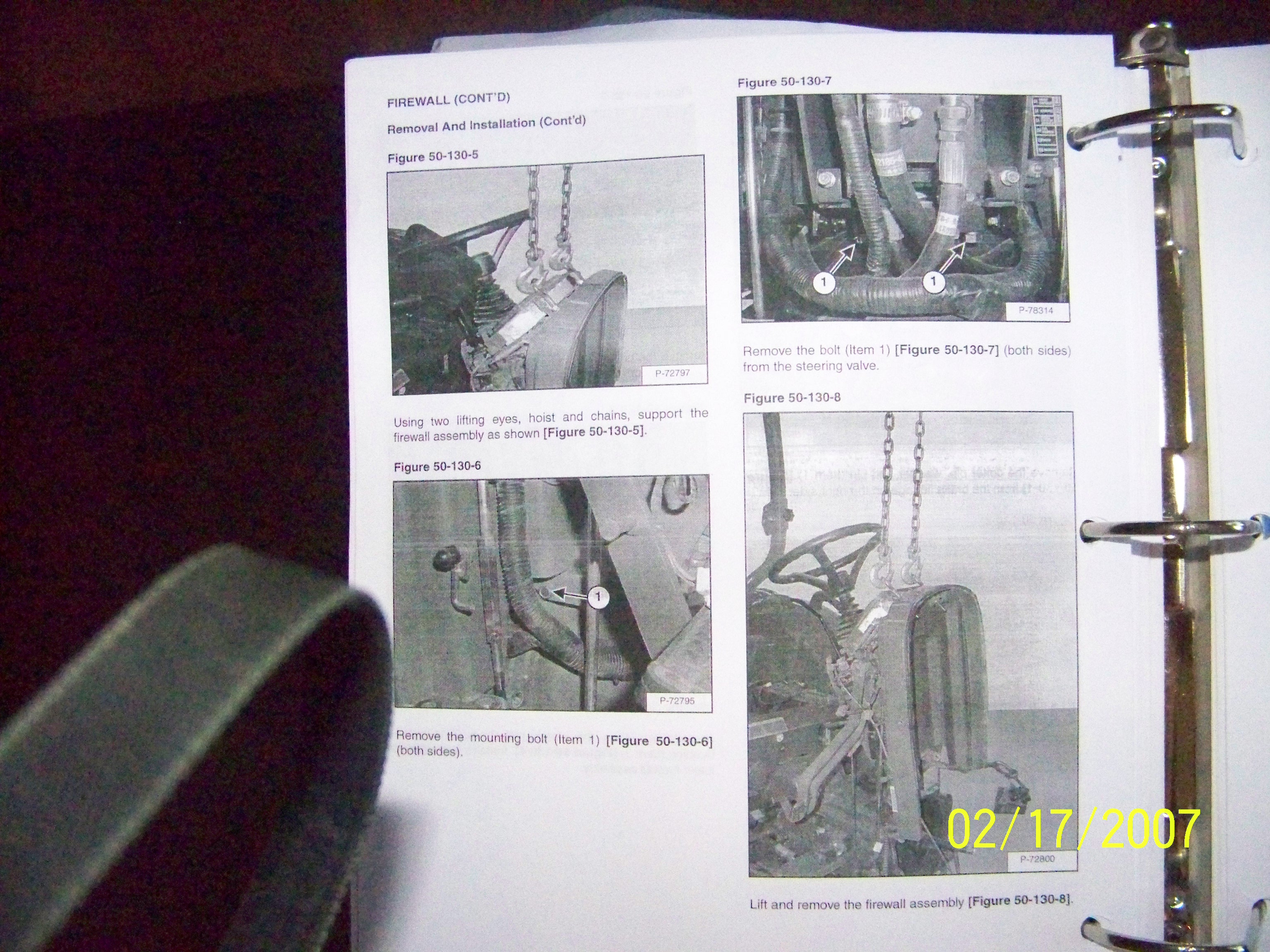

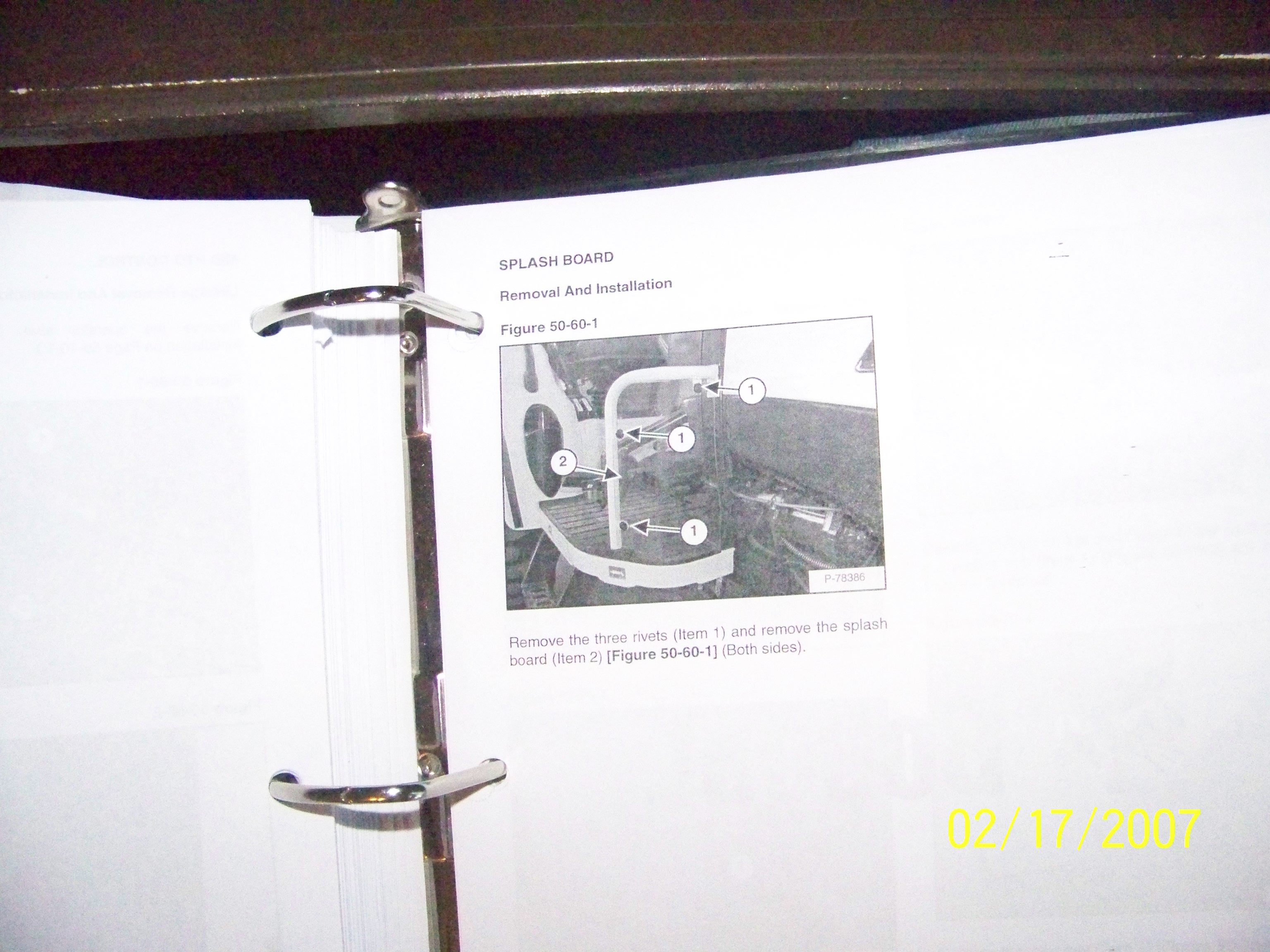

It seems I just bought this downld for $12.00 and it seems very good except there is nothing I can find about dashboard removal or any tools required. I have a fuel leak on my ck35 plastic tank and need to get to it. Any help is appreciated.

I apologize for pictures, lost my scan ability. Out of the Bobcat CT220/CT225/CT235 manual. Thinking it will be very similar to your Kioti.

Thanks so much, looks like a big help. Is the Bobcat the same skid loader people? Called local kioti dealer, said a manual was over $150. You've saved me a lot already. Thanks again. Bill
